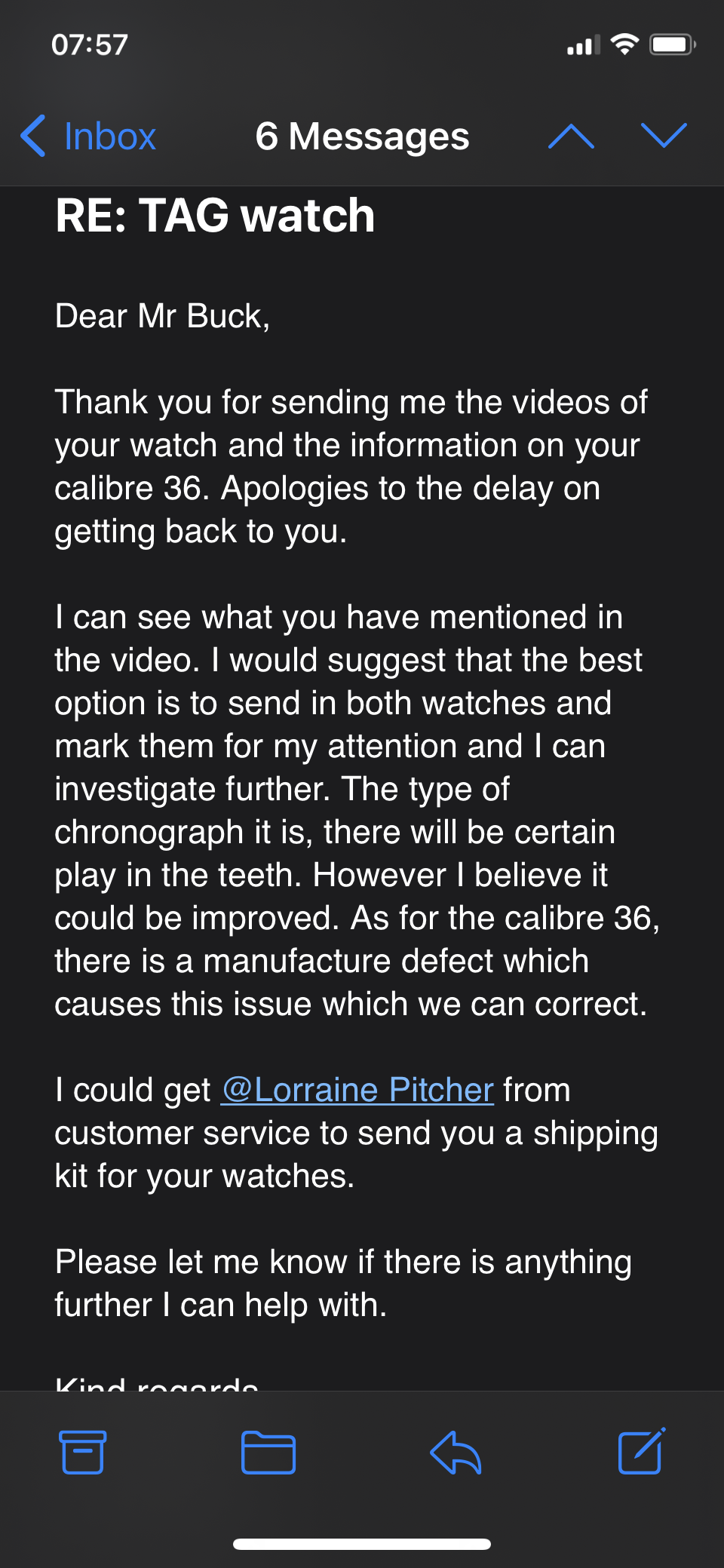

Update on the Monaco cal 11 glitch.
TAG head honcho at the workshop said the sub seconds should not jump when reset. Its not right she said.
I heard it straight from the horses mouth.

(Fob you off culture) Well the customer service lady tried saying it was fine and said they are not making it up they have stripped it down and found nothing wrong with it .
You guys knew what I was talking about when I explained it yet they couldn’t follow my explanation.
Anyway I politely dug my heals in until she said she would get the head of workshop office to contact me.
I sent a video of it to her. A slow motion one and a real time one.
I will let you know her explanation if there is one.
To be continued......
