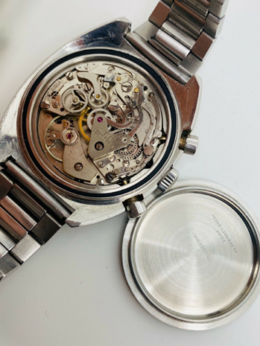

Hello Gents, I just picked up a "Heuer" Leonidas watch from Ebay and wondering if anyone can tell me if this is real. My research shows Heuer and Leonidas did not merge until 1964 and the seller listed this as a 1950's watch. The watch appears more like it's from the 1940's to me. Also, movement is stamped "Leonidas" instead of "Heuer." The dial as been repainted for sure but I'm wondering if this is an authentic Heuer or the logo was just painted on. The logo also doesn't look period correct as Heuer had a different logo in the 50's I believe. If anyone can give me some real honest insight into this, I would very much appreciate it.

Hi Jax.
Yes, I'm afraid that watch definitely predates the Heuer and Leonidas merger. The Leonidas brand was basically totally subsumed in that merger too, the two names didn't share dial space.
I'd say the watch is from the 40s too, the non-waterproof pushers are usually a good indicator for that. Certainly Heuer hadn't used them since the early 50s, long before the merger came to pass. The import code on the movement is for Enicar, rather than either Heuer (AOC) or Leonidas (BCD or CXL).
Mark

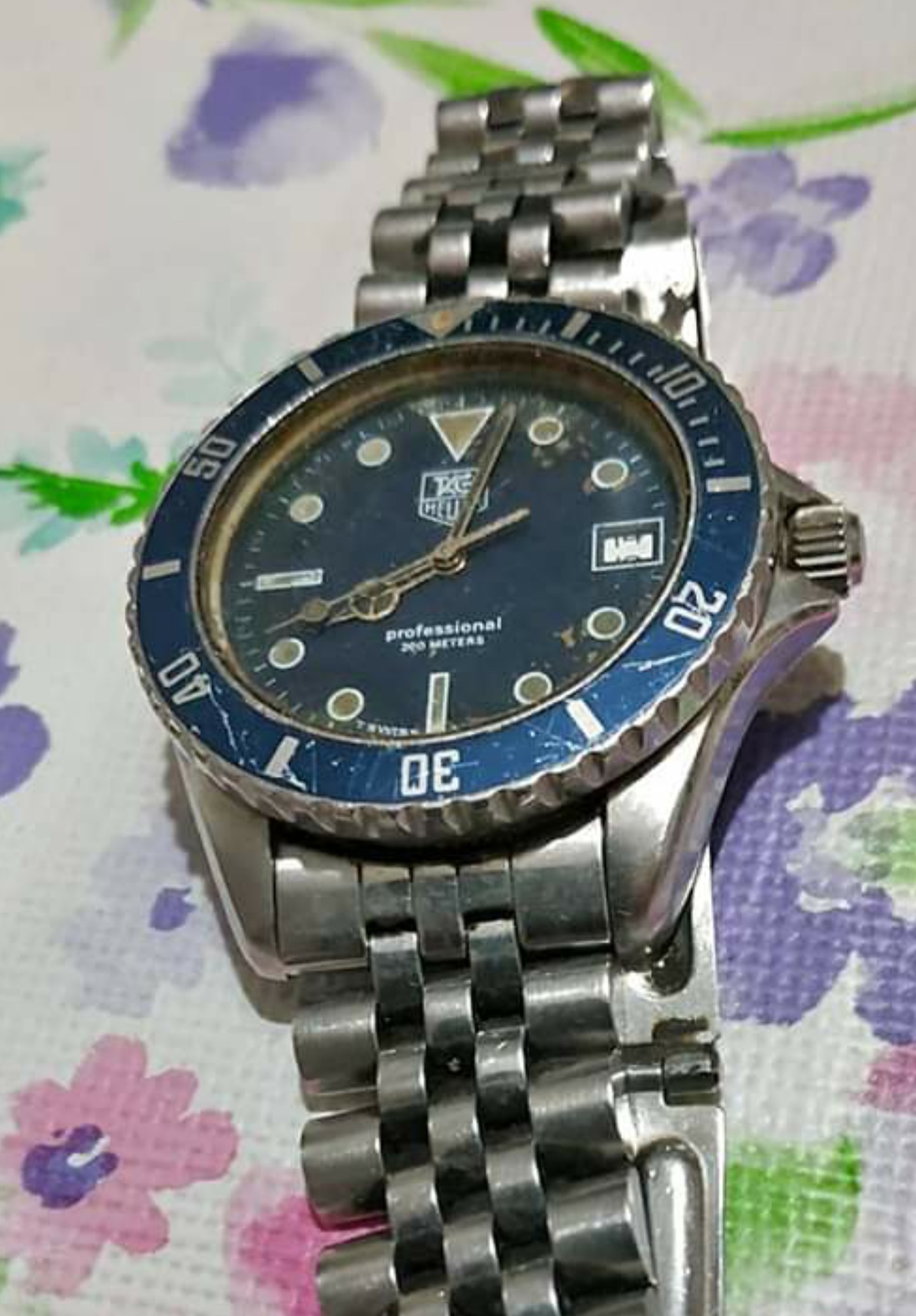

Don't know if I should post this here at Vintage or New. Looking to buy this TAG for 110$. Only have that picture. Justin from Tag1000Diver says it's real, but I'm still skeptical.
Picture isn't the best, but I'd say it's probably real. It's in a bit of a state obviously. The date looks to be in the middle of changing and yet it's only 8pm, so the movement will probably need looking at. Also looks to be evidence of mositure having got into the watch at some point.

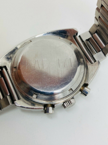

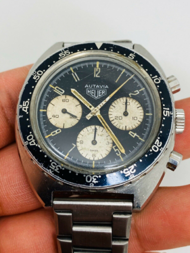

Recently bought a vintage Heuer that seems to have been issued to the Kenyan Air Force, an Autavia ref 73663. Doesn't seem to be in the best shape, seller claims it is 100% original but I've never bought a Heuer before so I'm not sure. It has a Heuer branded bracelet, crown, and a 7736 movement, with 'KAF-171' on the caseback. Can anyone attest to the authenticity?

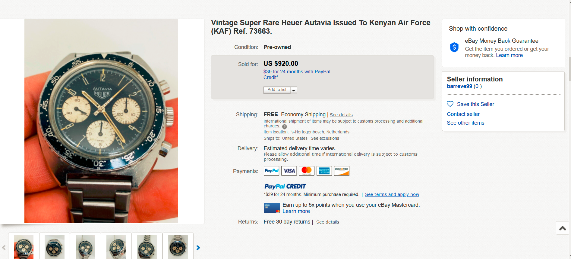

If you bought this off eBay for $700 from a 0-feedback seller, you should be contacting your payment provider right now to stop payment and get a refund. That listing is almost certainly a scam, and even if you do receive a package to your address it likely will contain a rock / old batteries / some old worthless watch, going by previous anecdotes.
Where do you see this on eBay for $700? I could only find this. Went for 拢4500 and the seller has 551/99.6% feedback. Sold on 30th April, though, so perhaps there's a more recent listing for it I can't find. Pictures are the same, though, so agree, someone may have "borrowed" them for a fake listing.
https://www.ebay.co.uk/itm/Vintage-Super-Rare-Heuer-Autavia-Issued-To-Kenyan-Air-Force-KAF-Ref-73663-/283856430350?hash=item421729650e:g:kFMAAOSwat9eny0H&nma=true&si=2x0DT%2Fo85F%2BpYeJOCzo4SkgrAa4%3D&orig_cvip=true&nordt=true&rt=nc&_trksid=p2047675.l2557
https://www.ebay.com/itm/Vintage-Su...-Kenyan-Air-Force-KAF-Ref-73663-/153984230597
Already spoke with @whats_shakin who has gotten his money back.
(eBay links expire, so here's a screenshot of the scam posting)
Some group in the Netherlands has been doing these for the past couple weeks.

Ahh, the proverbial too good to be true. Incidentally I have rolled the dice on a few absurdly cheap vintage heuers and all but one were real. I鈥檓 ashamed to say I did fall for the Franken bandits but thankfully Jeff Stein steered me in the money back direction and a happy ending.

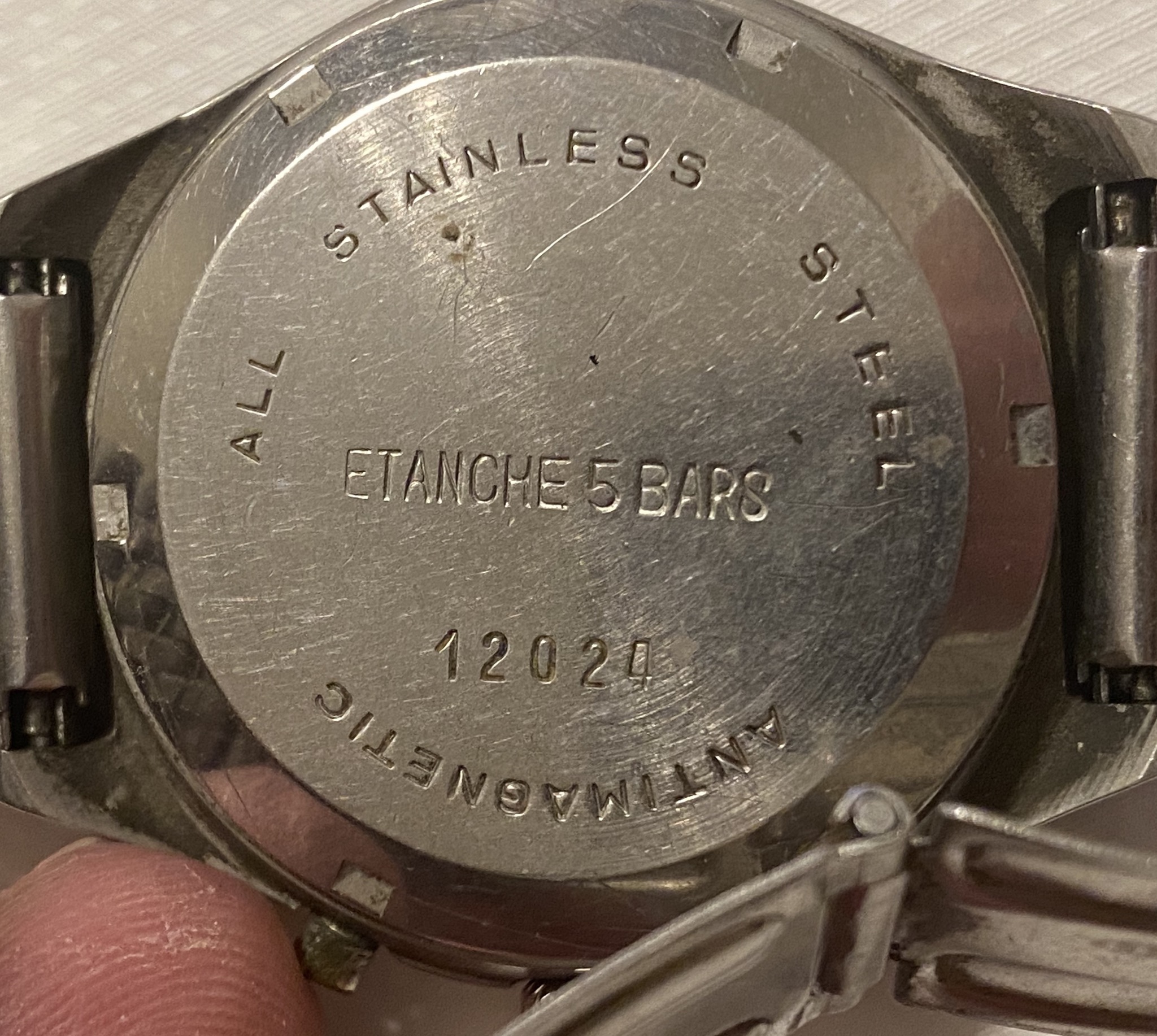

Hi all. I am new to the forum. I also know nothing about watches so please forgive me for any stupid questions. I was given a Heuer watch a year or so ago that was my wife鈥檚 grandfather鈥檚. I got to looking into it and am very curious if it is authentic or not. It is not in very good condition. It was worn as a regular watch for years. Anyway, I can鈥檛 even figure out the exact model. Please help me out if you can.
