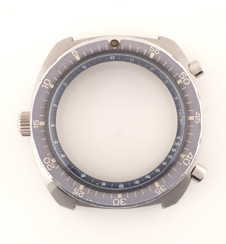

    Not new to vintage watches, but brand spanking new to chronographs and Heuer, so forgive the Newb question:
    Is this a Heuer case/bezel/outer ring? It was advertised as such, but I cannot locate the model.
    Thanks for any help locating the model or debunking it as a Heuer.

    Calibre11 Editor of Calibre11.com Staff Member Oct 18, 2016
    7,119
    14,999
    No, this isn't an Autavia case/ bezel, but it does look to use the Chronomatic movement. I don't know Breitling's back catalogue very well, but they were the other brand that used the distinctive left-crown movement, so I'd look there.

    retroworx Oct 19, 2016
    Thank you! I've learned it is a Kelek case that takes a Cal 12 or 15.
