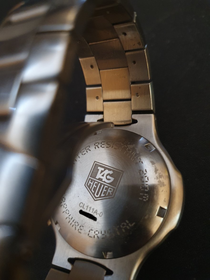

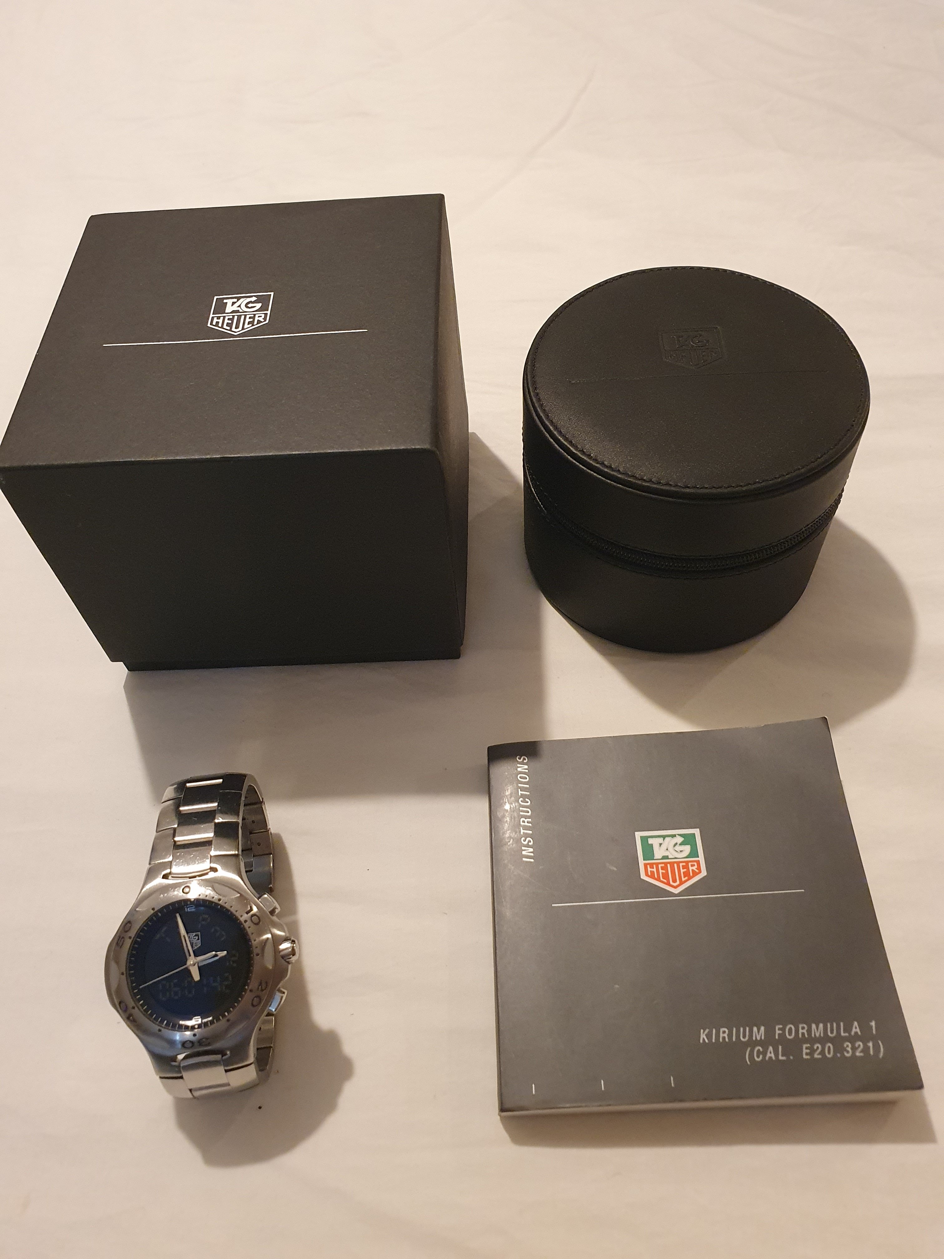

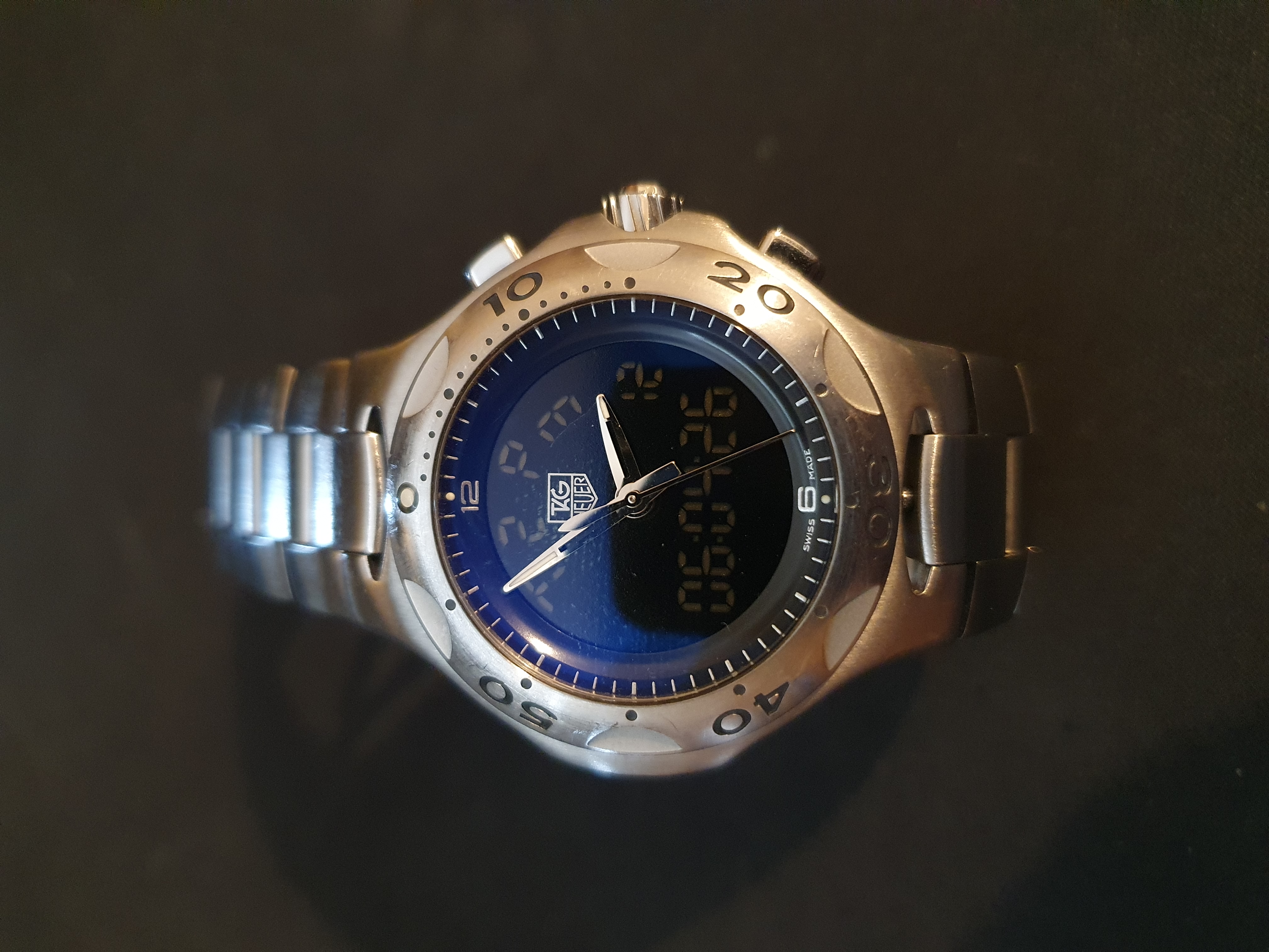

I bought a Kirium CL111a-0 a couple of years ago from Ebay. Around the same time I got very sick. I very foolishly, quickly checked the watch and stored it, without checking if it was authentic or even working properly.
Fast forward a couple of years, I've finished all my surgeries and treatment. To my surprise, the battery didn't need replacing, but upon further inspection, the hour hand is malfunctioning. This prompted me to inquire about servicing from Tag Heuer, which lead me to check the watches serial number on Tag Heuer's Warranty search page. My watch doesn't yield any results on the Warranty page. Is this is normal for such an old watch? I also snagged it for a suspiciously low price, which adds to my concerns.
I don't think this is a replica and I'm not sure if they've ever been repped. For peace of mind, could more knowledgeable members here provide me with more insight? Is this a fake?
I'll attempt to attach some pictures!
Cheers

Looks real to me, send it to TH for servicing and you'll either get a quote or it's sent back if it's fake.
899
391
There is zero reason to believe that watch is fake. But that box, is suspect
I agree. Watch is fine, box is not.

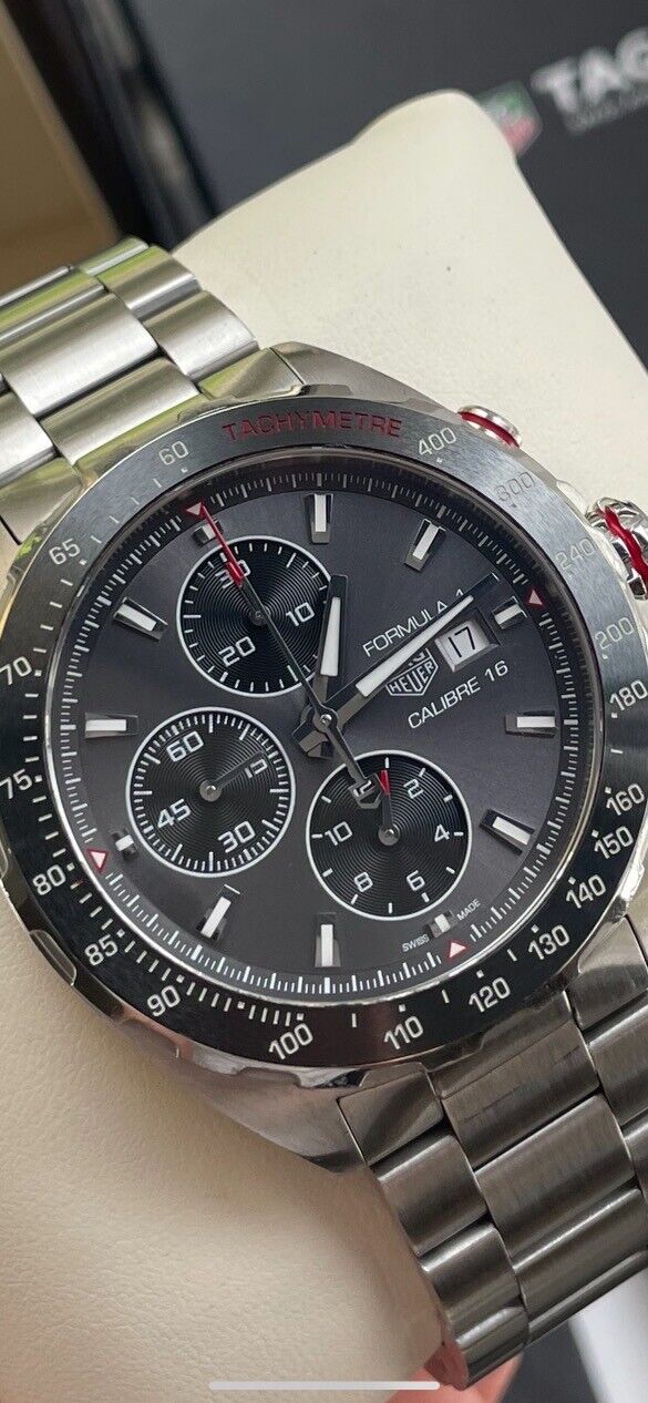

Looking to buy a Calibre 16 watch, this one caught my eye, but the price makes me a little suspicious - could someone advise. Thanks

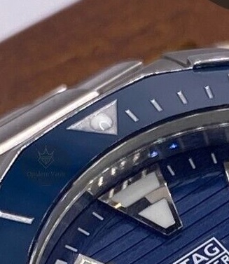

Your first sign, should be that this watch you bought with a serial number that checks out, is being sold again, despite it already being sold to you.
https://www.ebay.co.uk/itm/314878623461?epid=10059699525&hash=item49503a7ee5:g:xwMAAOSwGptlJGoJ
A tag shop also either can't tell you if it's an obvious fake, (which these aren't obvious fakes anymore), or aren't allowed to.

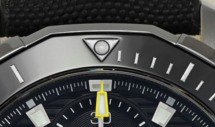

in either case tho, zoom in on the bezel pip. Just, eww.
Now, compare it to a real one.

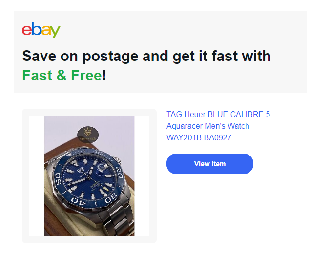

Great, now ebay are promoting the fake Aquaracer to me!
Ebay, or Crime Bay as most people call it, is one of the world's biggest market places for criminals. How anyone could even consider buying luxury goods on this site is beyond me. Sometimes I feel people get what they deserve, with thousands and thousands of people all over the world wearing fake watches thinking they got a "good deal".
