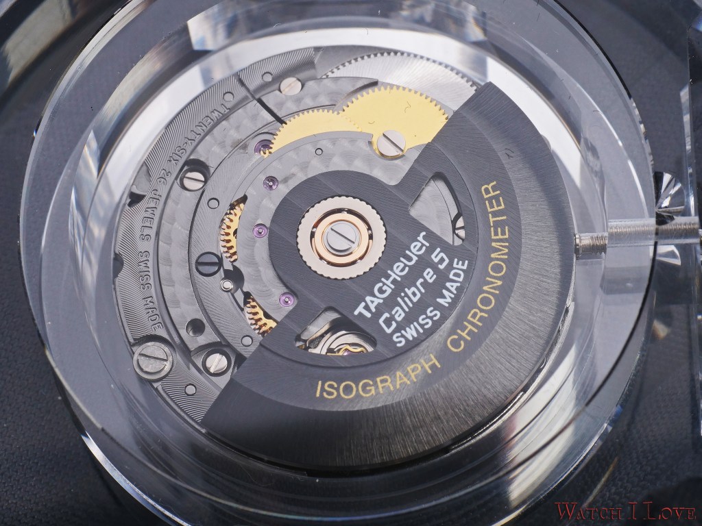

oh jesus, so they aren't even using screw on the automatic movement holders???
I have never seen such a watch before, and I do not know how this movement is installed, but I previously read an article describing these models with black movements
75
13
I mean exactly this caliber, but I read on the forum that these calibers were never put into mass production
What I meant is, that movements in Tag's, are attached to the plastic movement holder, with a screw. The fakes have no screws, and the movement is free to move around. Look at the screw at the end of "swiss made" on the very left lower side of the movement. That screw holds the movement to the plastic ring, which holds itself tightly inside the case. Now, keep in mind, there is always a chance someone installs the screws after the fact, or a chance that someone removes the screws from a real one. But if you see a new watch and it has no screws, you can be confident it's a fake. But as always, never use one single thing to determine authenticity.

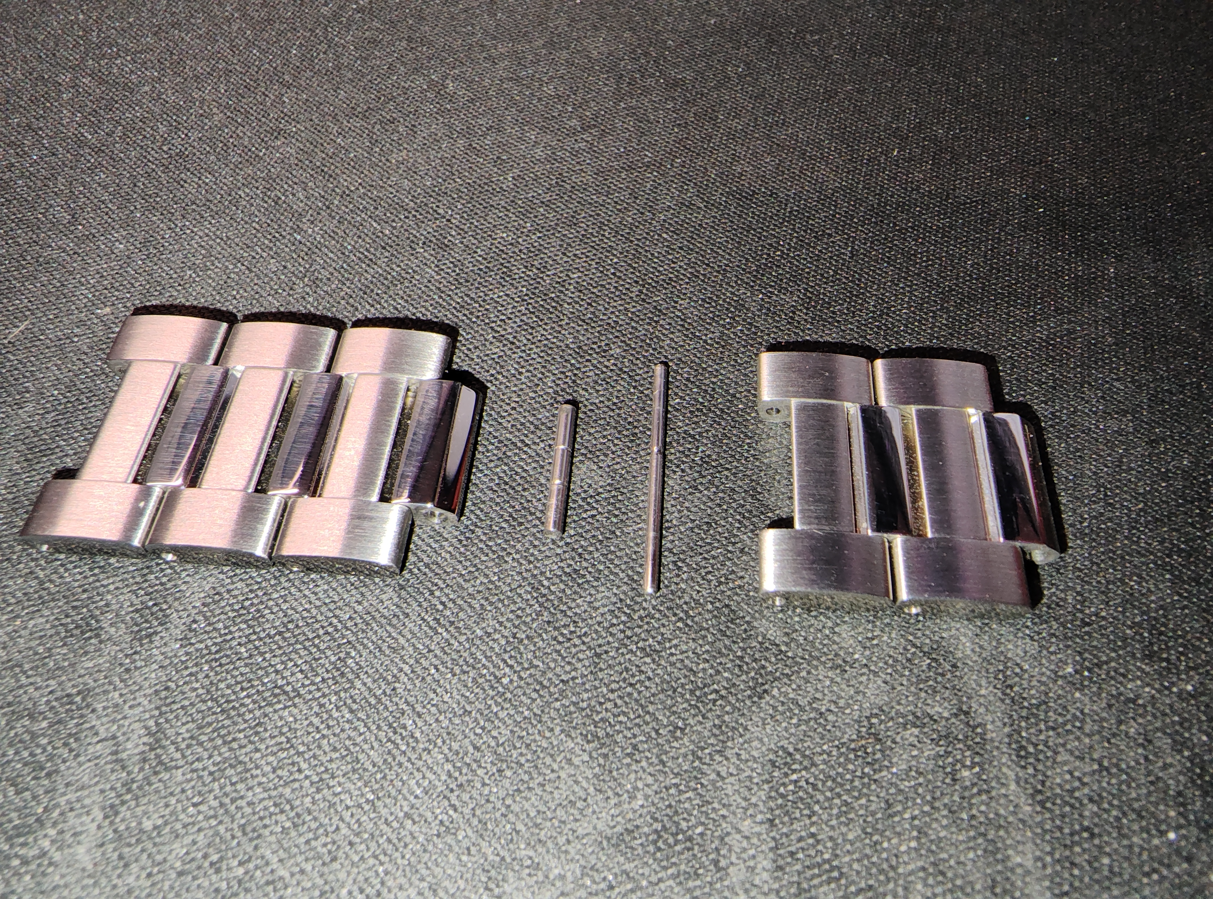

I've emailed the seller in Japan, we'll se what they say. Yeah, I've taken a few off to fit my wrists. How come?
And that's yet another check mark for this watch. Japanese sellers are very good, and it's VERY rare for them to have fakes. And when they do, it's usually one offs. like, they have 1000 watches for sale, and one of them slipped through. But Japanese seller, on top of everything else you've shown us? At this point, if you're not comfortable, you have to send it to tag heuer. we've given you a lot of info, and if that's not enough, you need to send it in, as nothing else will make you feel 100% certain. Nothing tag can say over the phone or email will help either.
Also, show us pics of the link pin and tube you removed please.
They were launched but got recalled shortly after they hit the market. Owners who got one were offered a replacement with the standard calibre 5 IIRC. Im guessing a very few examples are still out there owned by collectors who might want to hold on to it due to it being so rare.

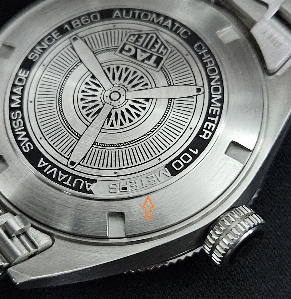

Hi guys,
Judging solely by the image below, is it a likely red flag?
Is it possible for the color to have come off like that on the genuine piece?
Thanks!

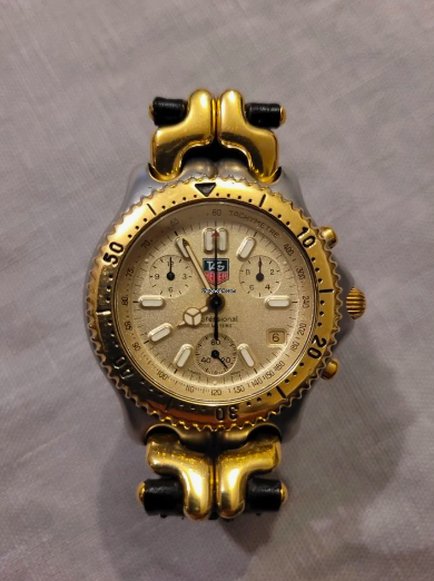

Hello everyone.
Looking at purchasing an S35.406 from a private seller. My main concern is the case back engraving "SWISS QUARTZ", instead of "SWISS MADE", and the lack of serial number. I've just started researching and doing due diligence but cannot find specifics on my two concerns with this watch. Does this watch raise any red flags?
Any help is greatly appreciated.
Pics of the case back and the front of the watch:

It's just an older version of that watch. Nothing wrong with it. Don't worry.
Ah ok. Another thing I noticed was that the lumes were a bit bigger on this watch compared to other watches i looked at for reference. Can we attribute that to being an older version of the watch as well?
