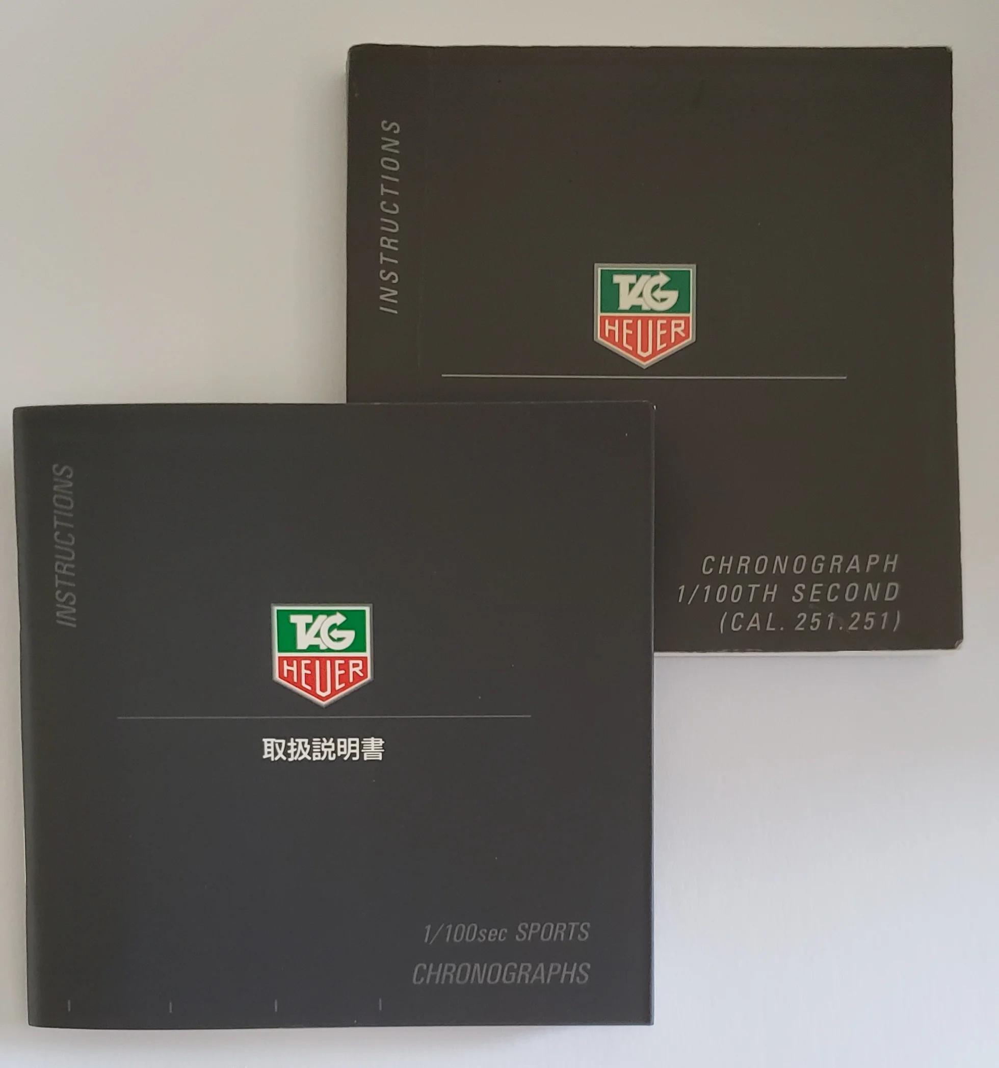

I have two. My Japanese version says 1/100sec SPORTS CHRONOGRAPHS, my other one (English, French, German, Italian, Spanish etc.) says CHRONOGRAPH 1/100TH SECOND (CAL. 251.251). Which is a little puzzling since the movement inside says ETA 251.252 (not 251.251).
Thanks you sir! Happy Holidays!馃帀
8,791
17,889
FFR, from my research 251.251 and 251.252 are the same movement. Everything I've come across refers to them interchangeably - 251.252 has a lot more references (maybe 251.251 was quickly replaced by 252, or possibly renamed?)
Makes sense. Probably why there are different titled instruction booklets as well, with the newer version dropping the Cal 251.251 reference.

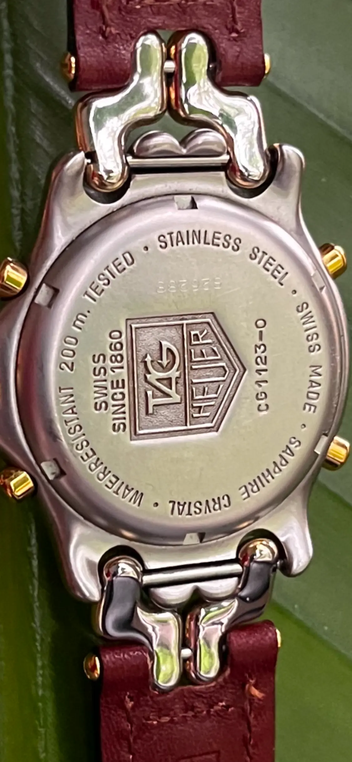

Hi Sir! Do you have photo of the back case cover of the s25.706c highlighting its serial number? I cant find one in the internet.
15
I found it. This answers my question. Thank you for the replies!馃憤
