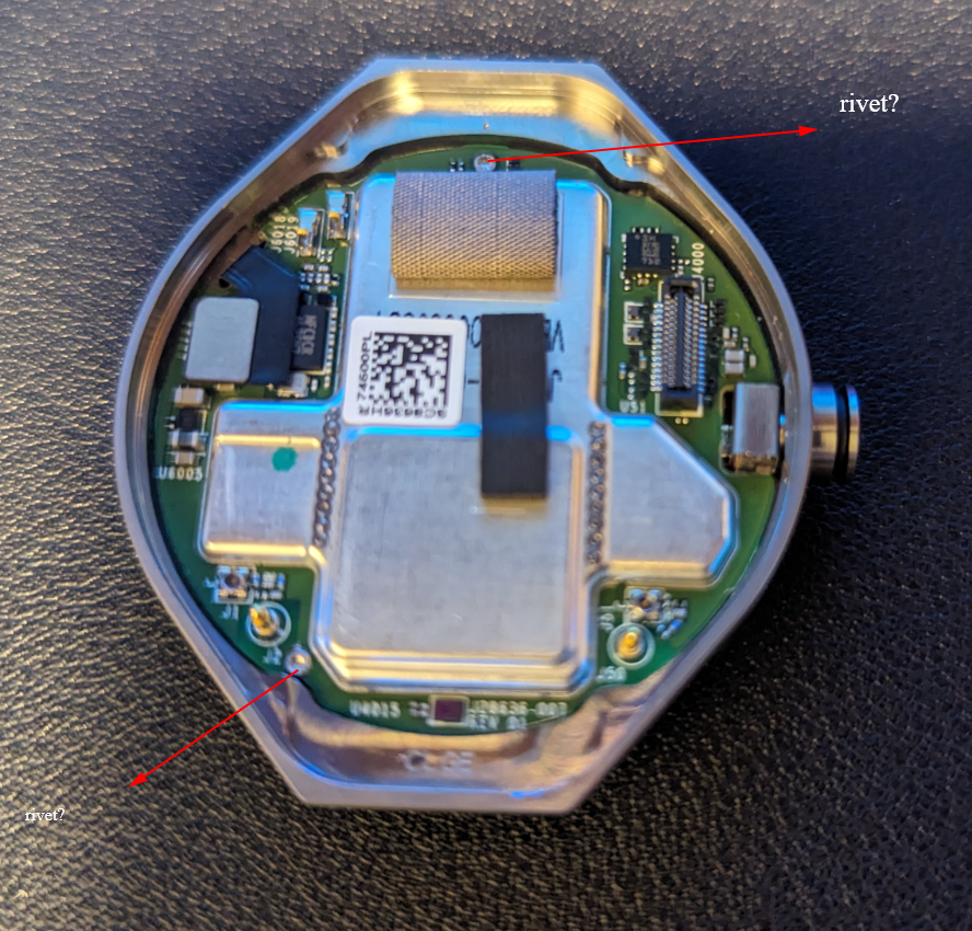

I read the whole 3 pages and decided to open my E2 41mm
All went good until the final steps.
My E2 does not have screws holding the mainboard to the case.
See the attached photo, i guess it is glued... Maybe riveted, i see like 2 rivets.
If someone can confirm if it is glued, i may try a hot gun to soften the glue.
Thanks

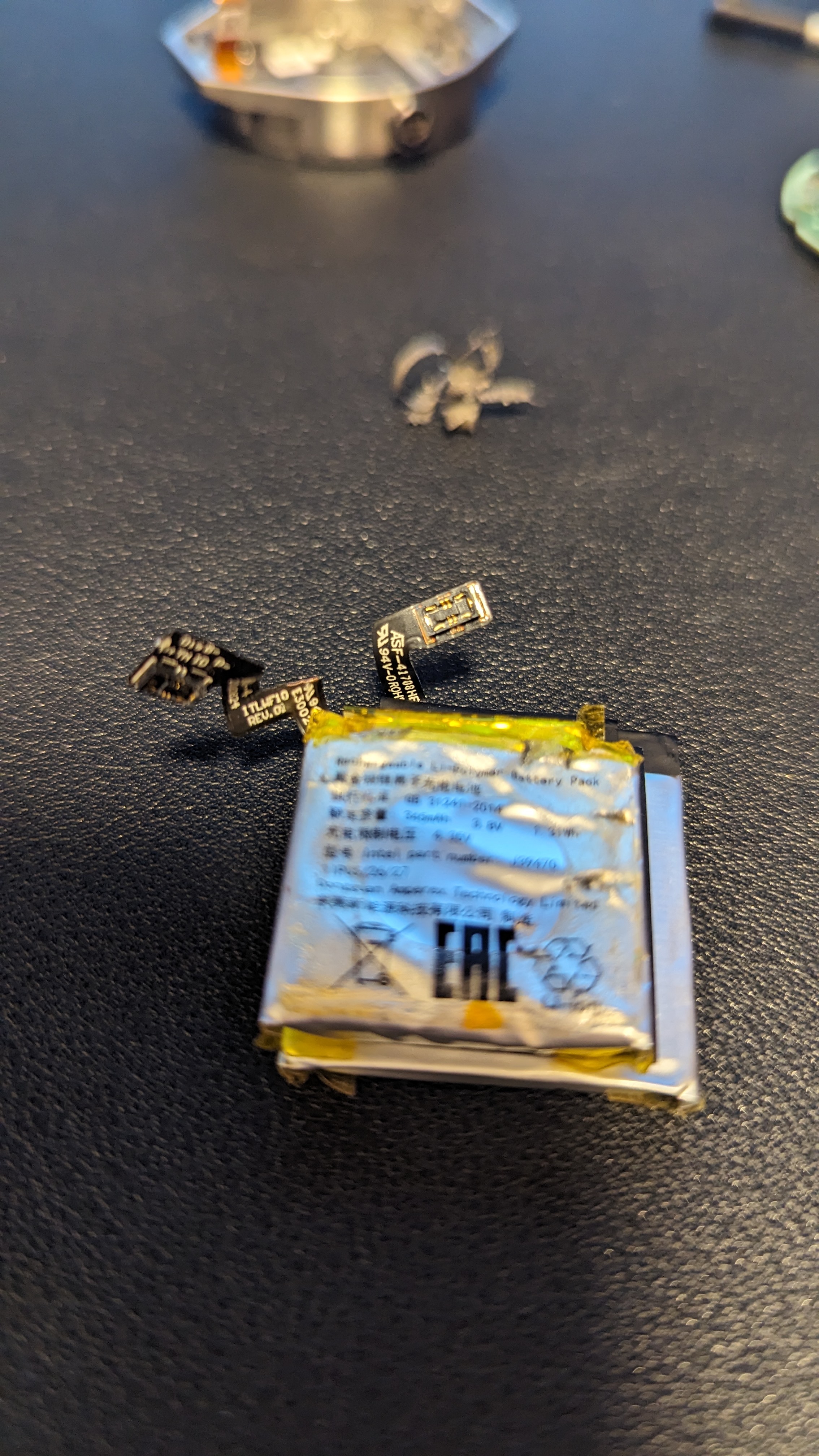

Finaly did it.
The two rivets are in reality two screws. TH marred the heads.
It also has two sided tape underneat.
This is the original battery i found in there...

Nice work. I guess you have already looked online for the battery and found nothing ?
Best bet is to find a battery of the same size and compatible, then swap over the old battery connector onto the new battery

As you will see.
The original battery is different from the one talked about on this thread.
Size is different
Number is different
Connector is too short

Yes it’s clear , the larger is for the E2 45mm where batteries are easily found. The smaller E2 41mm I have no idea where to find. I have both size watches by the way.

Does the larger 45mm battery physically fit? The little connector board/tail can be changed from one cell to the other with some basic electronics soldering tools (maybe too involved for the home tinkerer though).

Yes i kept the old battery's connector.
But i would say that physically the battery mentionned in this thread is a bit too nbig

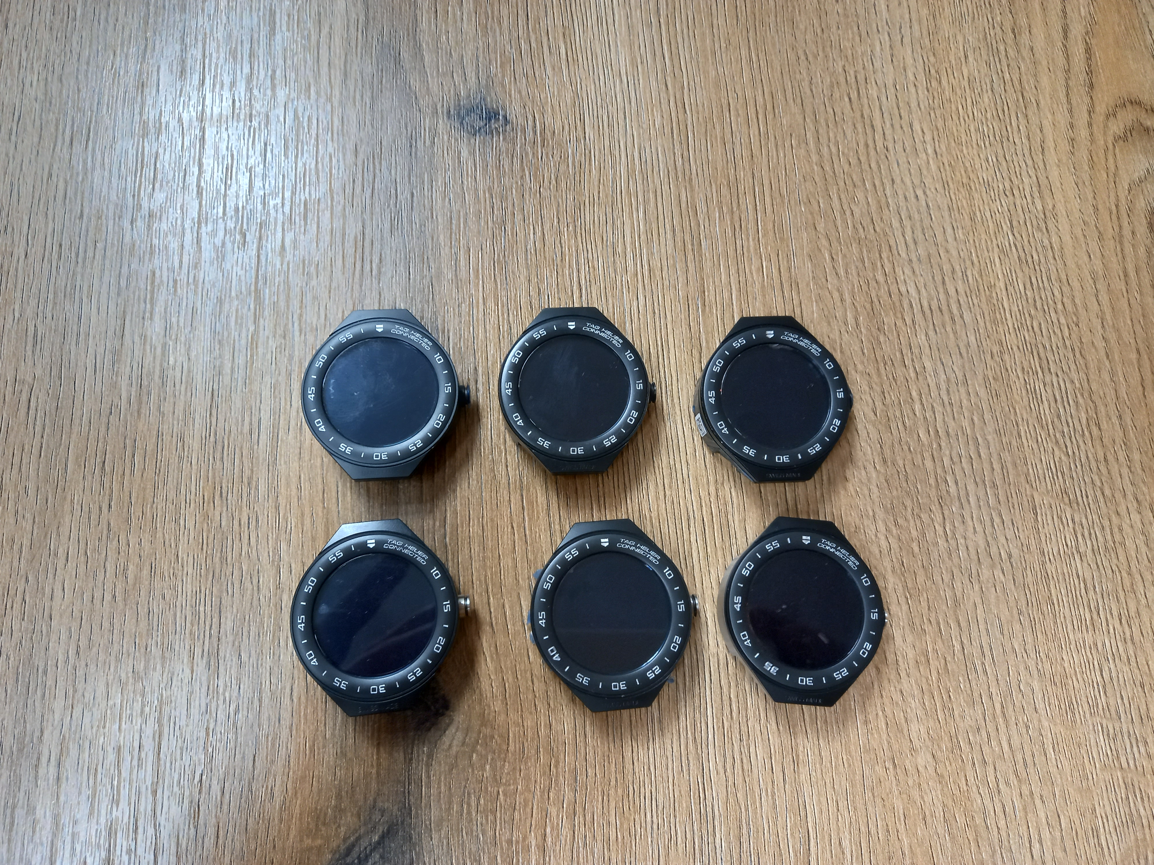

I am not really sure if I am ready to play around and open the watches up. I have 6 pieces of E2 41 sitting around, all with bad batteries, 2 showing while on charger 100%, other 4 work whie on charger for 5 minutes then they shut down.
There are heaps of batteries that might fit, but its hard to say without knowing the size in mm,

No the battery you show is for the e2 45mm. Connectors are different and the size. I have 45 mm modules and a few 41mm modules. The 41mm are terrible, they all fail like this, however it’s very rare for the 45 mm to have this problem.im not sure why ? Battery smaller and doesn’t hold charge well ? I’ve no ideal, but the 41mm will be extinct soon due to this problem and no replacement batteries. Luckily I have a 41mm calibre 5 module so I can carry on using the straps.
