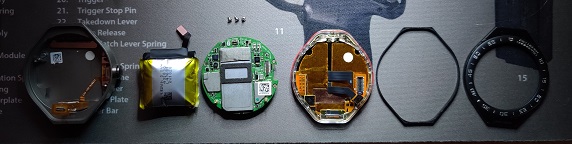

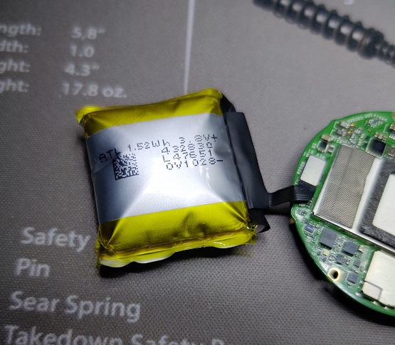

    My oldest Gen2 started showing the signs of a swollen battery, very hot and only charging to ~15-20%. It disassembled pretty easily and I confirmed a swollen battery. Given it's age and the abuse from my daily use not really surprised. I have a couple of replacements on order and we'll see how replacing it goes.

    Wow that has really swollen. Did it start to open the case by itself due to the expansion ?
    Please could you tell me the process you used to open the case, I’m quite close to wanting to do this process myself and don’t want to mess it up.
    thanks for your pictures.

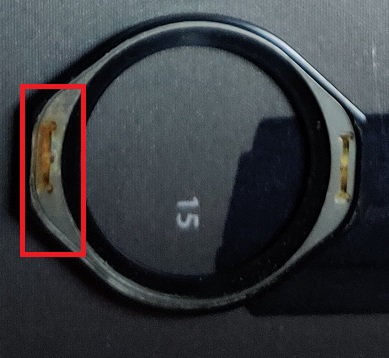

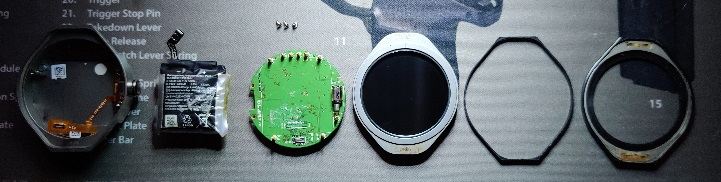

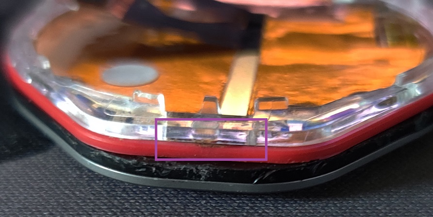

    Here is a a couple of pics of all components, Right to Left. I used a plastic pry tool, 0.9mm hex bit and a small flat head. Bezel/antenna did not require to much force. From the underside I could see time and outside elements had started to break down the adhesive. This will surely not be the same for every watch. Heat from a heat gun may be required to loosen that adhesive.
    Using the plastic pry tool and taking my time avoiding any major damage to the orange o-ring and plastic sealing gasket that keeps the LCD module tight in the titanium body. This area requires extra attention to minimize any damage. This was the most difficult area and will require some sealant on reassembly. I also kept the LCD module intact and did not disassemble it any further.
    You can see that the watch started to get some moisture working its way in. This watch has daily exposure from a coastal environment, salt water/air so I am not surprised.
    When I reassemble I'll use some marine adhesive and sealant in addition to whatever I use for the Bezel/antenna.
