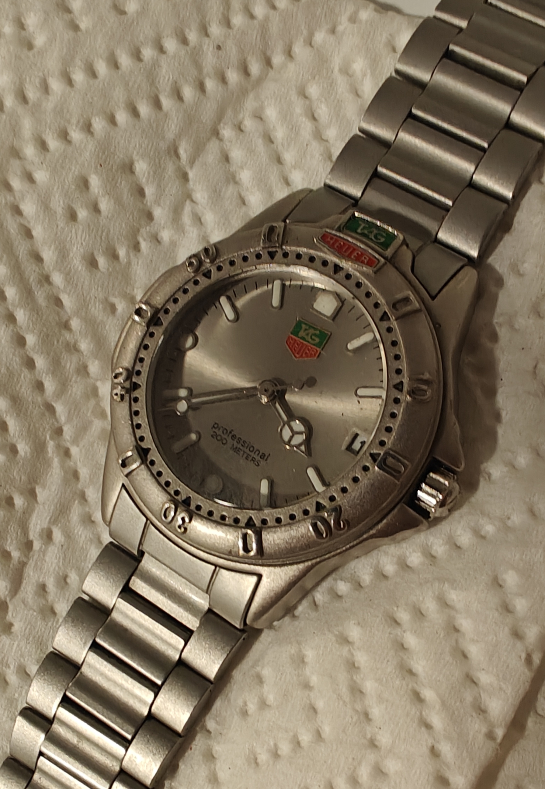

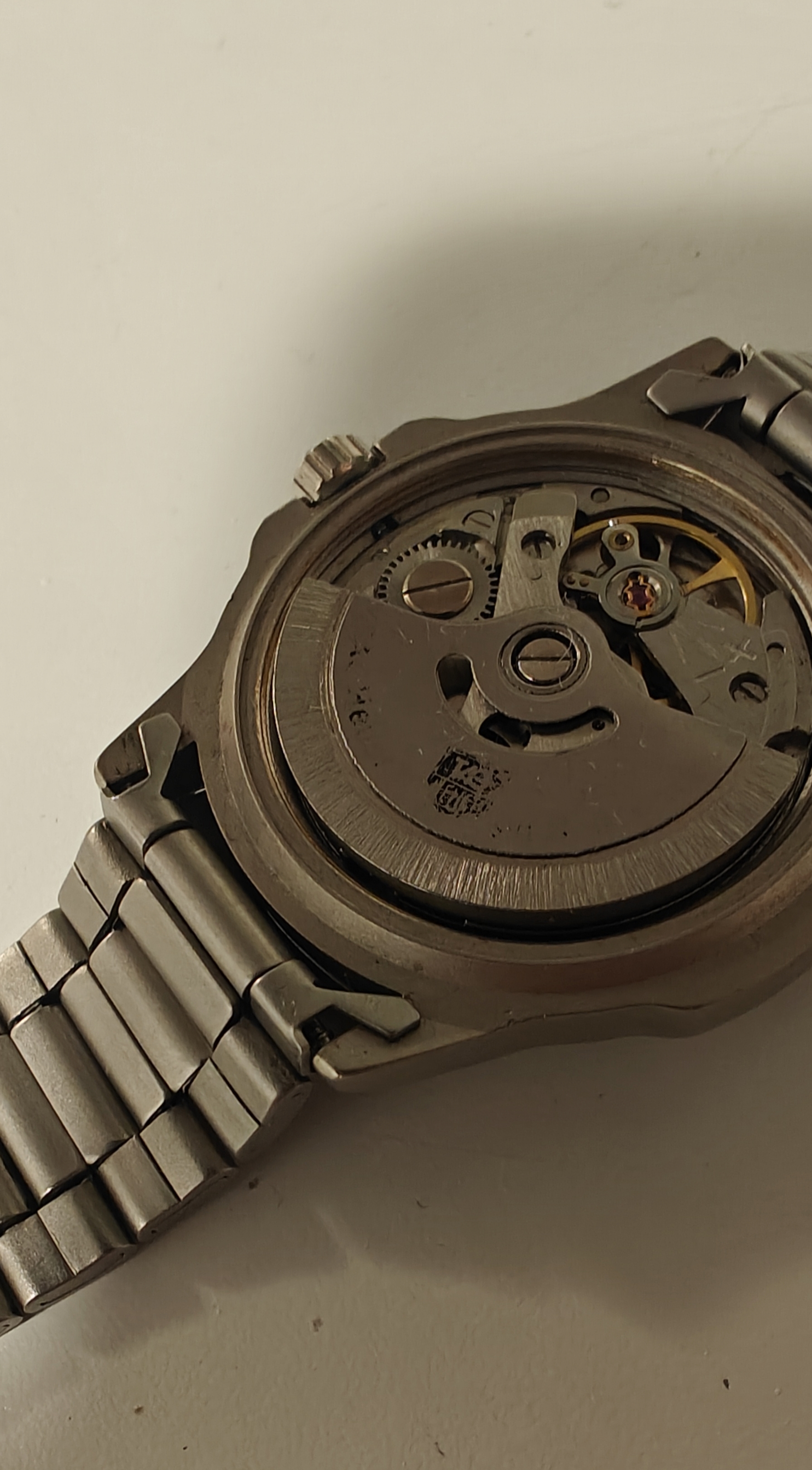

Hey guys, I really need help with this weirdo. I just bought a bunch of watches and found this. Quality on materials feels kinda good and dial looks nice. Good luminesence on pointers.
Case logo's letter G looks different than most of the other same model watches. Case back is missing and I think that bracelet is not original... The most confusing thing is that I read it should be quartz cause it's "professional". Did someone try to make it automatic or is this 100% fake?

I don't even think there was a silver dial 4000 at all.

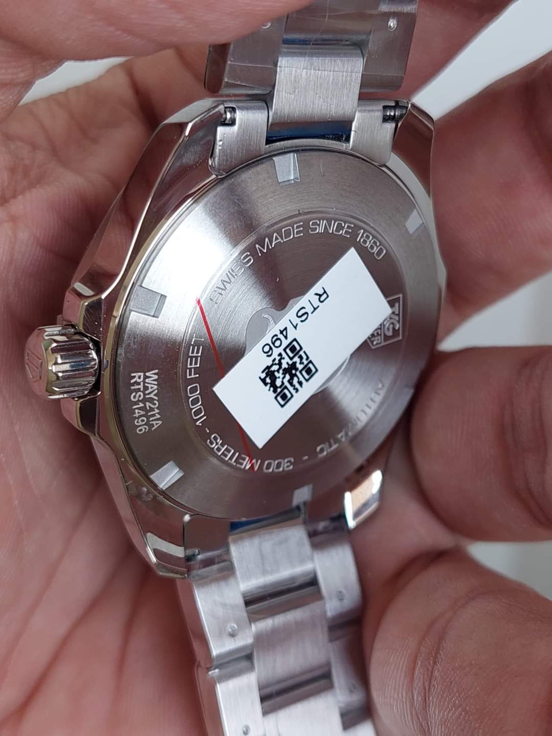

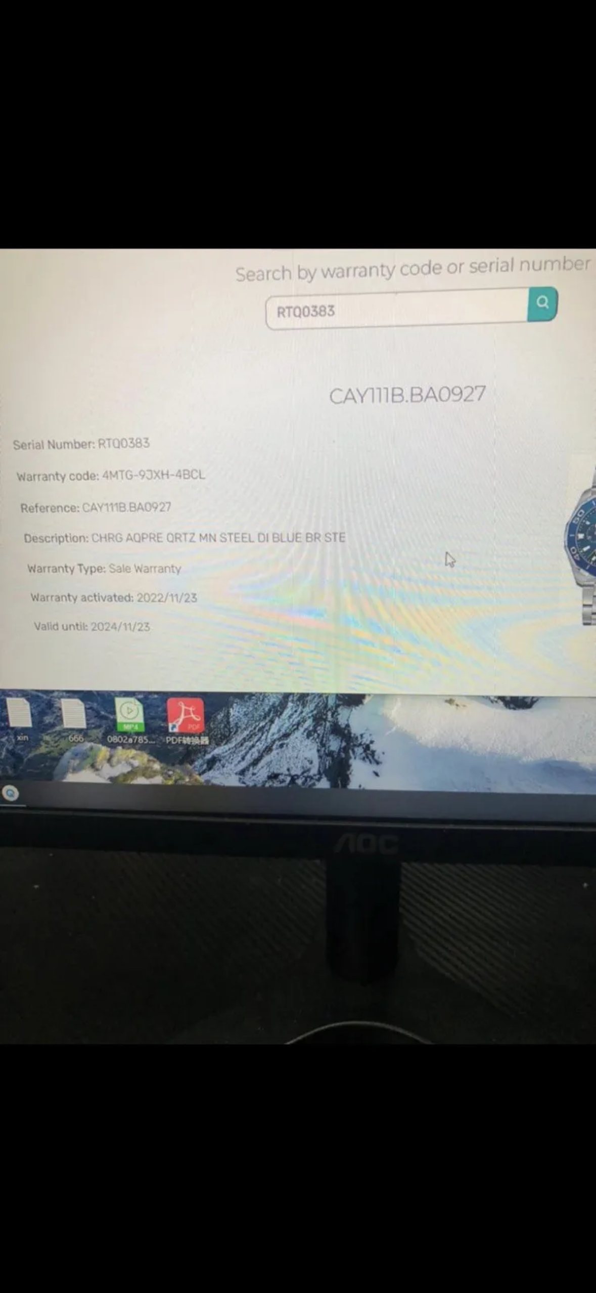

Hi guys
The serial number & warranty code matches the description on Tag heuer website, but the font on warranty card makes doubt. I have seen the letter should be bold but in this case the letters are thin.
Kindly help me is this fake watch or authentic.

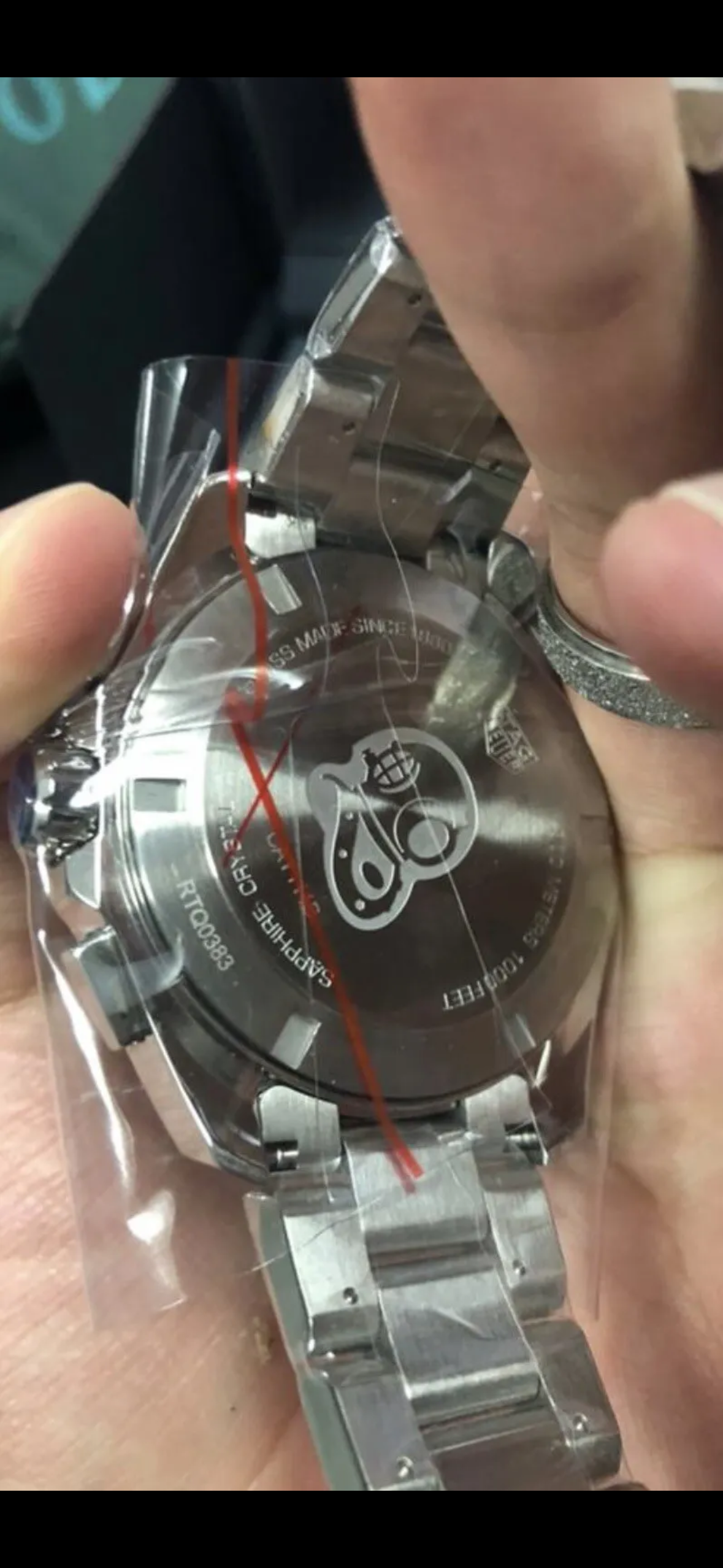

Looks fake to me. That bracelet is completely enclosed in plastic wrap; not something a genuine watch would have I'm told. Fakers do that because the metal used in the bracelet is very soft and scratches if you look at it wrong... The hang tag looks incorrect too.

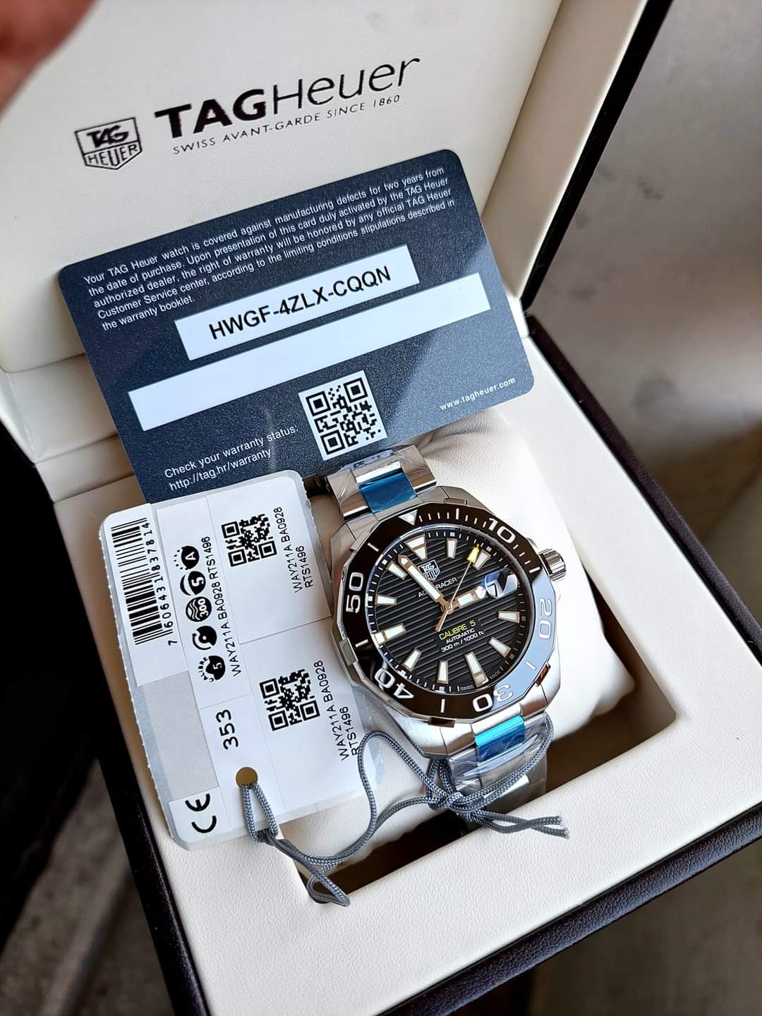

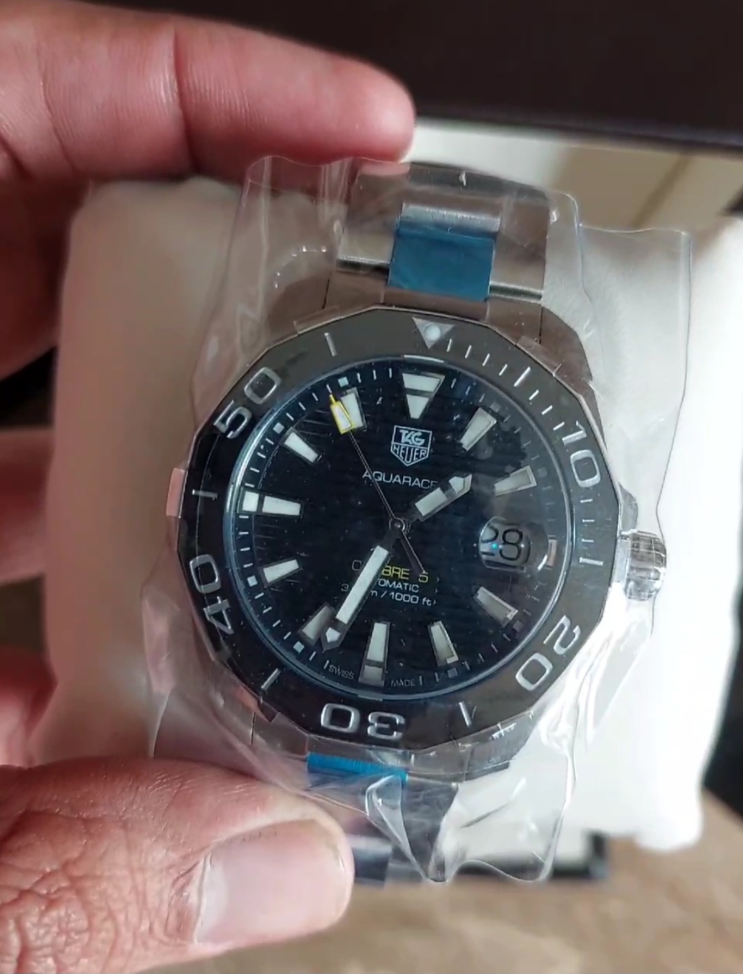

Hi guys
I'm waiting for your kind responses. Kindly help me out in this matter. This watch is being sold by online seller.

Larger pic of the front of the watch needed. Hard to tell but bezel pip looks to be like the fakes. I would assume fake unless you get more evidence it's genuine. If there's no original purchase receipt or evidence of where the seller sourced it, that's a red flag.
Is it possible that the back serial number on watch & warranty card matches on website & still it is fake?
6,089
7,355
This looks fake to me
Yes, fakers can just get hold of the numbers of a genuine watch and replicate that

That one's a really bad fake. Bezel pip is all wrong and the cyclops is actually crooked.

@Shani3996 Agree with others, this is very clearly a counterfit watch. Make sure to report the criminal seller to the police. Also type the name of the seller here to increase chances that others google his name and finds it here.

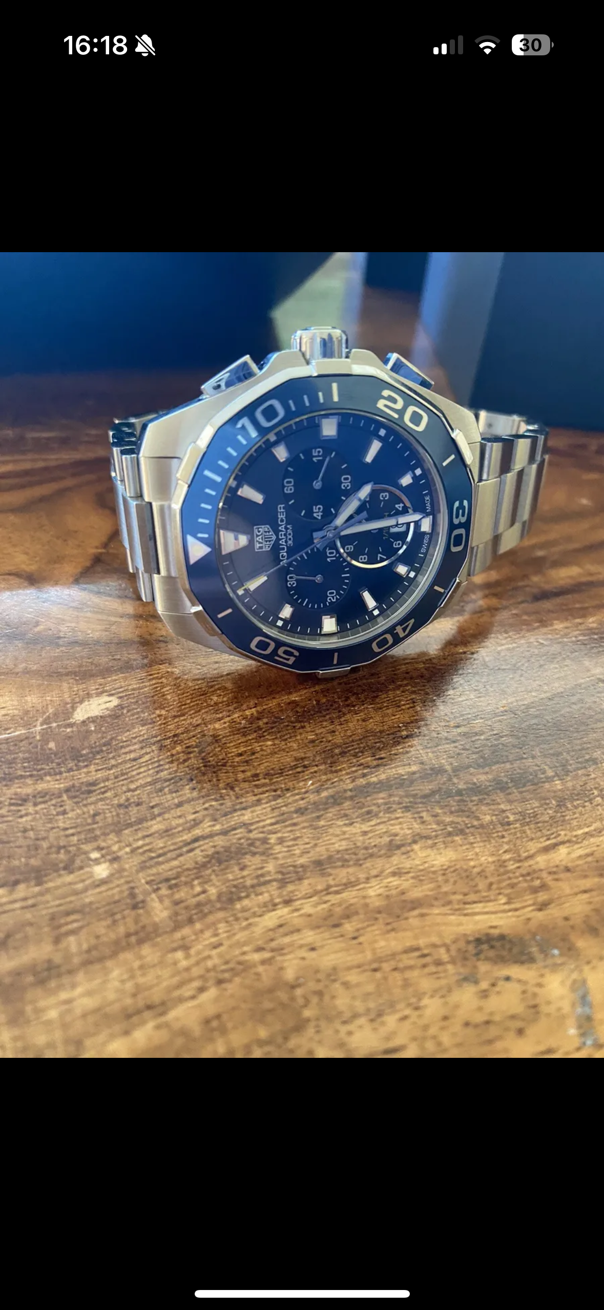

Hi guys,
could you please help me checking this watch? Bought on eBay but I have a hunch that it could be fake, serial number and warranty code match on Tag website. But the pdf with the Chinese name in the picture sent me by the seller worries me
can add more photos when it will be delivered

Hi guys,
thanks everyone
Dude, do you even have to ask? 😁 You bought it on crime bay (the number one site for counterfit luxury goods, why would you buy something there thinking it would be genuine?), the photos were sent to you in a pdf file named with Chinese symbols (wtf 😵‍💫) the photos show two different boxes where one box has a warranty card and the other completely different looking box has a watch
