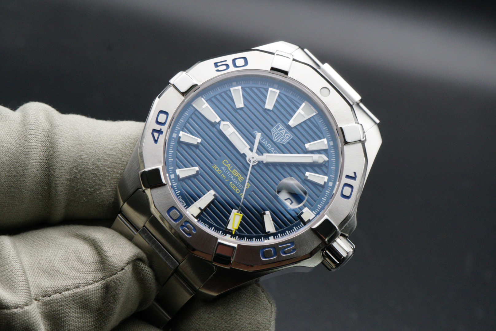

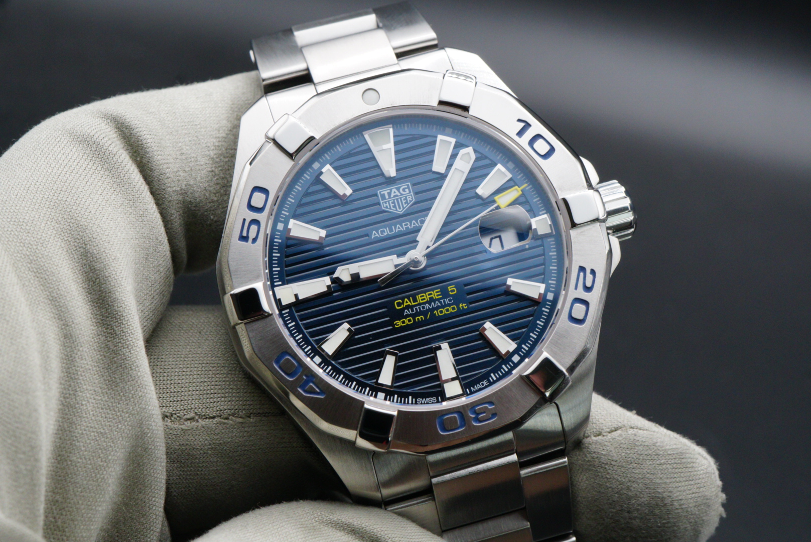

Here is a photo of pip and the dial itself in good quality. Everything seems to be ok..
Is this supposed to be a WAY211A? That lume pip looks mega fake to me
I think the words you were looking for, was " everything seems to be very bad".

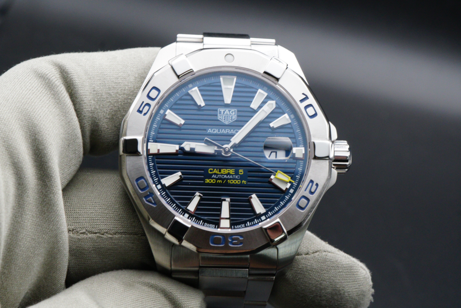

I know that these screws are not mandatory, but I still want to hear the opinion of those who know more about it
oh no no, the screws are absolutely mandatory. Only time it would not have it, is if someone removed them and forgot to put them back in. And honestly, you might not want a watch from a person like that anyways.

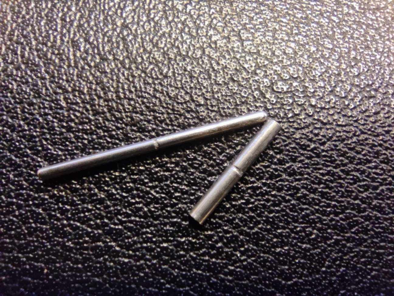

After reading the messages here, I wore the watch to the master, where he disassembled the bracelet. The tubes and pins themselves are as in the original, with two notches. The watchmaker is experienced, knows which ones should be there. He liked everything... I'm just worried about the fact that the person I bought the watch from has many such models and is much cheaper than the official price. Plus a set of watches, like good copies with all tags, stickers and a card. The bracelet of the watch was also in a thick film. I'm afraid maybe I have a super fake?
I really need to see these pics, because I've NEVER seen a fake with the two notches. And a film is fine. What's not fine, is plastic wrap.

And this is a photo of Aquaracer, in a titanium case, which was bought from an official dealer. Although many people told me that the color of the plastic ring around the movement does not matter, I am interested in why one movement is fixed with screws, and the others are not, if it is the same manufacturer?
The screws aren't the manufacturer. They ALL come with screws. Otherwise the movement/dial would just shake around. Screws holding the movement down are absolutely mandatory. Period. The plastic ring takes up the empty space in the case, and is tight. The movement and dial have to be screwed to that, so that they become one piece.
Because it is mega fake 😁. I wonder why it's so damn hard for them to make it look good. How much more work can it possibly take? I guess we are lucky they are so lazy huh.
