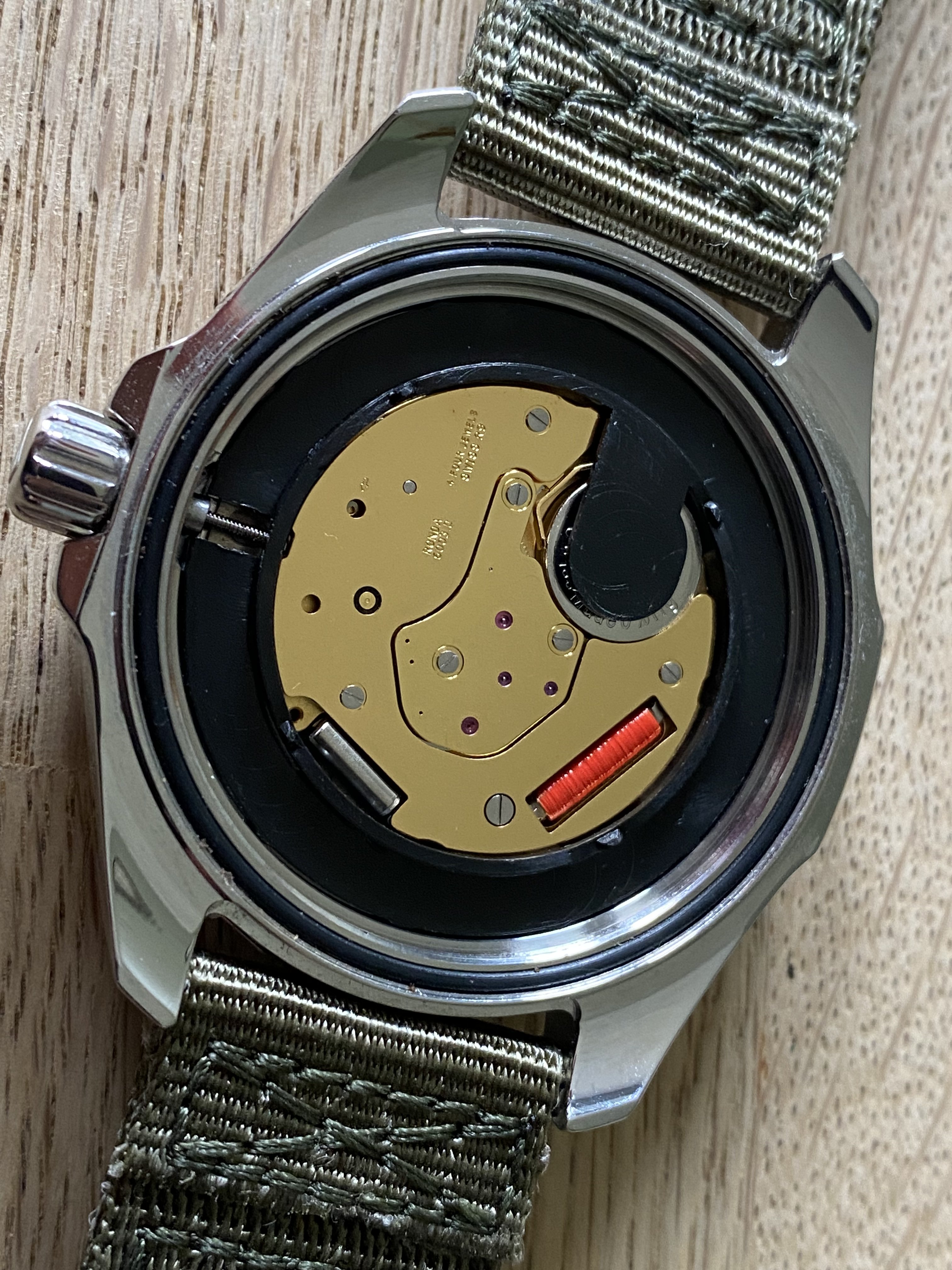

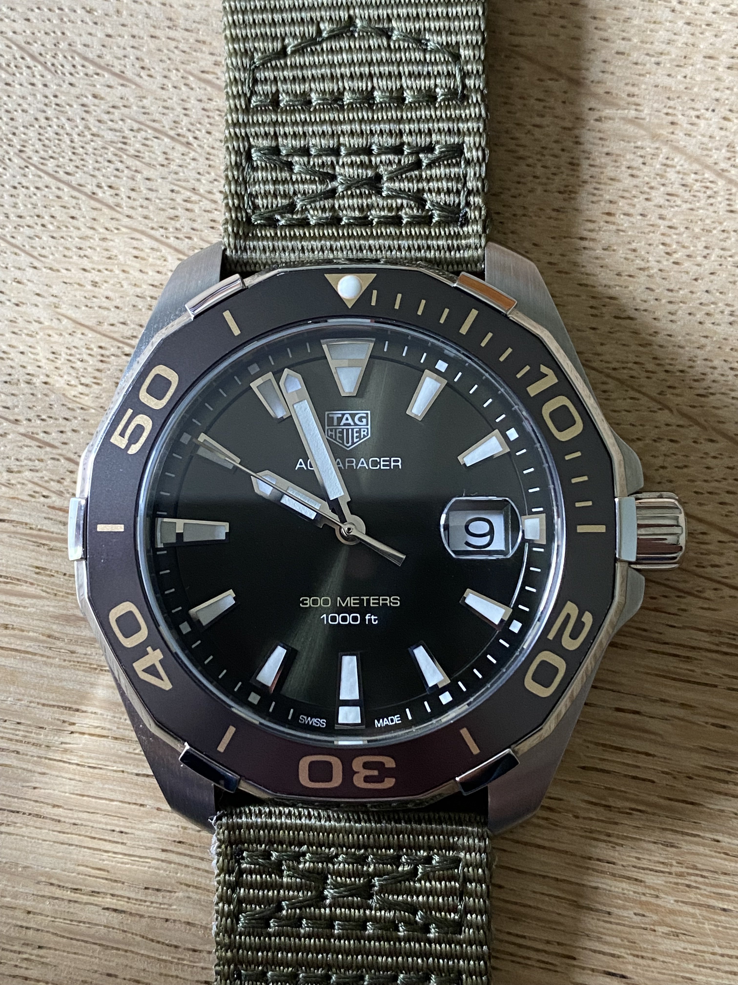

Hi Everyone. I’m new the the forum. I recently bought this WAY101e. Is it authentic? The serial number is recognised on TAGs website and shows as the correct watch. I’ve opened it up and it has a Ronda 6003D. Any help would be appreciated! Thanks
Lumepip looks off to me, here's how it should look;

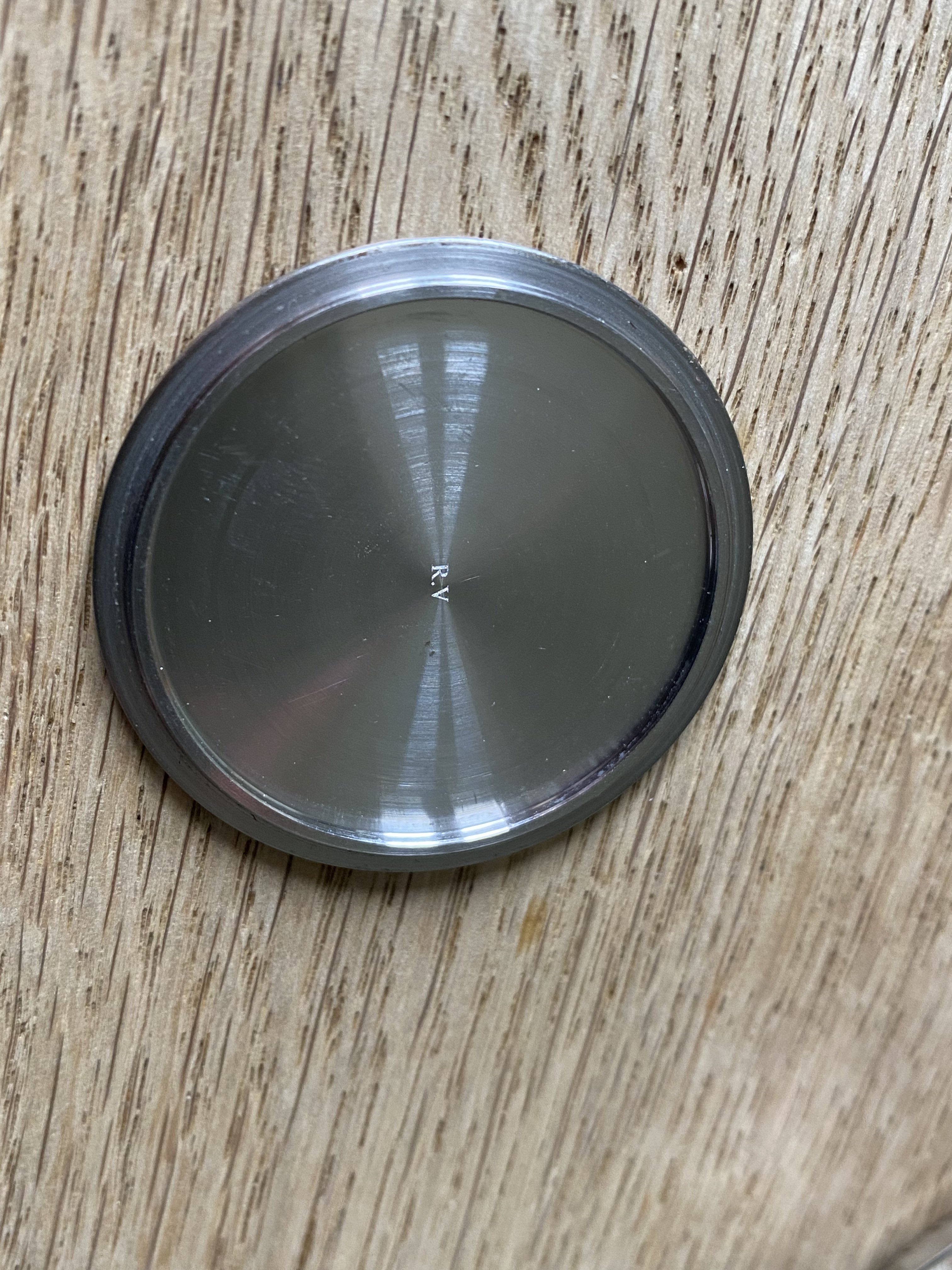

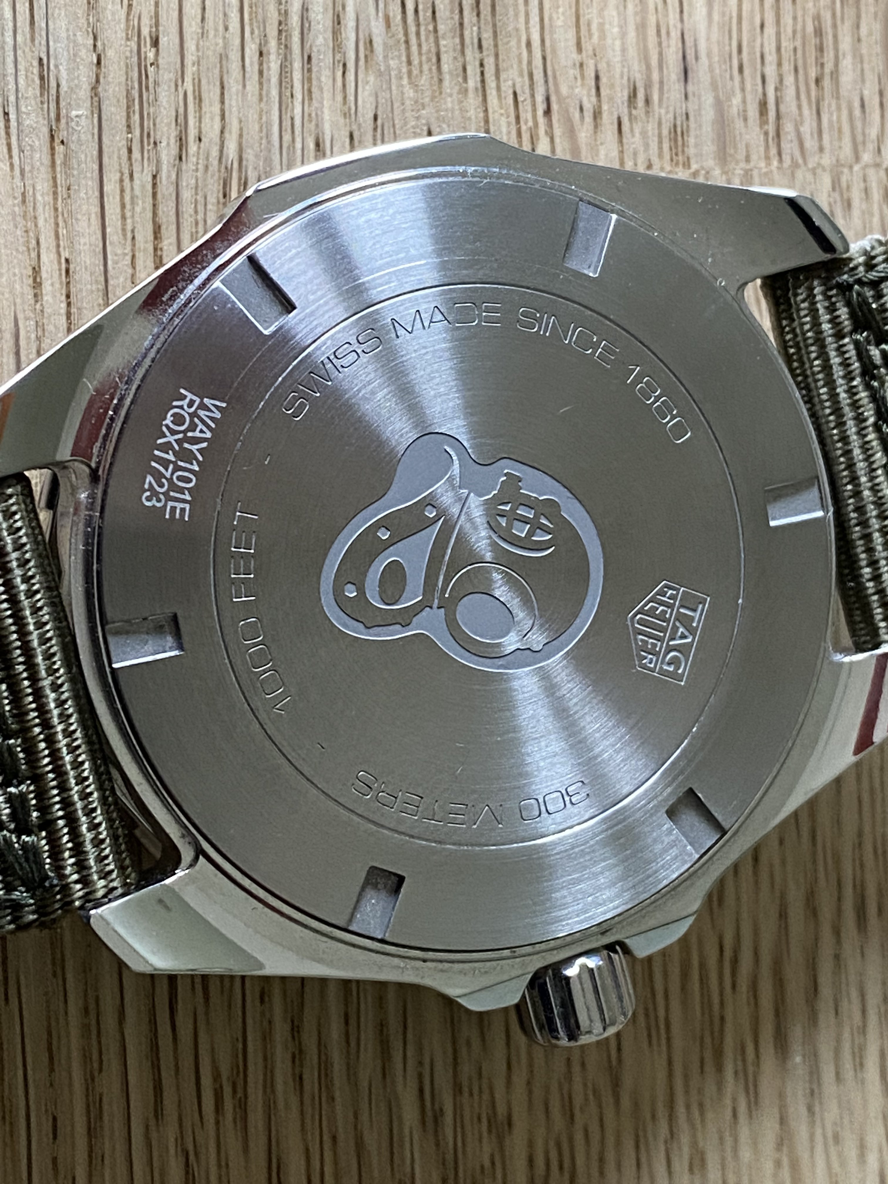

Thanks. That’s what I thought having looked at others online. Here’s some photos of the rest of the watch.

Agreed, watch posted by @Jay_83 is definitely fake
Thanks guys. It was the lume pop that was definitely looked off and set off my suspicions. Any other aspects that are glaringly obvious showing it’s fake?
Real logo looks better and the diver helmet is reversed in the grain application:
