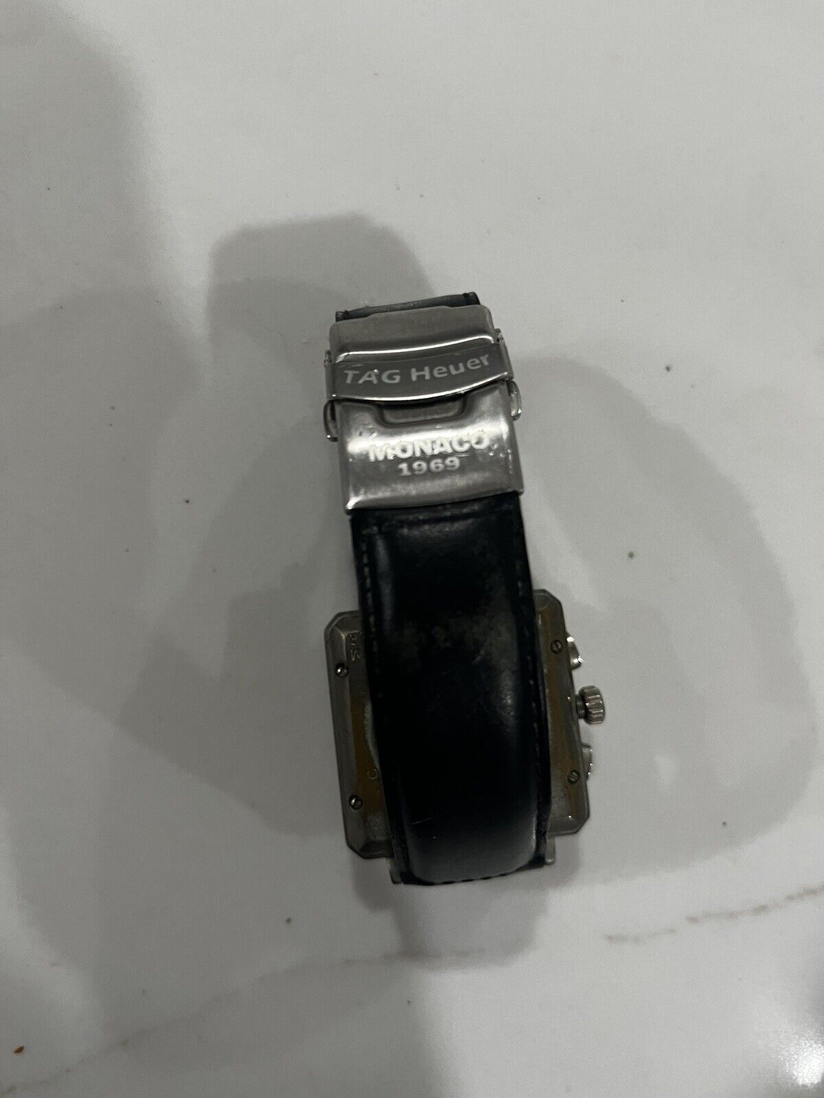

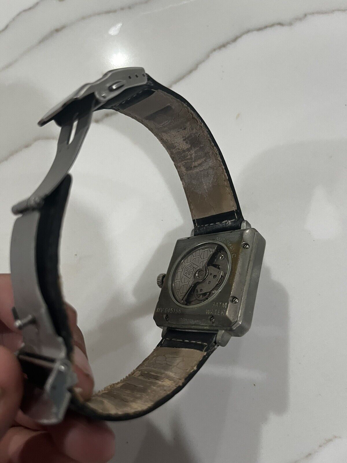

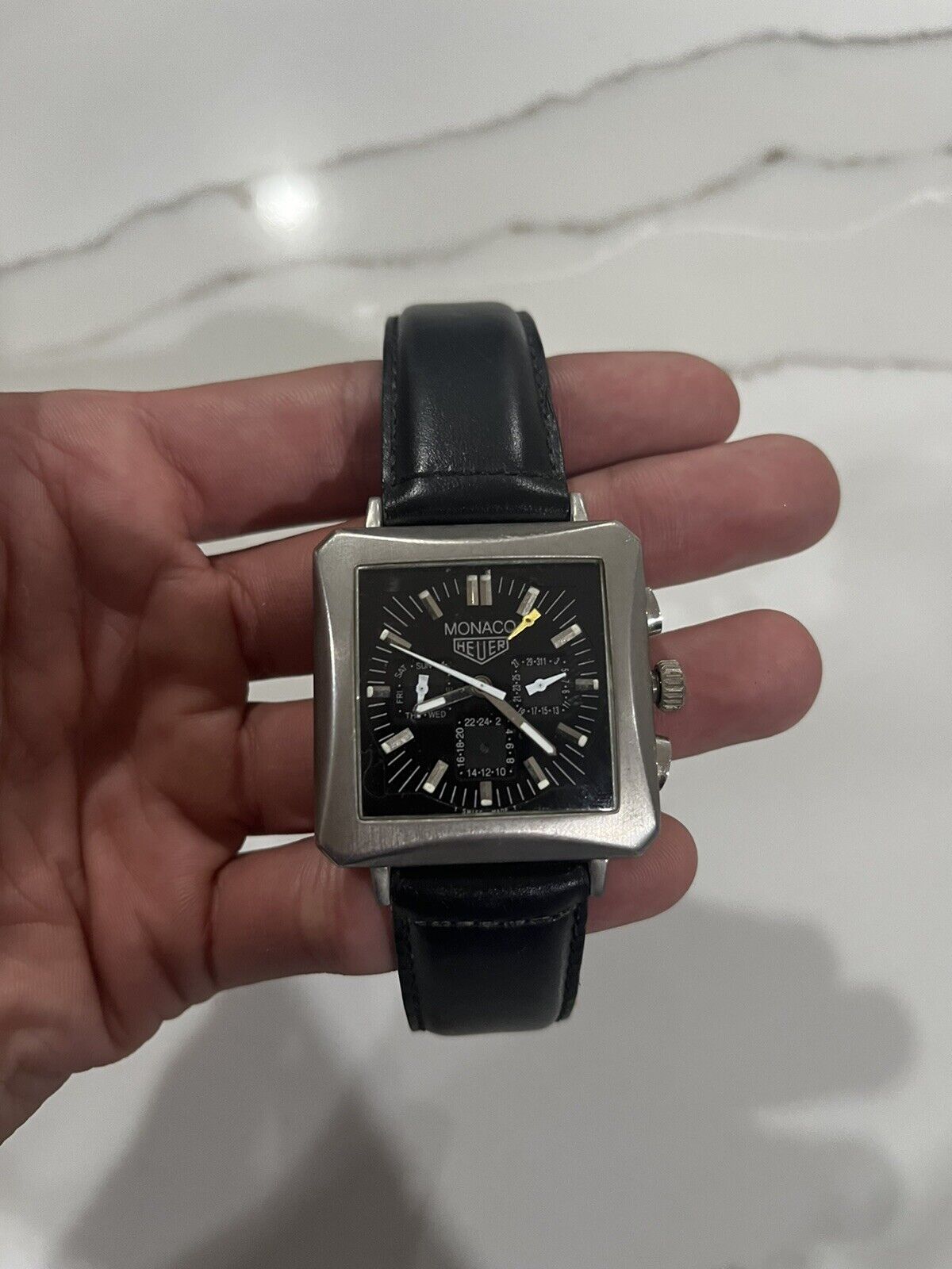

Also this "rare" Monaco.🤦 If it just wasn't for that detached 24 hour hand 😲
I’m amazed that for fakes like that they go to great length to even brand the rotor and clasp 😁
What’s that yellow hand at 1h, btw? 👎

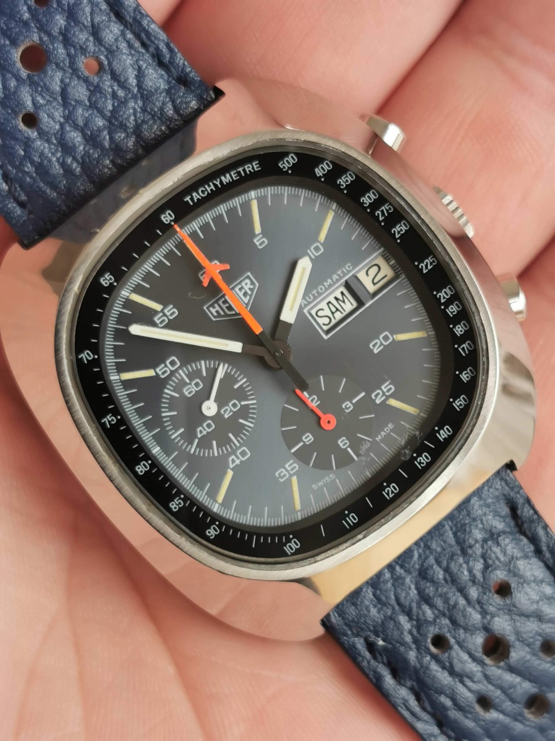

I may or may not have bought a few fakes since starting to purchase potential tag heuers a few months ago and i am aware of this, mostly being with no paperwork.

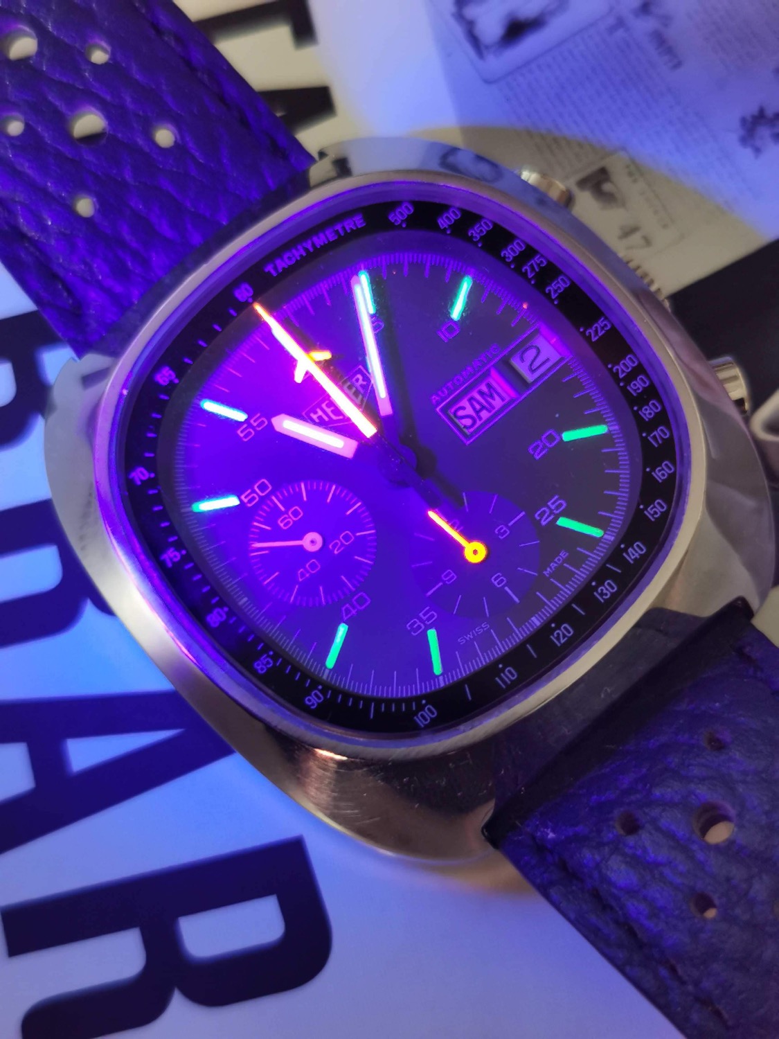

One thing that i am wondering about is a ( possible) series 1000 I bought. I do really like it but it hasn't got a lume dot ( or hole where there used to be one ) on the bezel at the 12 position - see pic.
Every pic I've seen of series 1000 since have the lume dot. So, was this ever a thing ? Is there a possibility the bezel's been swapped out or just (obvs) fakery ?
Cheers,
Dave.

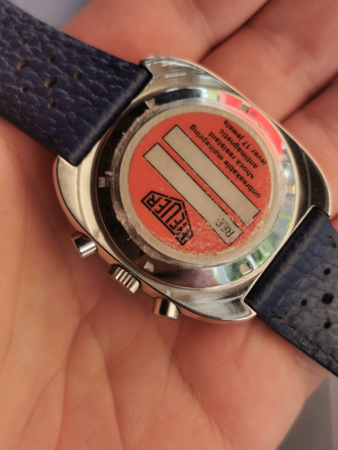

I suspect yours is fine but can we see the caseback please? The 980.033 'economy' model doesn't have a lume dot....
Best, Steve

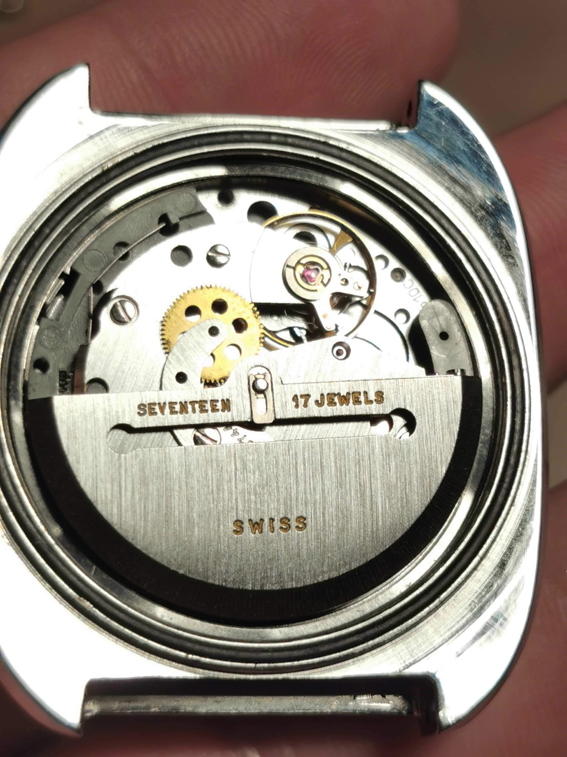

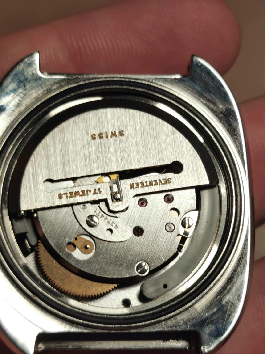

Hi Group, what are your thoughts on this Heuer Silverstone 510.403? If you are commenting, you probably know this watch was offered without the Silverstone script. This one does not have the "510.403" stamped on the case back. Is the movement correct? Overall, looks better than some of the fakes I have seen.
1,414
4,125
I'm thinking that if you're considering a Silverstone it should state so on the dial. Same problem I'm having with my Pasadena search.
I can't attest to the movement authenticity. I'll leave that to the experts here.
7
If you're considering a Silverstone it should state so on the dial.
Sure, that would be nice, but there is a legitimate version with out the Silverstone script- it's actually the one in the Heuer catalog...
712
907
I'm not a Silverstone expert but based on the unsigned rotor/orange subdial hand, I would guess it's had a donor movement/hands with an original case/dial. That would also explain an unmarked caseback. I think the orange subdial hand was actually used on the later "named" models where the dial was printed with SILVERSTONE. Could just be a dial swap with the earlier dial.

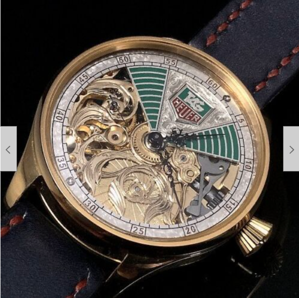

Why. Why would they even do that. I really don't understand it. It's not even a fake. It's like putting a Mercedes logo on a Yugo
3,066
3,057
Without the TH on it I might have a punt if it was cheap, something different.
£10-20 cheap.
1,119
1,925
Best part is that its on sale for £ 1600!!!
6,039
16,483
Also hilarious is the name of this “model”, and the description 'about brand authenticity' 🤦 😁
