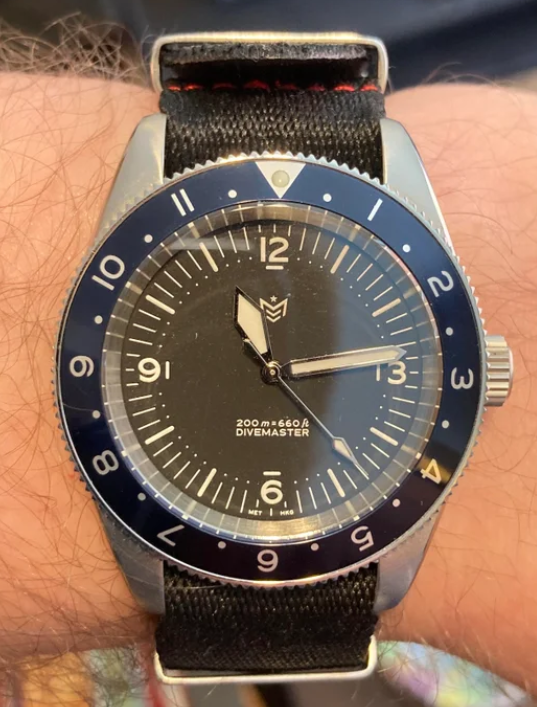

Found it, had to look at the sales post I put up on Reddit lol.
It was a Mint Evolutive (https://mintevolutive.com/) diver:
I bought it in the immediate aftermath of my watches being stolen, since the only watch I had left was the steel-and-gold Speedmaster Apollo XI 50th I was wearing that Friday, and I needed something casual and beater-y. This fit the bill as it was no-date, 40mm and only cost something like $300, and had a nice Black Bay look to it (this was before the BB58 Blue). Great watch, but as I started adding more divers I just didn't need it anymore. Definitely recommend as a beater though!
