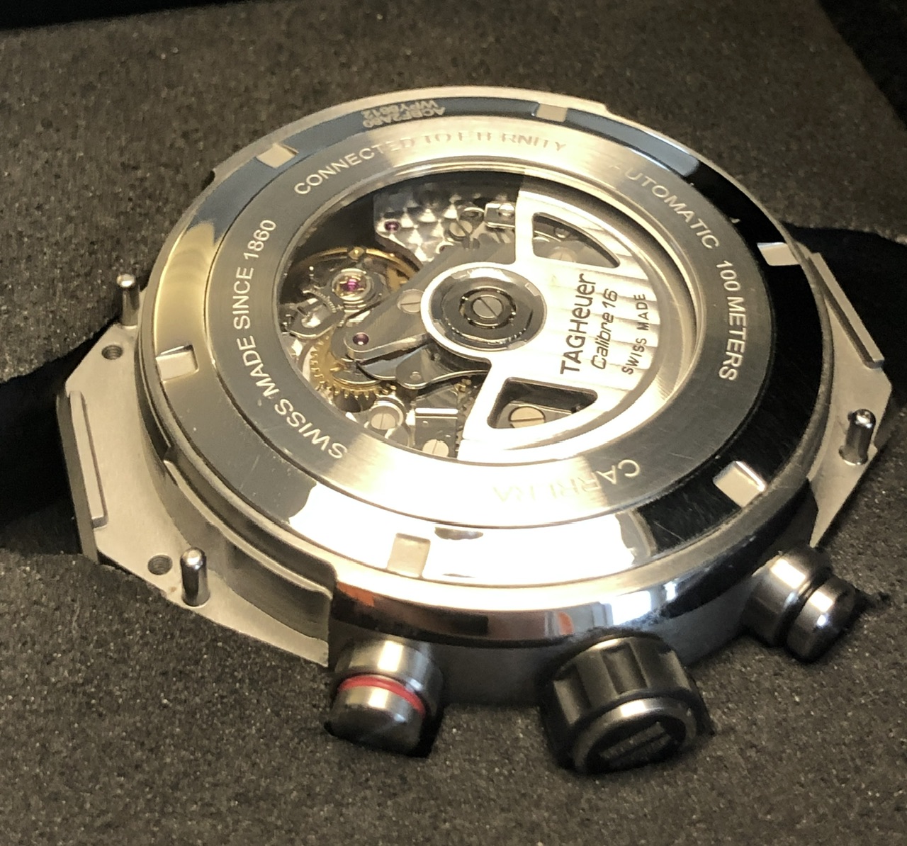

To know what is inside the Calibre 5 module we need to remove the caseback, for sure 😉
But we can directly see what is inside the Calibre 16 module 😀
It was not easy to spot, but I found the ETA logo here 👍:
And also the '7750’ stamp:
The Calibre 16 by Sellita would have the Sellita logo and 'SW500’ instead.
It was a nice surprise 😀, because being a watch from 2018, I was afraid it would have a Sellita movement due to restrictions on sales of ETA movements to brands outside the Swatch group
I have just checked my connected cal16s also, they also show eta 7750 25 jewels also. That is a very nice suprise also.

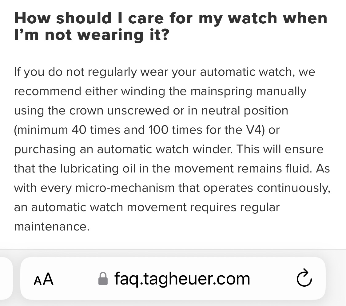

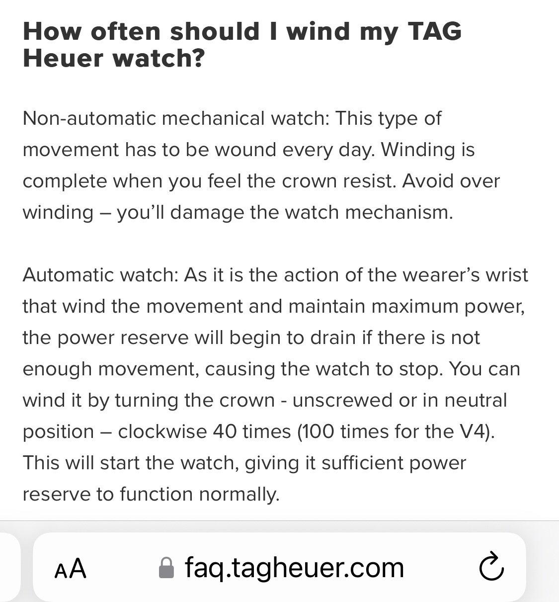

I was just following the instructions from the watch manufacturer 😟 😉
But I only started to hand wind it when the watch winder was not enough -even at the maximum TPD setting, which is twice the prescribed TPD for this movement- to charge it. So something was starting to not work properly in the Sellita... possibly it was asking for lubrication, since it had never been serviced since new, and it is 6 years old. Anyway, it doesn't seem normal to me that it suddenly stops working 😒, and for this reason I went for the new ETA movement instead of servicing the old Sellita in which I have no confidence after this experience.

Maybe I’ve just been lucky, but I constantly hand wind my 2824s and SW200s with 25 half turns before I wear them. I must admit I am gentle but fingers crossed had no issues so far.
I have never handwound a 2824 or SW200 (that doesn’t have to power an additional module) for more than 5-10 turns in my entire live. Without ever having a problem.
No clue where these 20-, 30- or even 40-turns instructions are stemming from…
