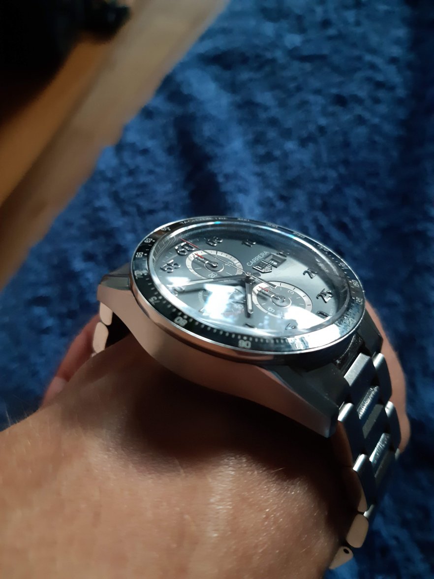

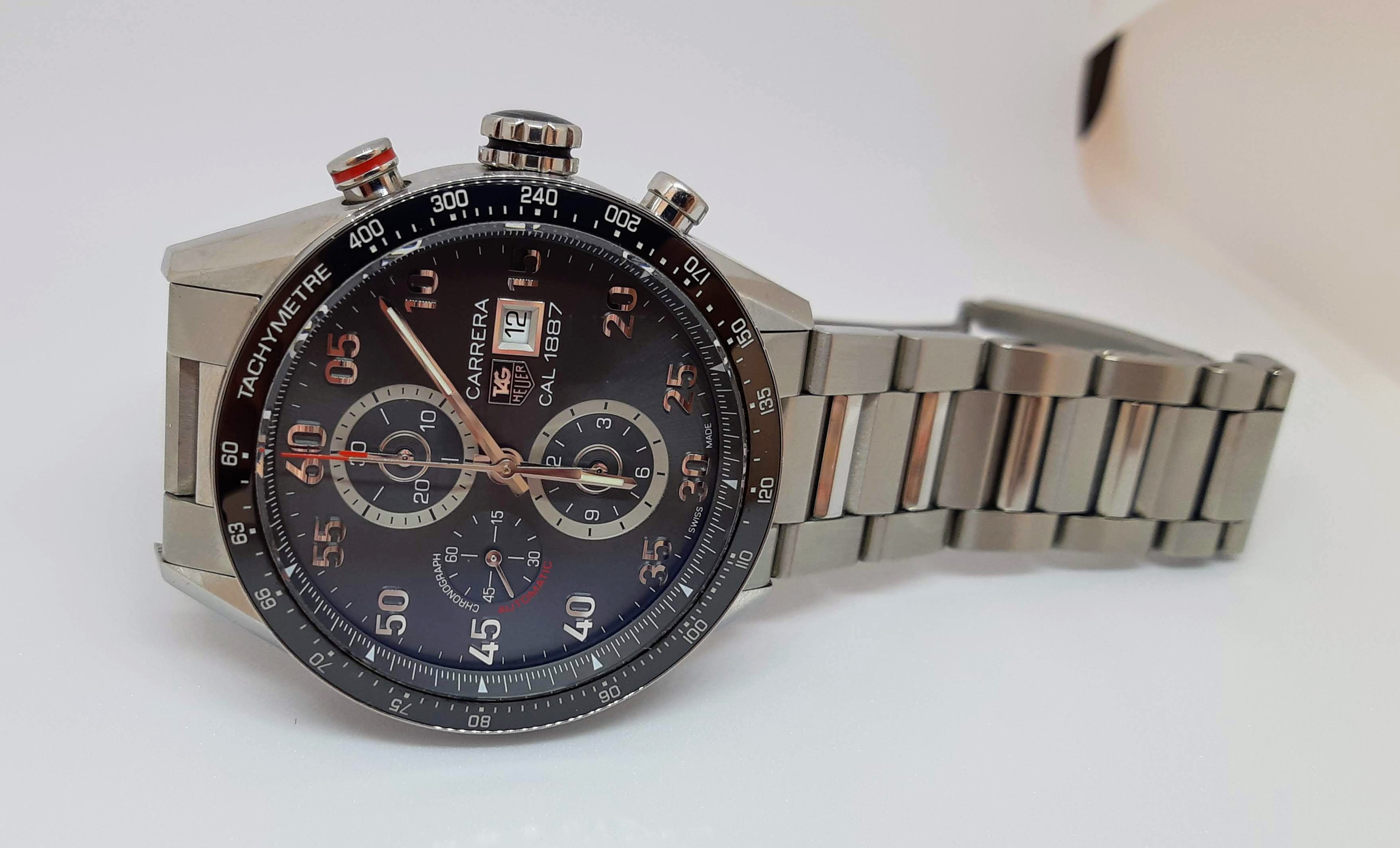

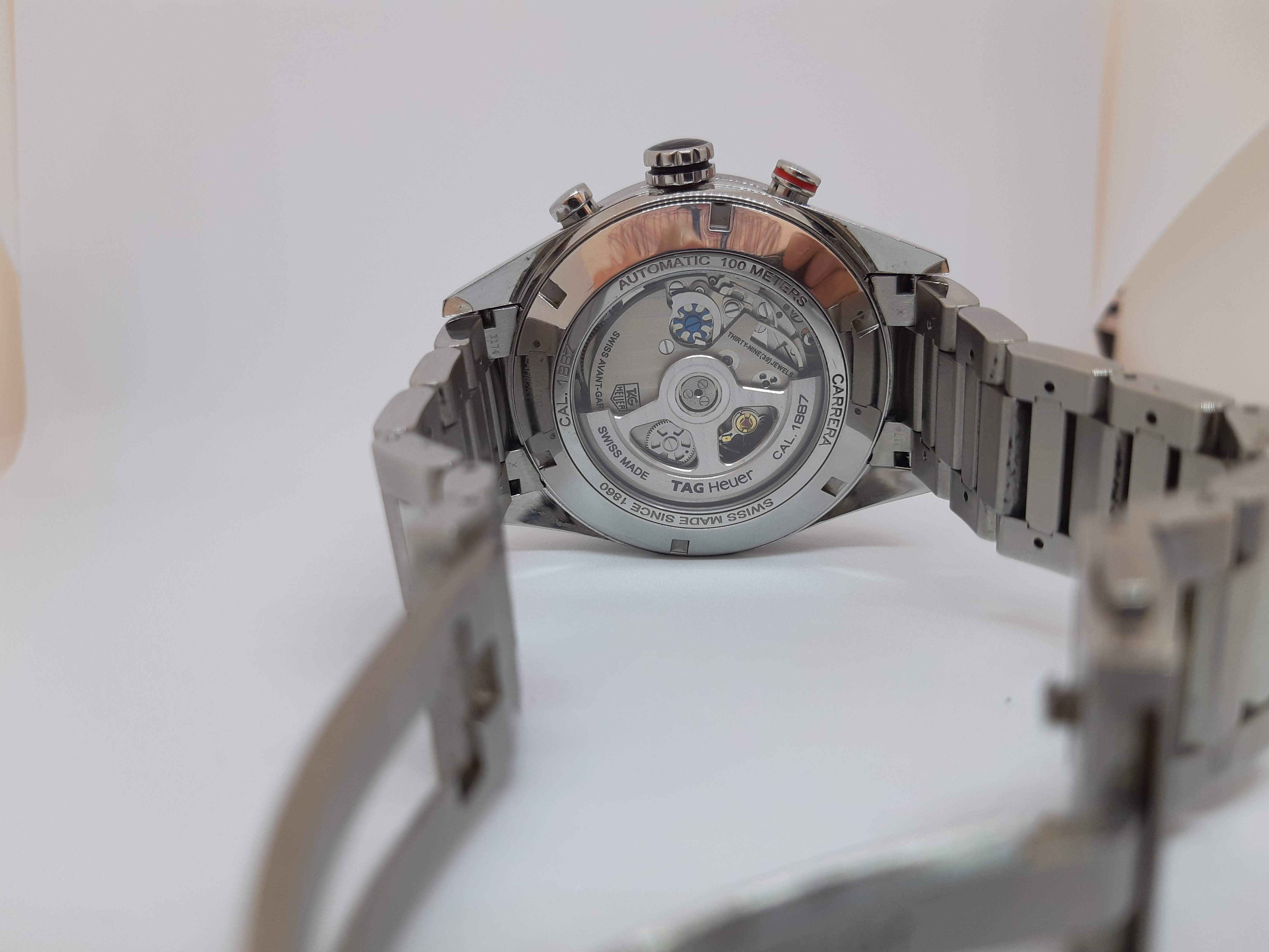

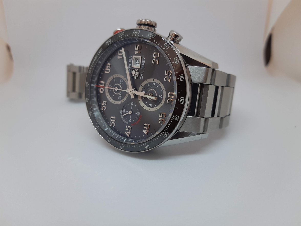

Hi Guys, have one carrera up for inspection, what do you think?
It looks fine, but I can’t be sure. Maybe it’s the picture, but the minute numbers on the dial seem more flat than in the pictures of the official website?:
https://www.tagheuer.com/en/watches...87-automatic-chronograph-43-mm-car2a10-ba0799
There are very good replicas from this watch... be careful!

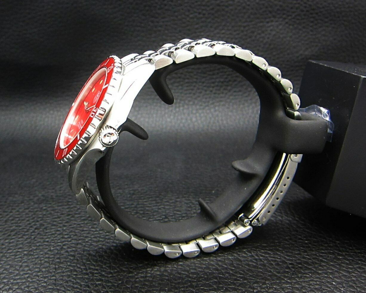

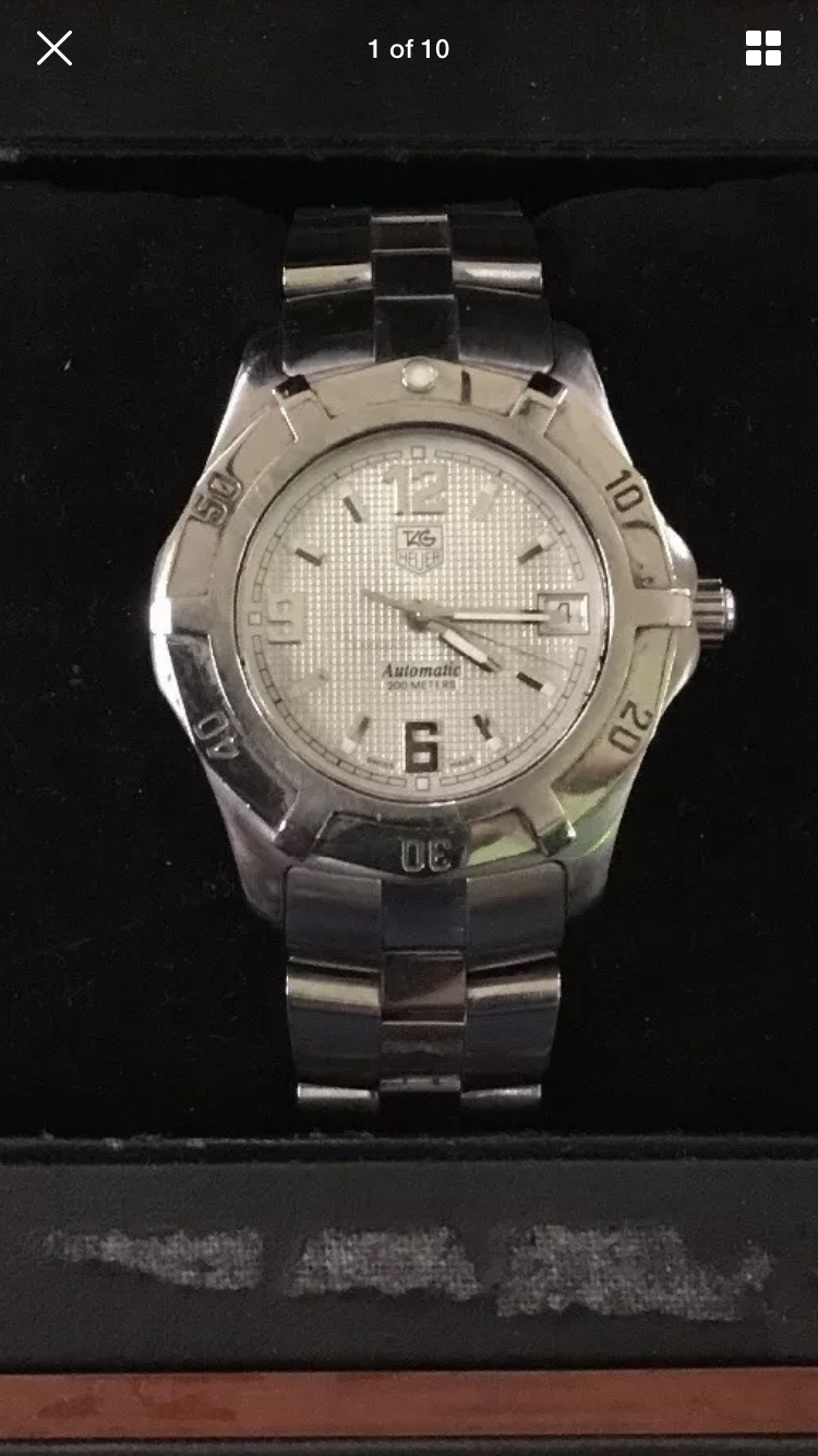

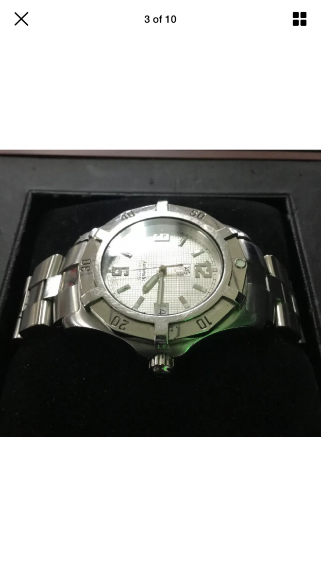

Hey guys. I found this Tag Heuer 2000 on Ebay with a great price. Can anyone tell if it is real or fake?
69
59

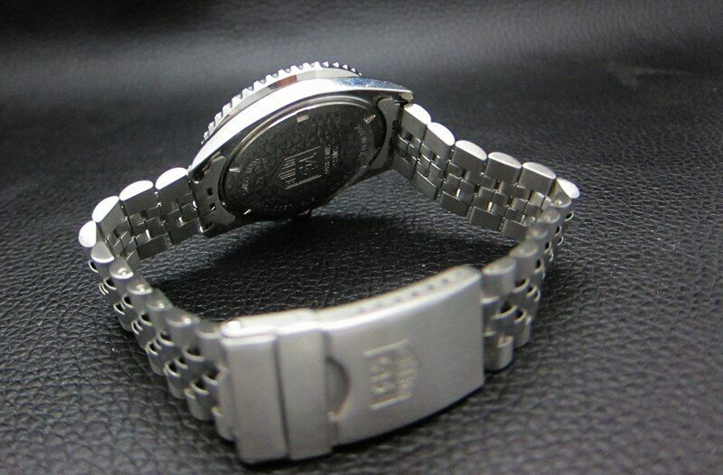

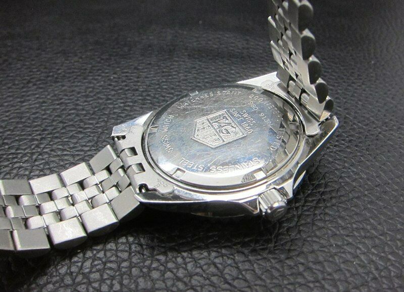

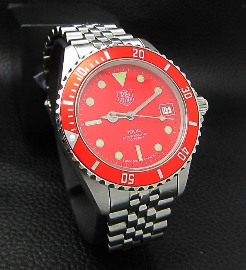

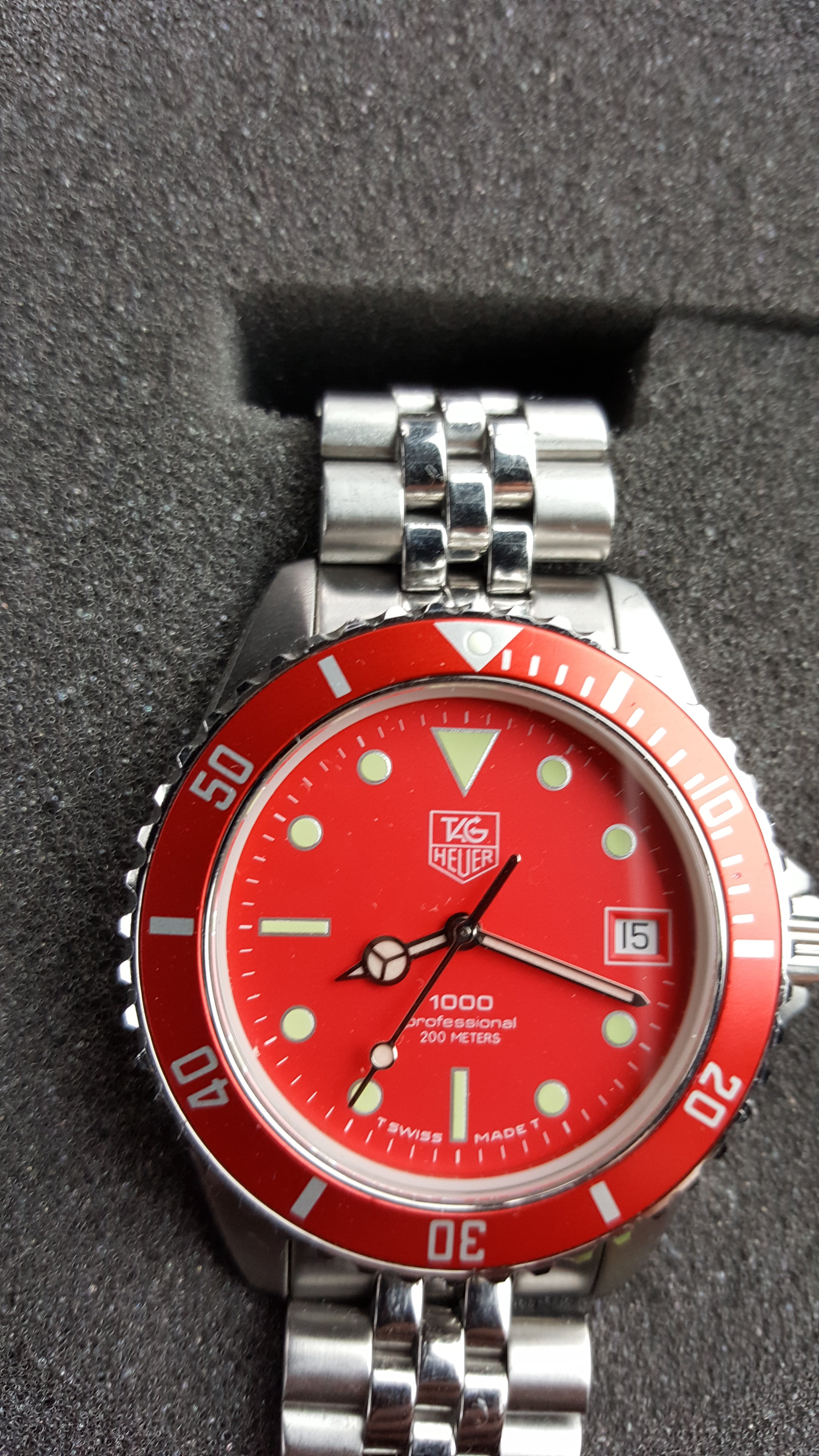

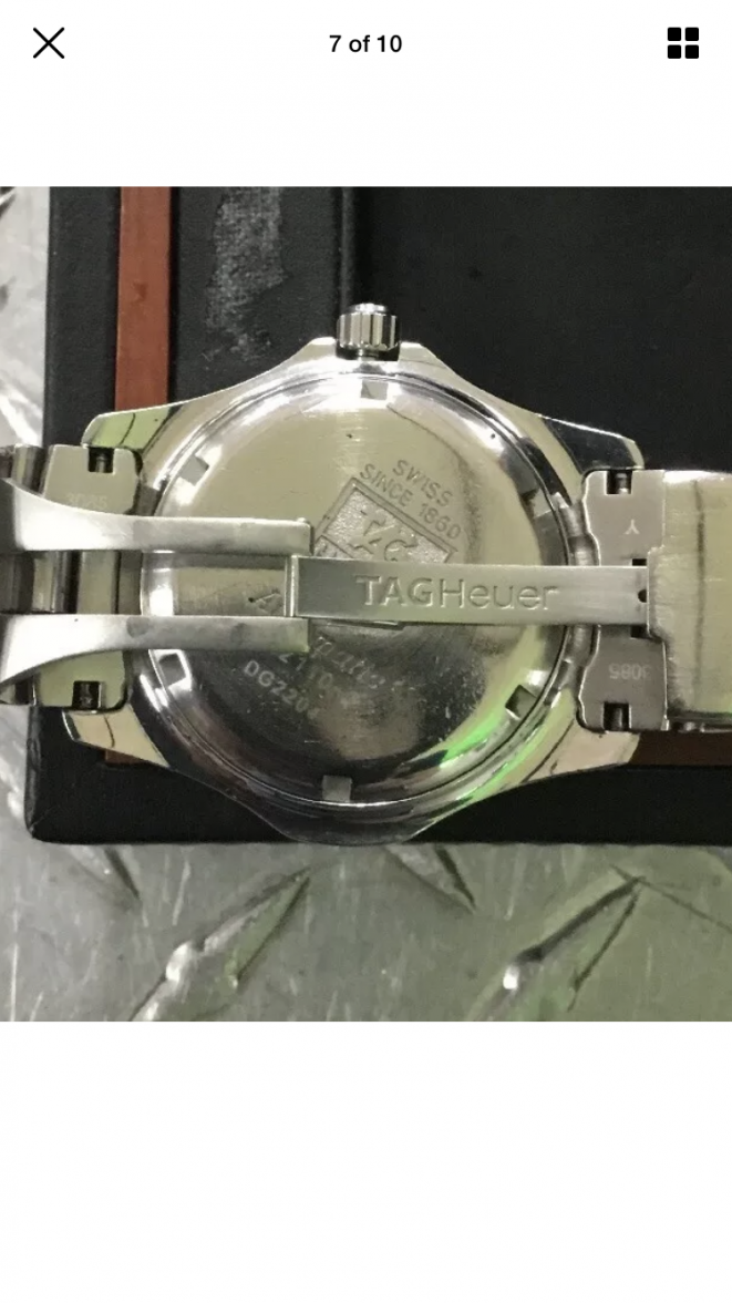

Hi, just bought a Tag Heuer 1000 980.913N and wanted opinions on if its genuine ?
there is a lot of these appearing on ebay worldwide. thanks

J jonnyv
Thanks for the reply. I did quite a bit of searching images online, and I can see the difference in colour.
However, there seems to be loads of these on ebay worldwide and I cant find any negative feedback.
I’m sorry but I would say it’s fake... also the text “SWISS WATCH” on the back case instead of “SWISS MADE” looks suspicious... but lets wait for members knowing better this model! 👍
https://www.mowatches.me/11-clone-t...h-p-724.html?zenid=ju7dvo8g1phfh8i43cc0a0ta45
Added one more pic from the side a bit, maybe this helps. Otherwise the watch is really well built, pushers are soft and runs in 10sec/day. The movement looks identical to the one I saw on the website.
Thanks!
Okay, these photos on the link are really disturbing. do you think these pictures are of the actual replica watch, and not an authentic one? i imagine they could use an authentic one for the pictures and send a replica

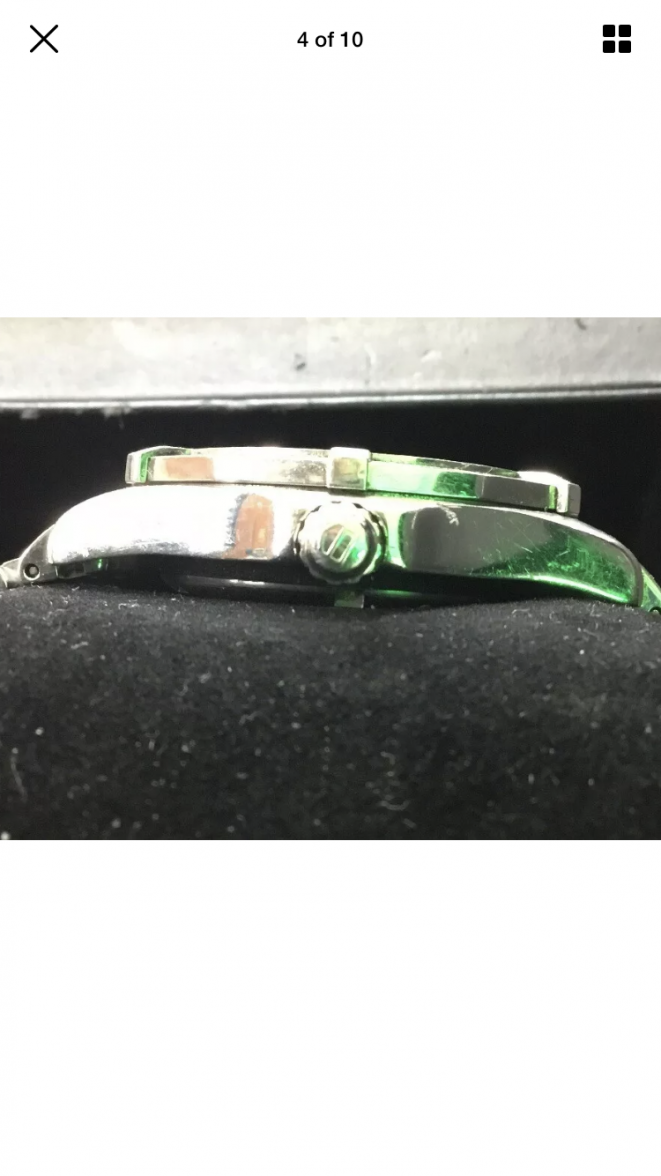

https://www.ebay.com/itm/Tag-Heuer-...ens-Silver-Submariner-202-3-Mint/153556920713
Auction linked above for same watch. guy says hes a tag Heuer collector and has 225 tag Heuer watches, watch comes with box and leaflets.
Watch and strap look exactly like mine ??
Yes, really disturbing! 👎
Pictures are supposed to be from the actual replica watch...

J jonnyv
I am pretty sure these are fake. The simple fact that there are, as you say, loads of these on ebay (and also in blue and two tone) just screams red flag. What other watch of this age and in perfect condition can you buy that easily? Plus as someone mentioned, this looks nothing like the one I featured on my blog which was sold by a guy who bought it brand new from Selfridges in 1991. I even wrote a post a while back about these watches...
http://tagheuerenthusiast.blogspot.com/2019/05/spotlight-on-suspicious-number-of.html
Here is a post about a genuine 1000, notice the difference in colour and appearance...
http://tagheuerenthusiast.blogspot.com/2018/03/spotlight-on-tag-heuer-1000-series.html
Sorry, but I wouldn't touch it with a barge pole.
Thanks for the reply. I wish I had read your blog before I bought one !
will return it for a refund.

J jonnyv
I would if I were you. If they argue it's genuine maybe point out my blog posts to them. Sorry to have to be the bearer of bad news.
