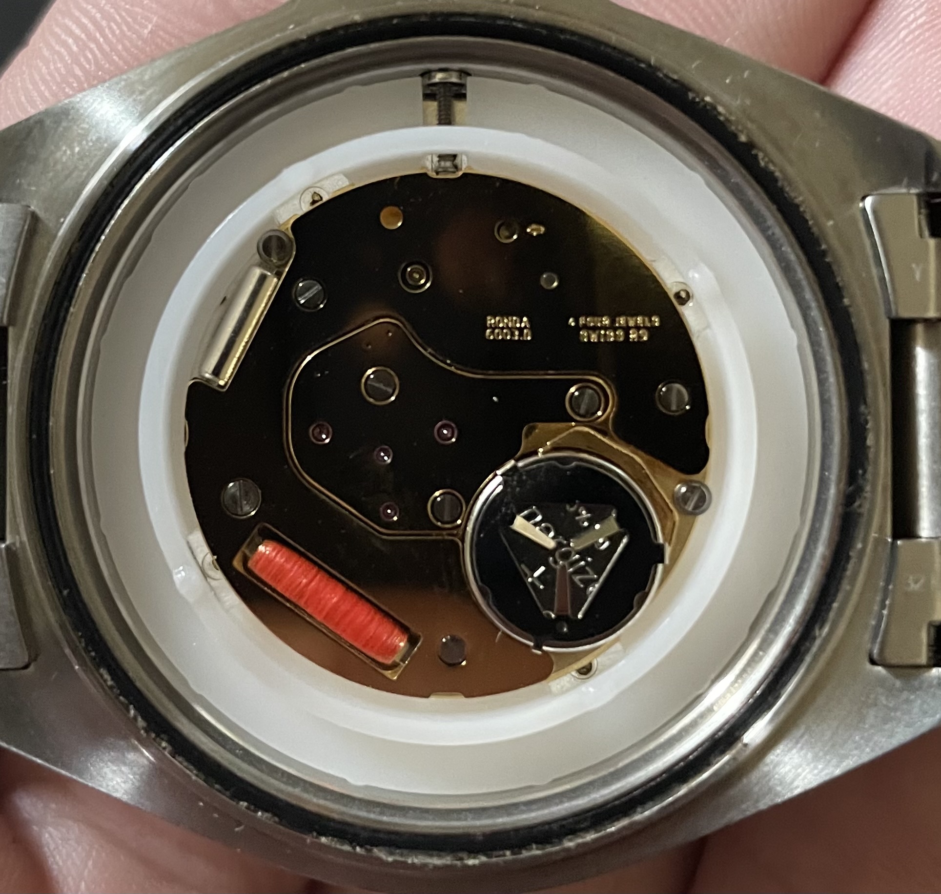

A follow up on this. Attaching the photos.
Looks like a real movement though..
206
124
That is a real movement. Looks like the bracelet use cotter pins and not pin/barrel so no tell there. Movement is real. So i would say this is a genuine TAG.
My only doubt is that the hang tag looks to be from a fake.
256
129
@de157 If those movement shots are from the F1 whose pictures you posted recently, then it has a Rhonda quartz movement that Tag doesn't generally use. Typically one would find an ETA movement in a Tag quartz watch. Now the rhonda is also a swiss quartz movement, and a good one for sure but it is missing some features normally found on Tag Quartz watches, notably the 4 second jump to indicate a low battery. My fake aquaracer had a Rhonda movement. Based on other comments showing bezel irregularities etc, I'd say your F1 is fake.

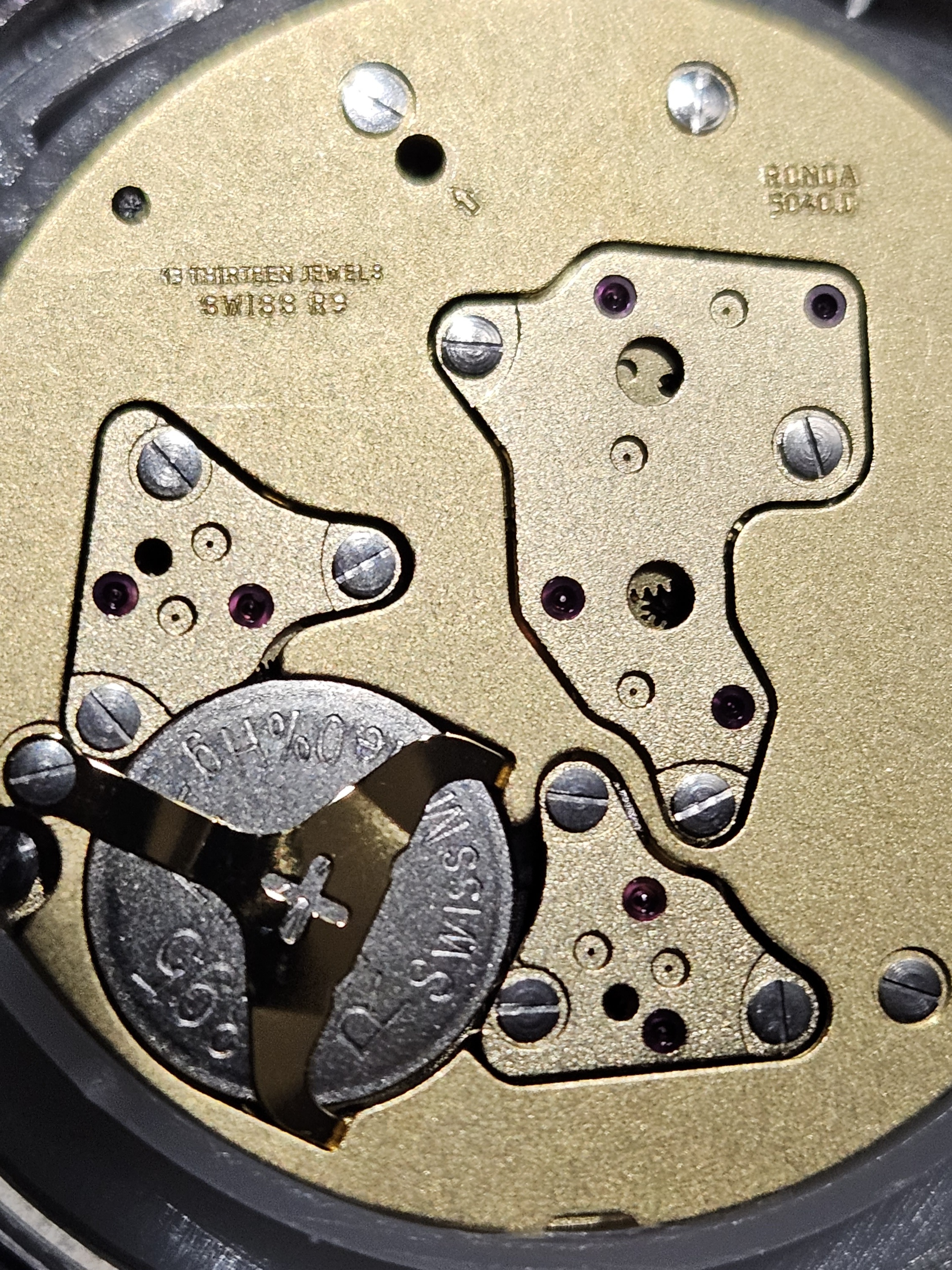

WRONG !!
Newer F1 use gold Ronda 5040D
Fakes Use Silver Ronda 5040D

WRONG !!
you're a couple years behind. Every year, they are getting better. Just like serial numbers are almost all now valid and for the correct model. I have multiple fakes with gold ronda movements. Chrono and non chrono. And as far as I can tell, they all that cheap looking white movement holder. And so far, none of them have movement holder screws, but at the same time, the movement posted above, has screws that look nothing like OEM, at least from the angles he showed.

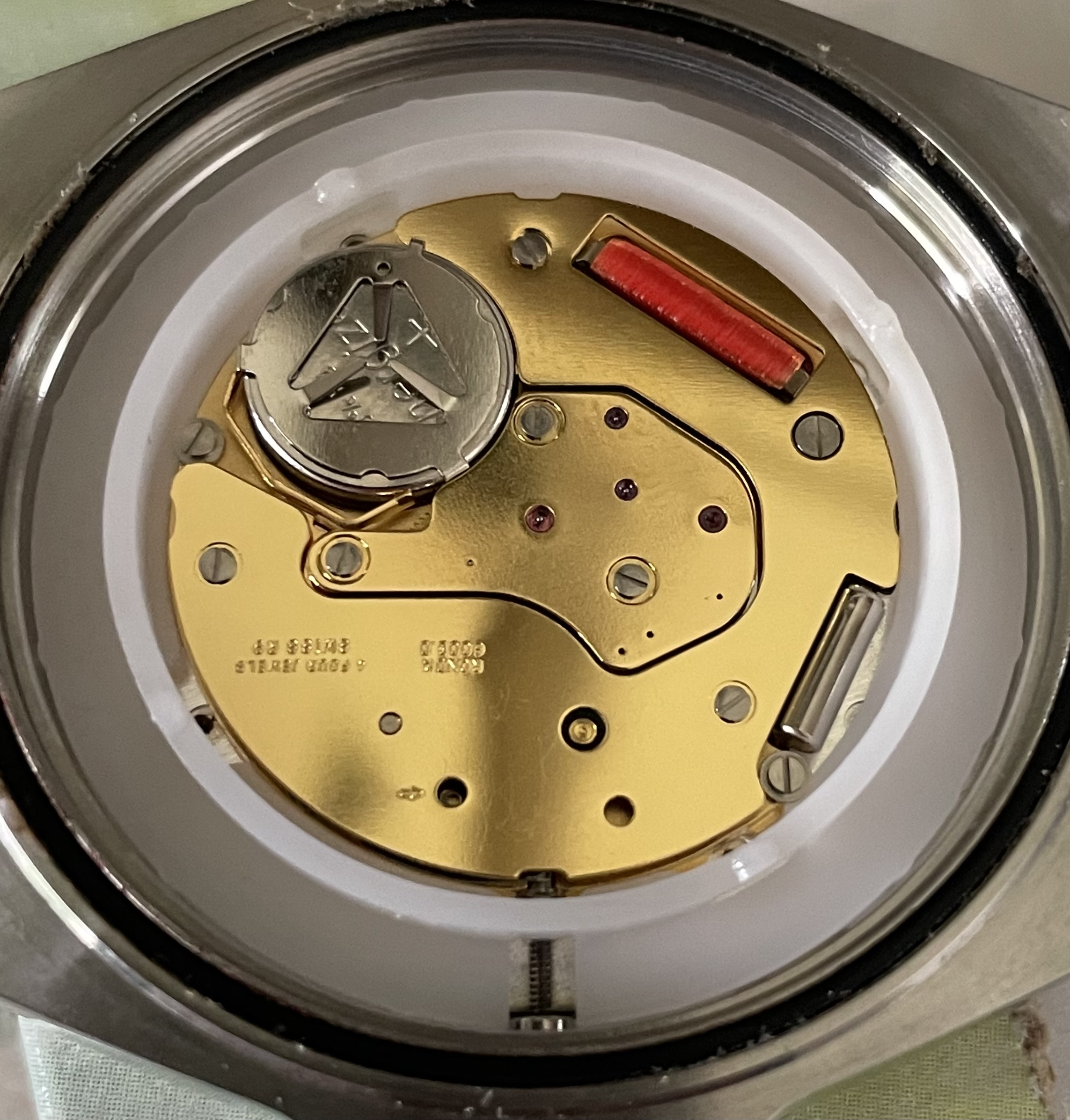

I was looking at those screws… also, that spacer doesn’t look like the solid white or solid black, smooth one that TAG uses. I’ve never seen that, and there are what looks like tooling marks in the plastic??

WRONG !!
I stand corrected. That F1 is an obvious fake though.

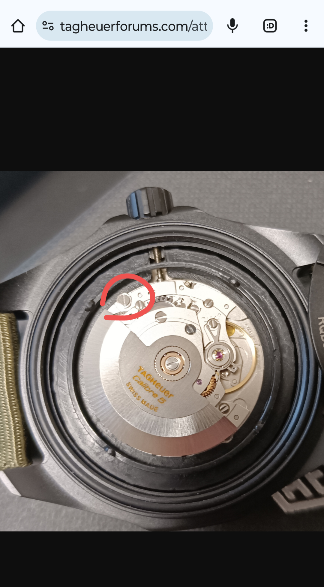

If I understand correctly, this screw should be like this
yes but also no. The fake AUTOMATICS do have screws, such as that one. Having an automatic movement be loose, will be a problem real quick. Quartz don't have screws because it doesn't really matter.

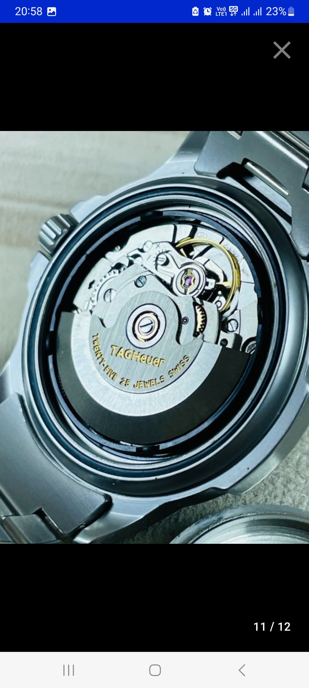

Have you seen any fake quartz TAGs with screws yet? I want to order a rep at some point to inspect it, but it’s still a chunk of change to spend on something that I despise lol.
