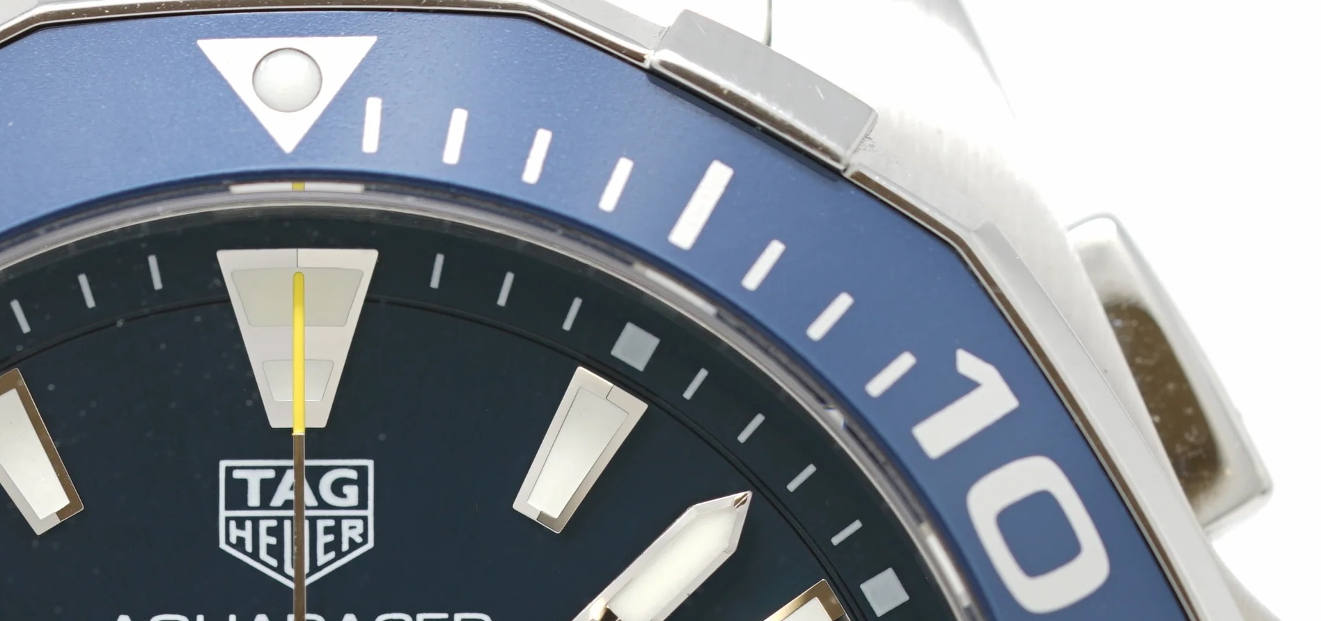

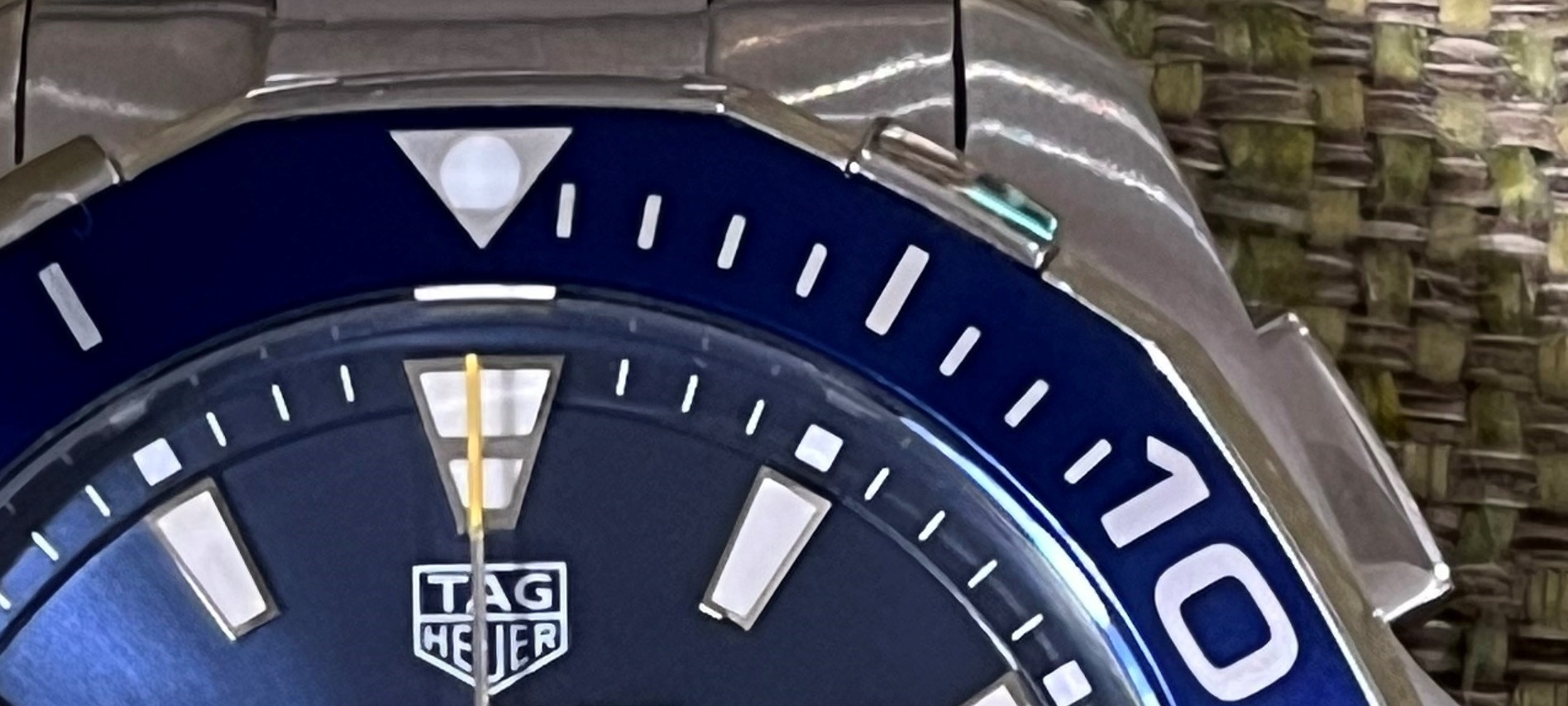

Here's your dial and bezel (top), compared to an authentic one (bottom).
Three things jump out as wrong on yours:
1. Your lume pip sits on top the triangle, the real one is embedded. Plus the lume pip on yours is bigger, the real one is smaller.
2. Your bezel hash/timing mark at 5 minutes is centered equal distance from the bezel's outer and inner edge. The real one is positioned closer to the inner edge, next to the dial. All of the bezel hash marks on the real one are positioned closer to the inner bezel edge.
3. Your TAG Heuer logo is very sloppy. The real one has clean and sharp printing.

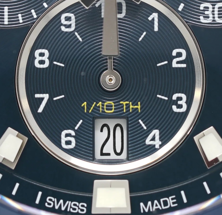

Same sloppy printing on your dial. Look at the Numbers and SWISS MADE on yours (top). Compared to the real one (bottom), which has clean and sharp print.

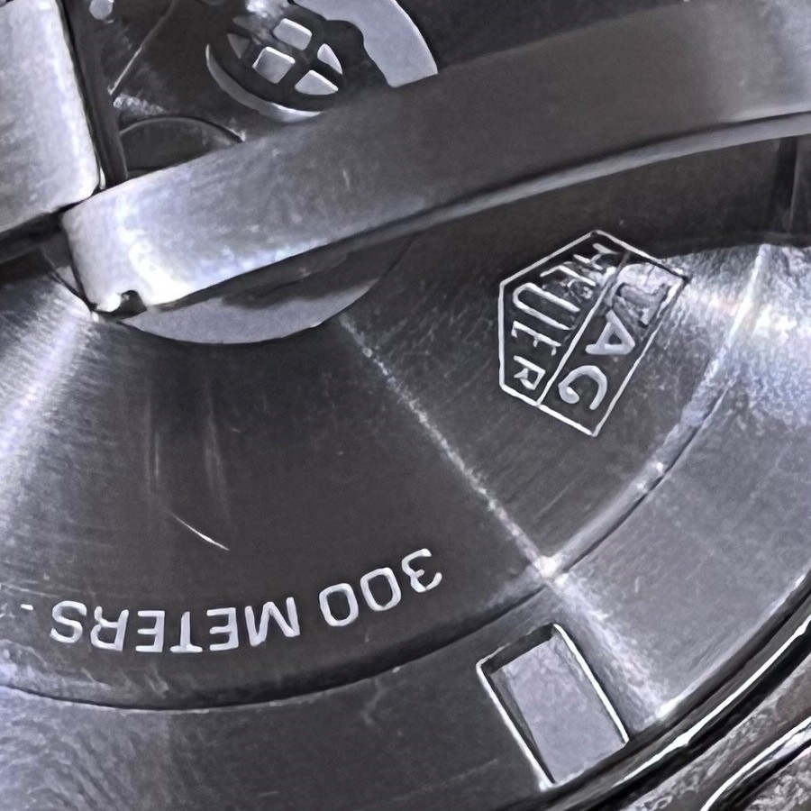

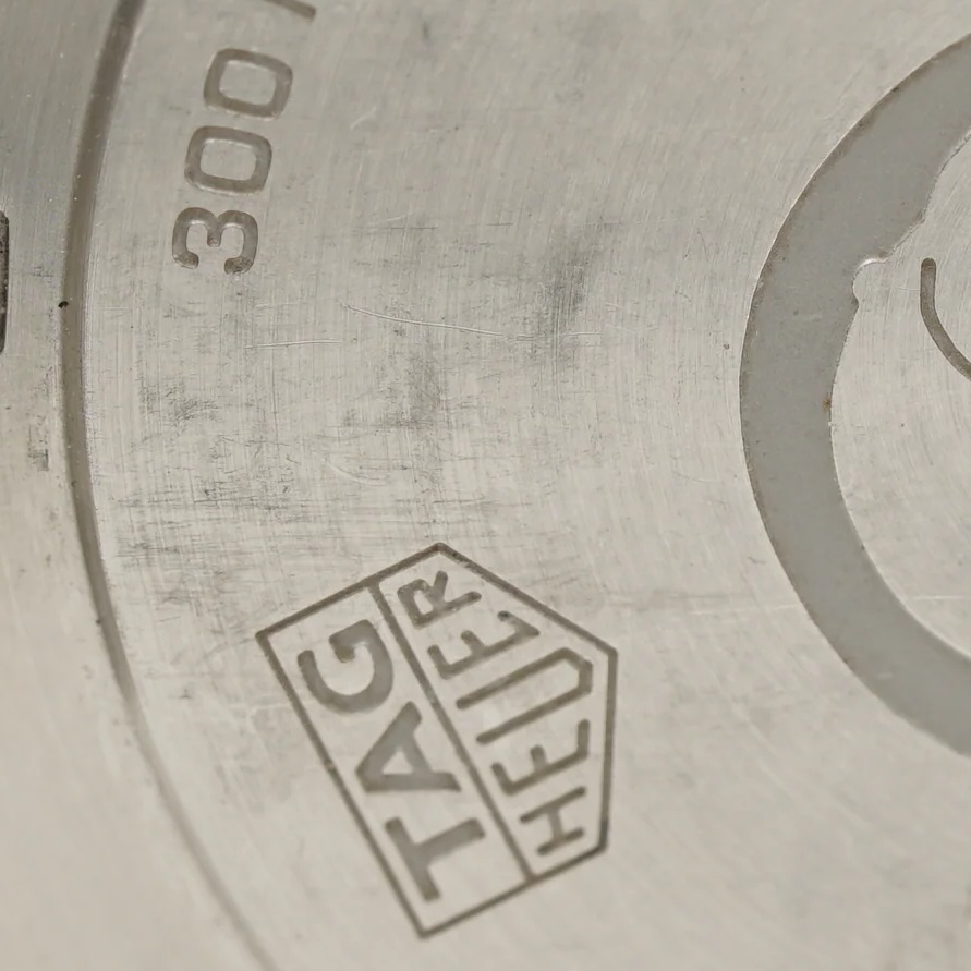

Then there's the caseback comparison. The difference between the TAG Heuer logo on yours (top) vs. the real one (bottom) is night and day.
