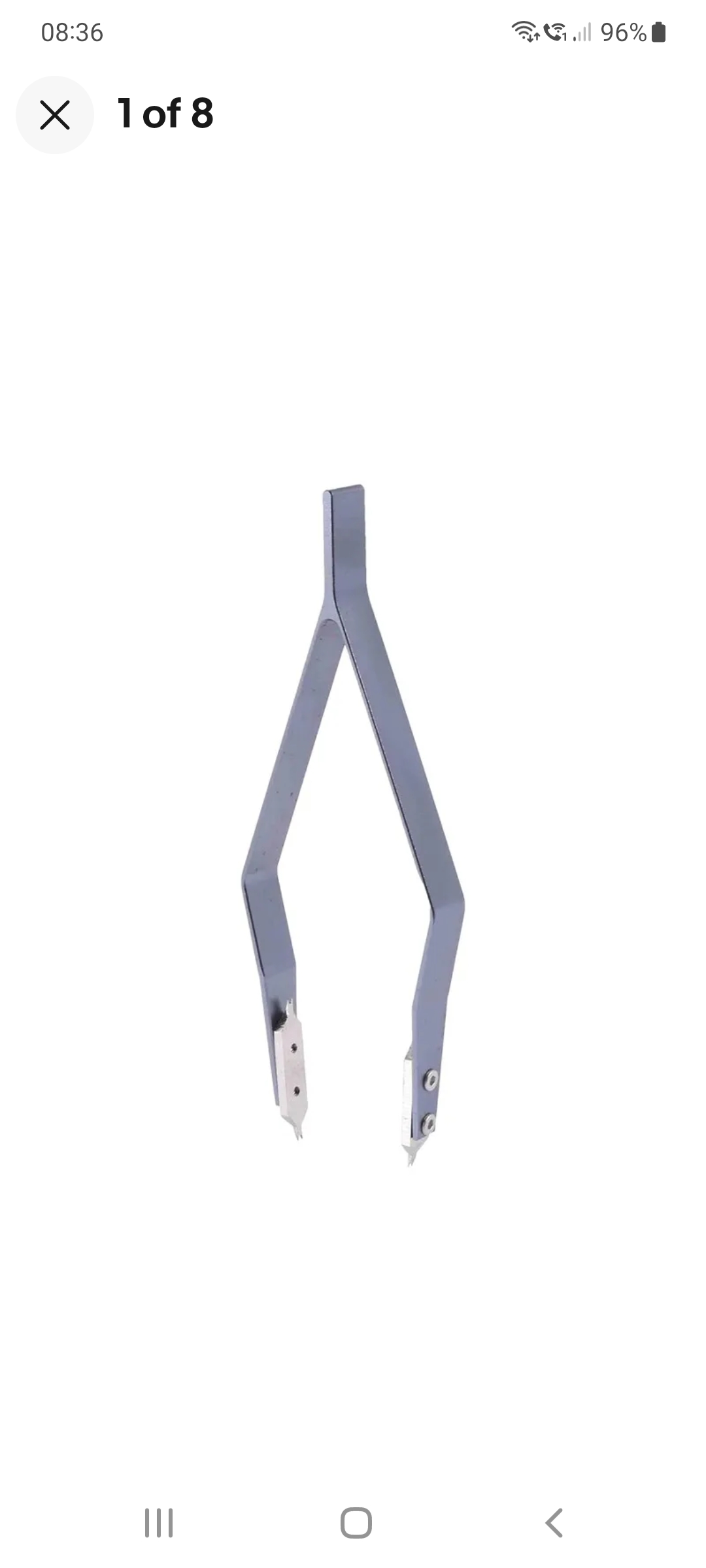

It probably is possible with a normal spring bar tool but very fiddly and scratches are easy. This type is probably what you want
145
173
yeah I think that’s exactly what I’ll need. Will get one ordered and have a try
