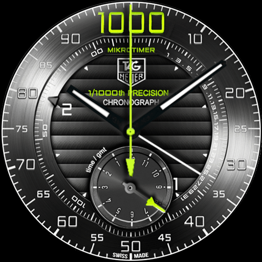

https://www.dropbox.com/s/k7bfdpwx4dgmmdl/TAG HEUER MIKROTIMER.gwd?dl=0

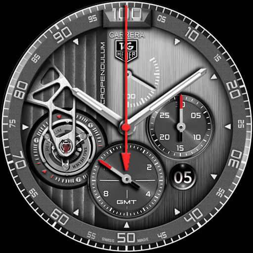

Para esta esfera he hecho unas pequeñas modificaciones que son de mas utilidad para mi caso.
En la parte izquierda un marcador triangular indica el nivel de batería.
En la derecha, la aguja blanca marca el día del mes.
En la mini esfera esfera inferior hora GMT.
Dobles toques en los puntos cardinales de la esfera y en en centro para acceso a:
-calendario
-alarma
-cuenta atrás
-cronometro
-salud.

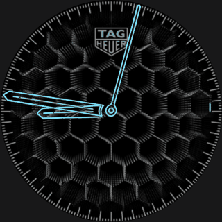

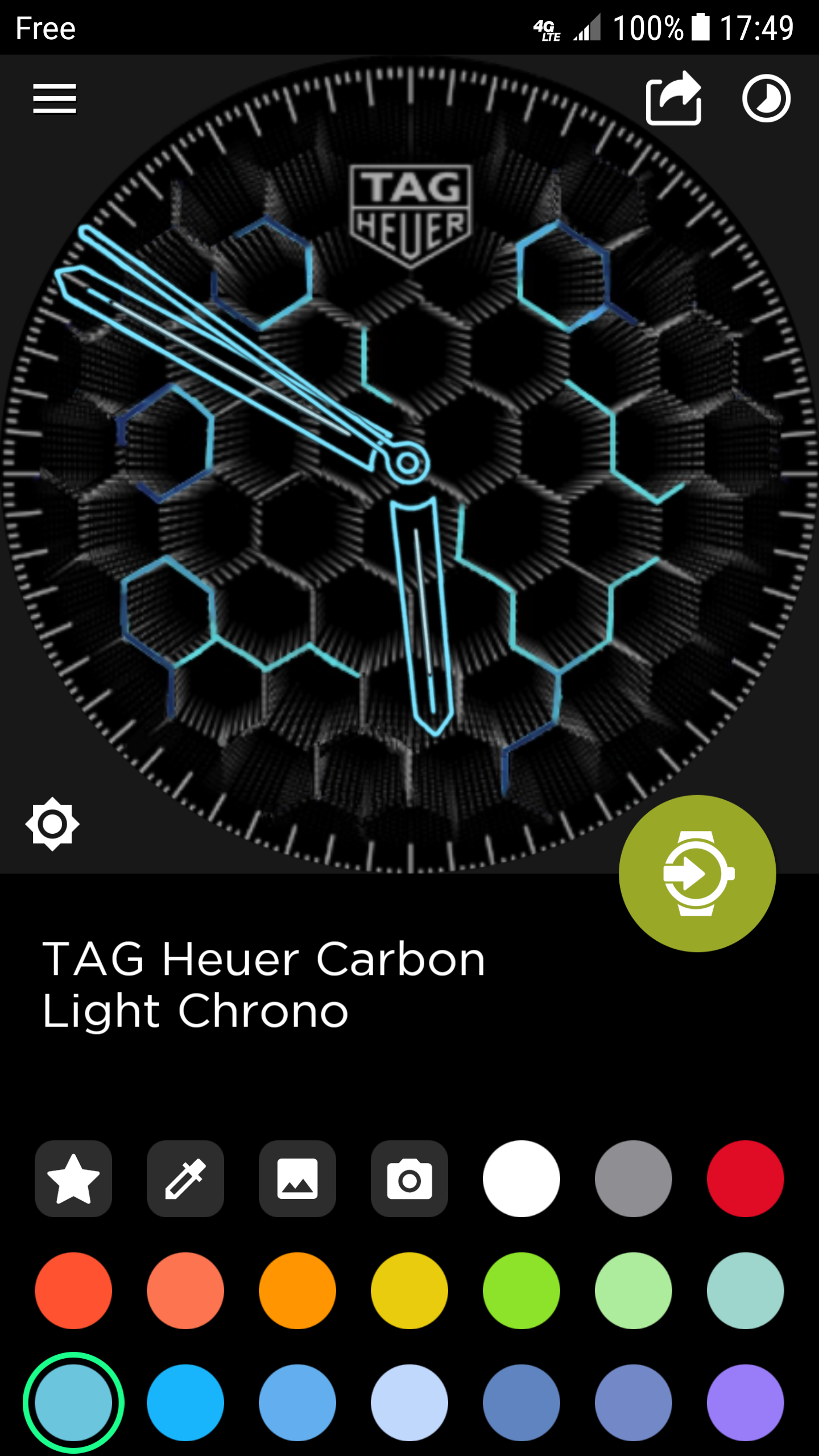

I don't have a TH Connected yet and I finally decided to create a GIF inspired by the "Carbon" face I love for my watch.
I took the file posted by Connected1976 in april 2022 and used Photofiltre to create 50 images to simulate movement for the GIF. It was long and it's not perfect.
If anyone wants to improve it or post the face with the real GIF of the TH Connected I would be interested!
https://www.dropbox.com/s/q58kvu3kqxw6301/TH Carbon With Light Cool V1.watch?dl=0
Cheers

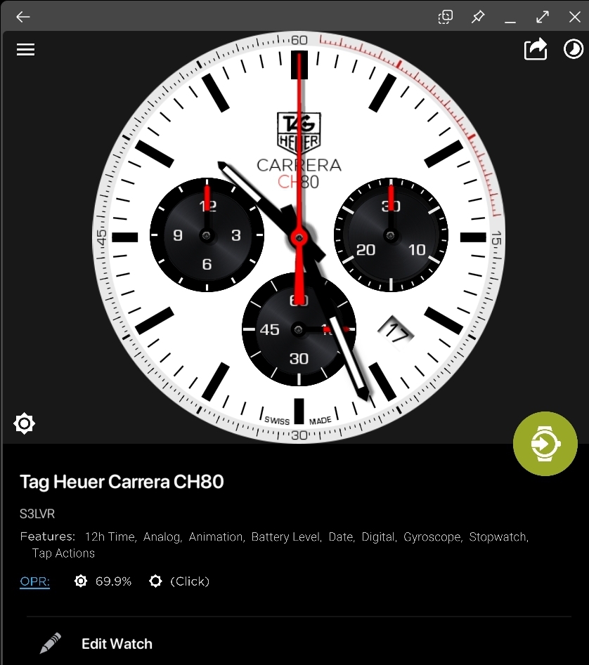

D'accord. Devenir accro 😀! Mise à jour des mains, de la police et essayé de coller aussi près que possible de l'original.
https://www.dropbox.com/s/fxnaxmlxbdwfesm/tag-heuer-carrera-ch80.watch?dl=0
Pour que ta montre fonctionne comme l'original ajoute pour trotteuse
math.floor({drss})
Pour le compteur minutes
{swrm}*2
pour le compteur heure({swh}*6)%360
Là tu auras un chrono juste ce sont des valeurs a changer dans toutes tes rotations

Hi Philippe, your replay came through as French and unfortunately I don't speak it but I think I understand what you mean through Google Translate. I've tried out the changes and looks good.
If anyone is interested, I've incorporated and made some slight adjustments to hour maker and etc., https://www.dropbox.com/s/e5n1u4mcp82o1n9/Tag-Heuer-Carrera-CH80 (1).watch?dl=0

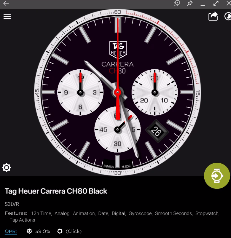

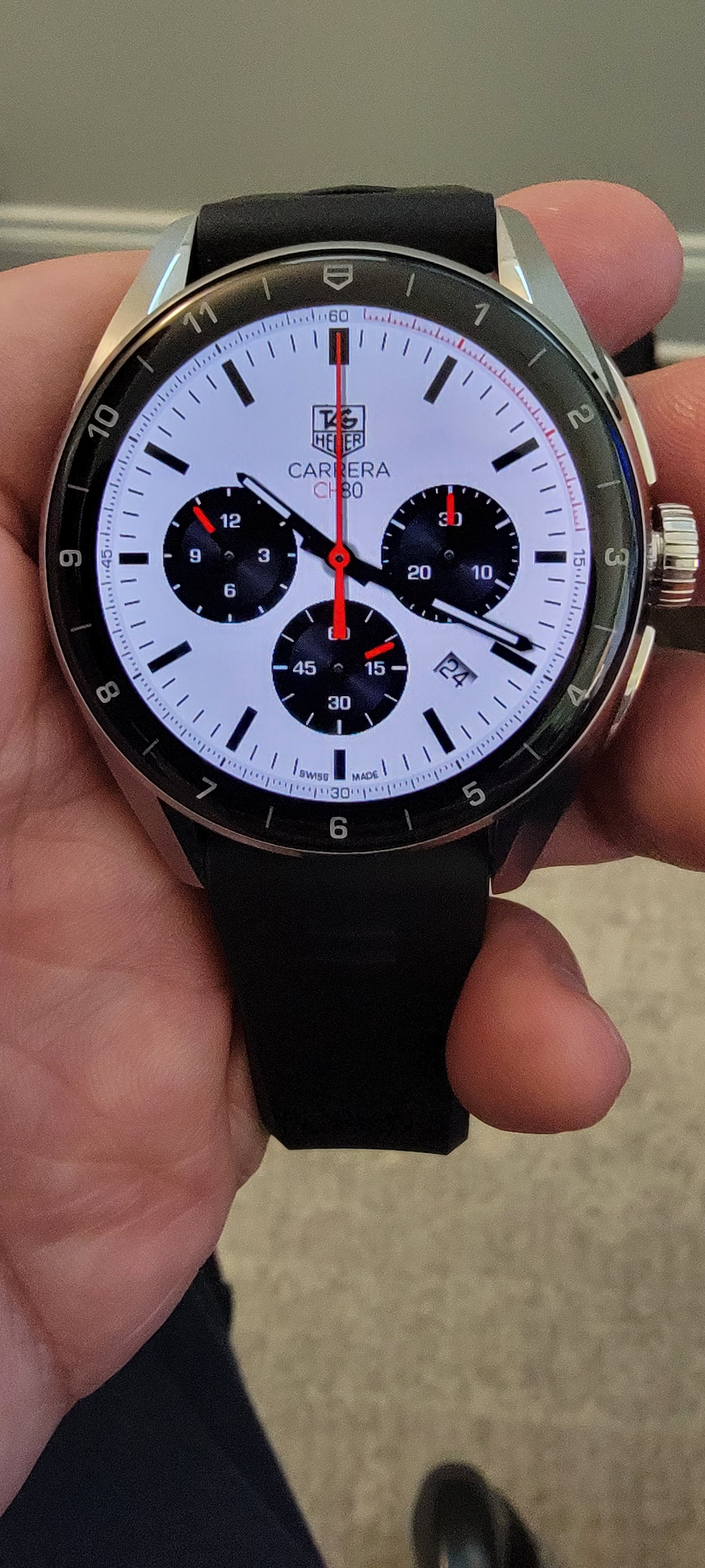

Hi. My latest Tag Heuer Carrera CH80 creations.
This was my original but updated, https://www.dropbox.com/s/qwi1hnj3k1mbrqe/TagHeuerCarreraCH80-1.watch?dl=0. See previous posts to see what it looked like.
These two are new with alternate faces/hands.
https://www.dropbox.com/s/02qac57dyvk9ff7/TagHeuerCarreaCH80-2.watch?dl=0
https://www.dropbox.com/s/7i0ogywy65m4a26/TagHeuerCarreaCH80-3.watch?dl=0
A shout out to Philippe for the help!

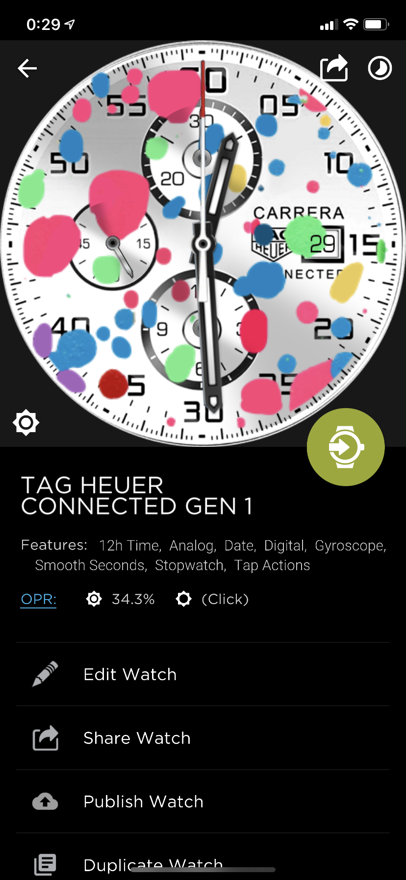

Its possible added zoom??
