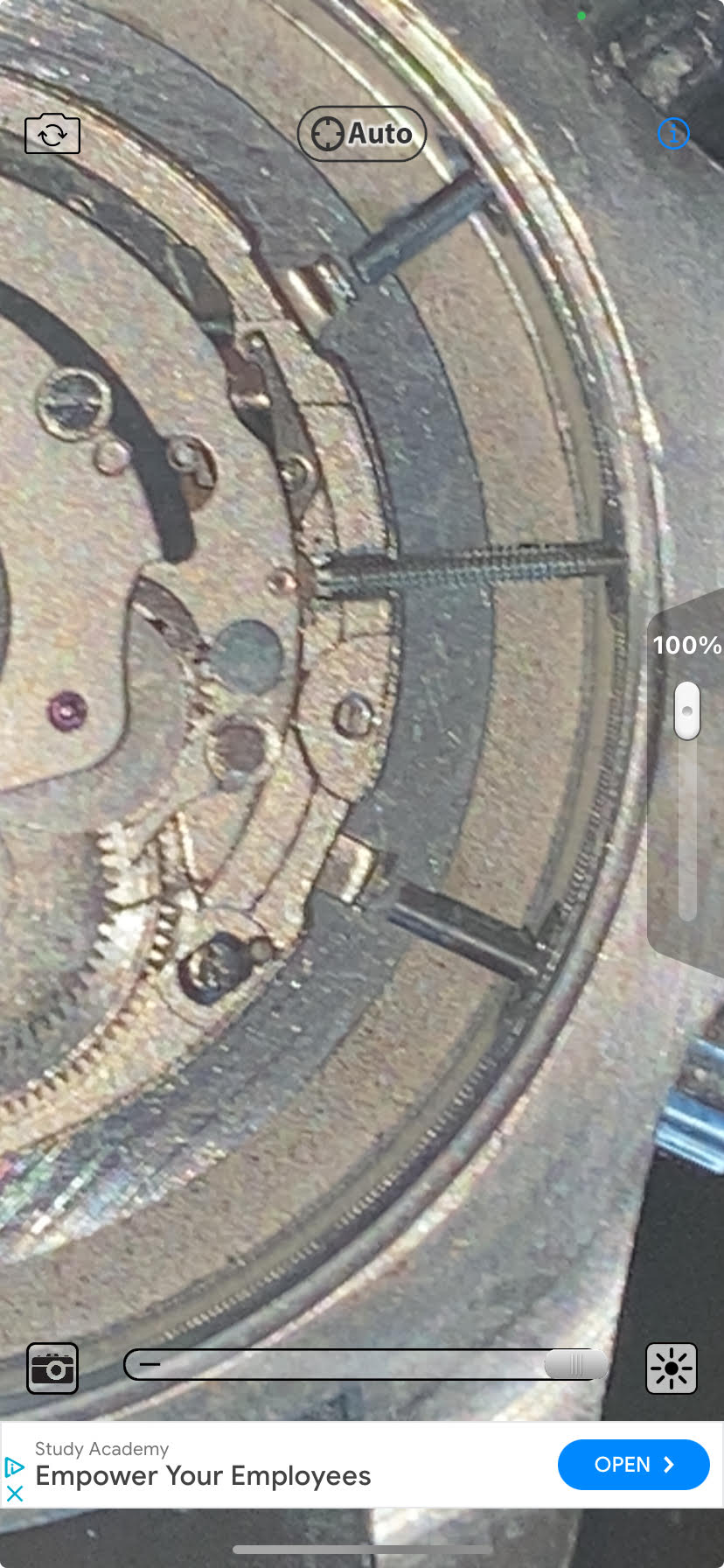

Carrera stem removal
Can anyone help me remove the stem on this Carrera watch. I believe there is a release mechanism but its not clear where it is!

Can you take a photo of the full movement?
It could be the photo, but that doesn’t look like a carrera movement.
Agreed - would be interested to see the rest of the movement.
Circled in red appears to be a dimple on the end of the lever - pressing this down while the crown is in the 0 (winding) position should release the stem.
Disclaimer: the picture quality isn't great, and it's not definitely correct.
