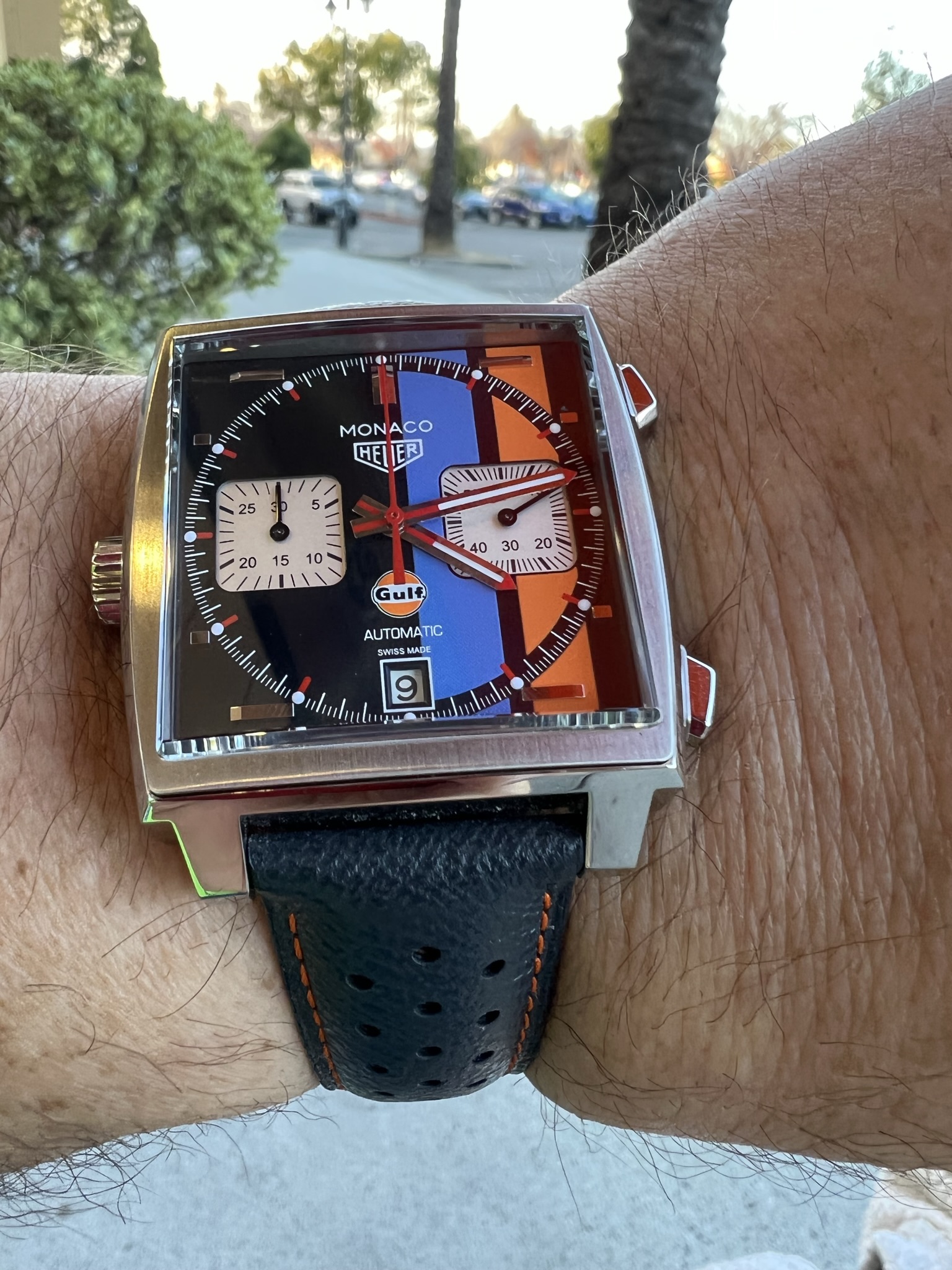

So here's the watch:

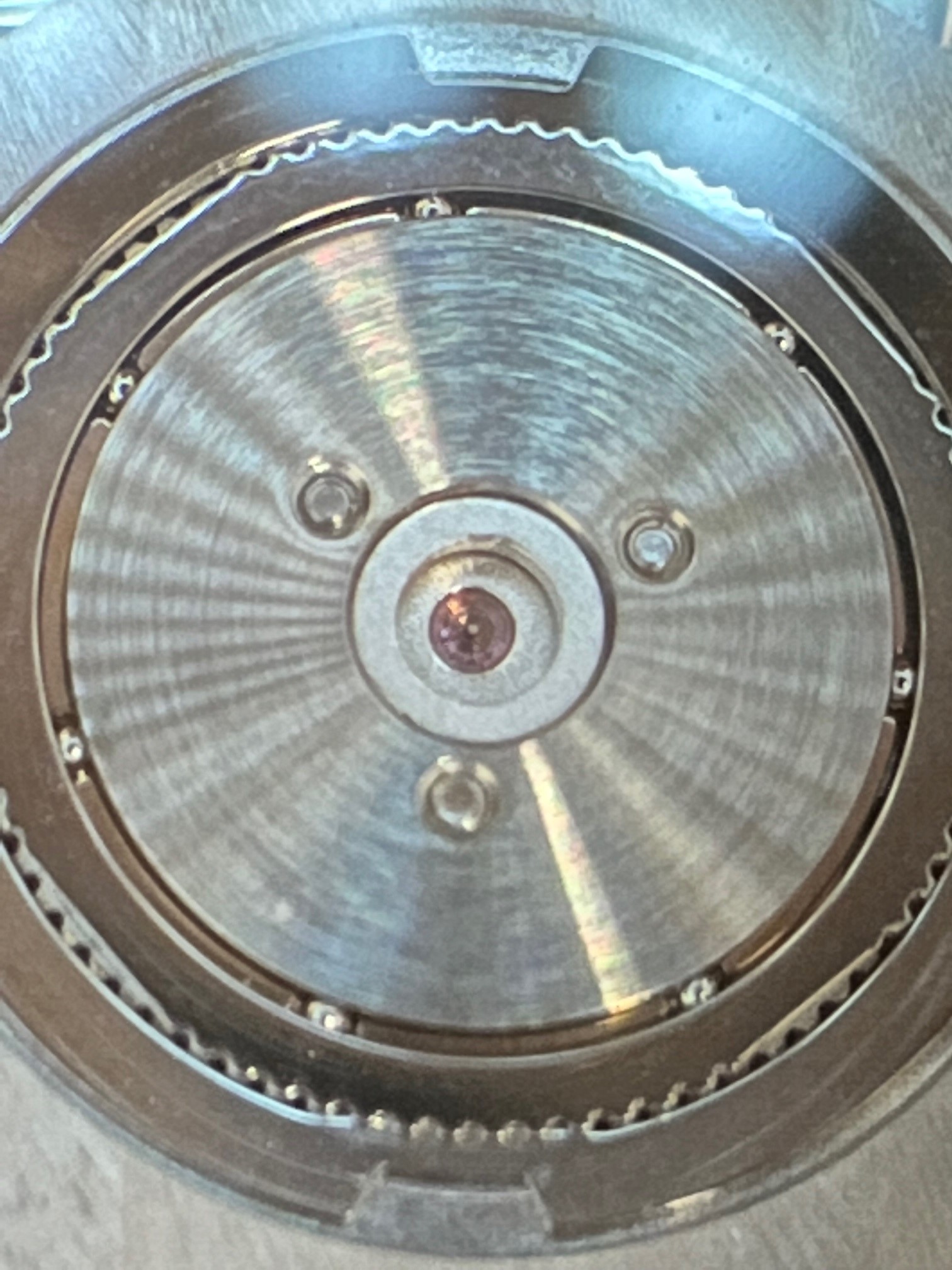

First the movement. It has a display caseback so no warranties were harmed in the making of these photos. The rotor bearing (and the base-movement center seconds hand upper bushing):
At close zoom, I could see the seconds hand pinion turning; note that this gear always turns and it's the one that drives ALL movement in the chrono module (well, except the date ring).

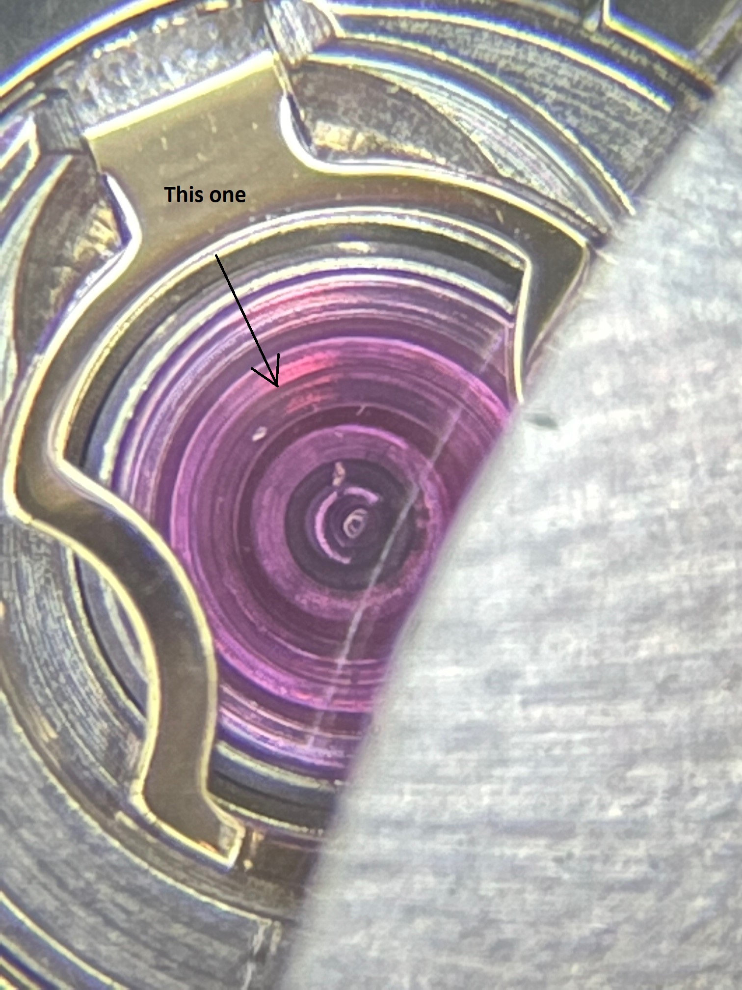

What I was really interest in:
I'm looking for the outline of the oil reservoir as I mentioned above. While it's easier to see with stereo, inside the boundary appears wet and outside appears dry. It's actually the meniscus between the bushing that's domed on the upper side and the flat-bottomed cap stone. The space widens as it moves away from center, and a proper amount of oil will fill it to about 2/3 the diameter of the jewel. If you follow it around, it's the only line that's not exactly round. So things look good on this bushing.
Wifey Watchdog's Datejust was about half the total diameter, indicting a service within the last few years (or perhaps a light touch when serviced) so no problem wearing it (but I did just purchase an authentic mainspring for the eventual service on my part).

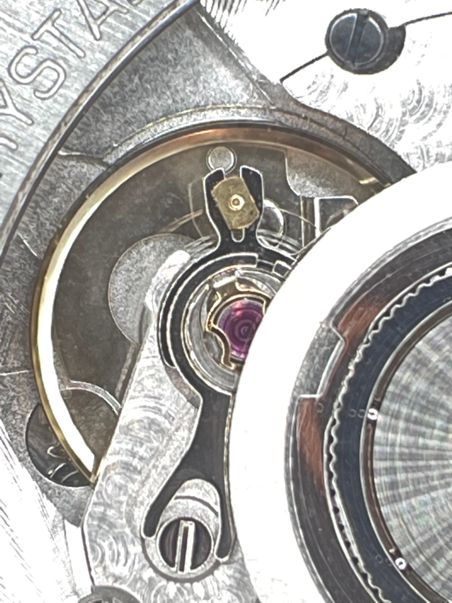

On to more movement macros, here's the balance wheel (not hacked tho):
... a bit overexposed.

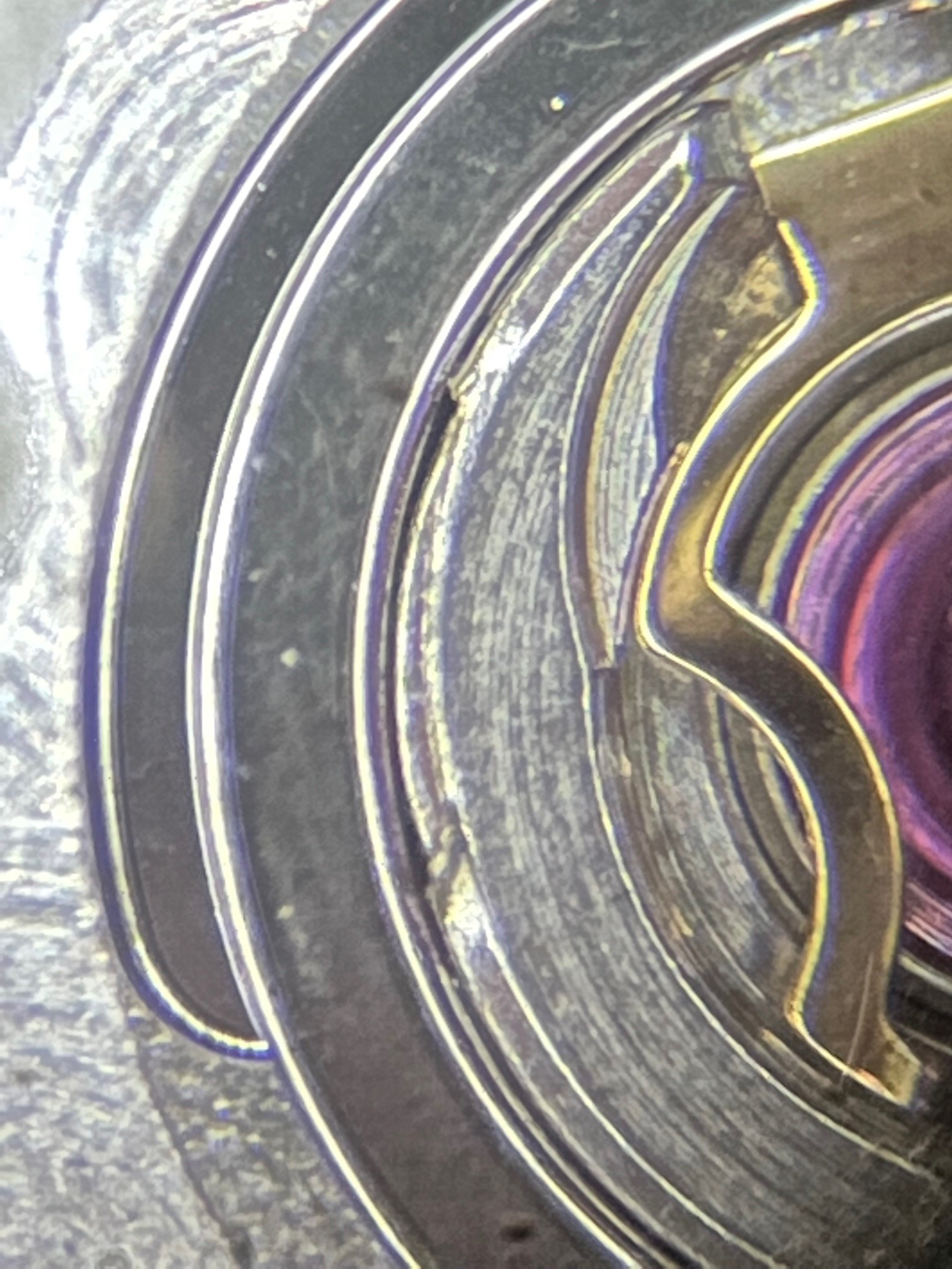

The view did reveal a little issue:
There's a nasty burr where the regulator cut into the brass boss on the cock surrounding the shock protector. It's right in the center of the pic and really obvious in stereo. There's also a bit of contamination at this level. In the shot I annotated, there's a couple nougies on the cap jewel. Nothing you can see with the naked eye but at 40x, pretty obvious.

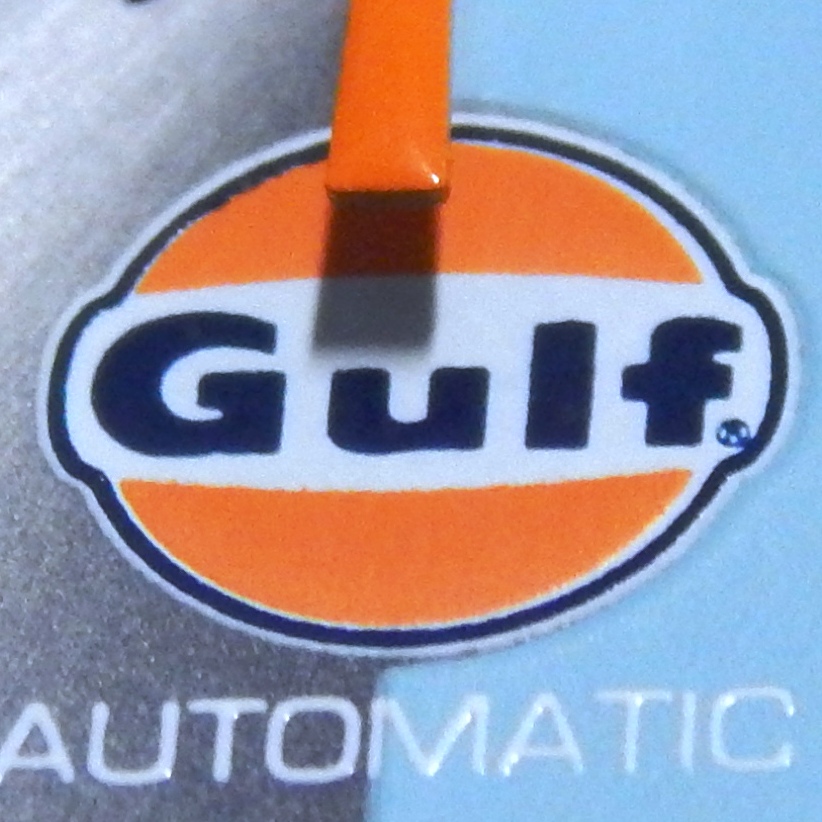

A closer shot of the logo:
Wow. What is that stuff? I doubt it's contamination under the paint as the blue stripe doesn't have it and I don't see anything on the dark blue. I suspect it's pad printed or in the base white that was the first color to be printed, perhaps to give it a semi-flat look. Again, the dial looks great to the naked eye, so I doubt TAG wanted or expected anyone to take these shots.

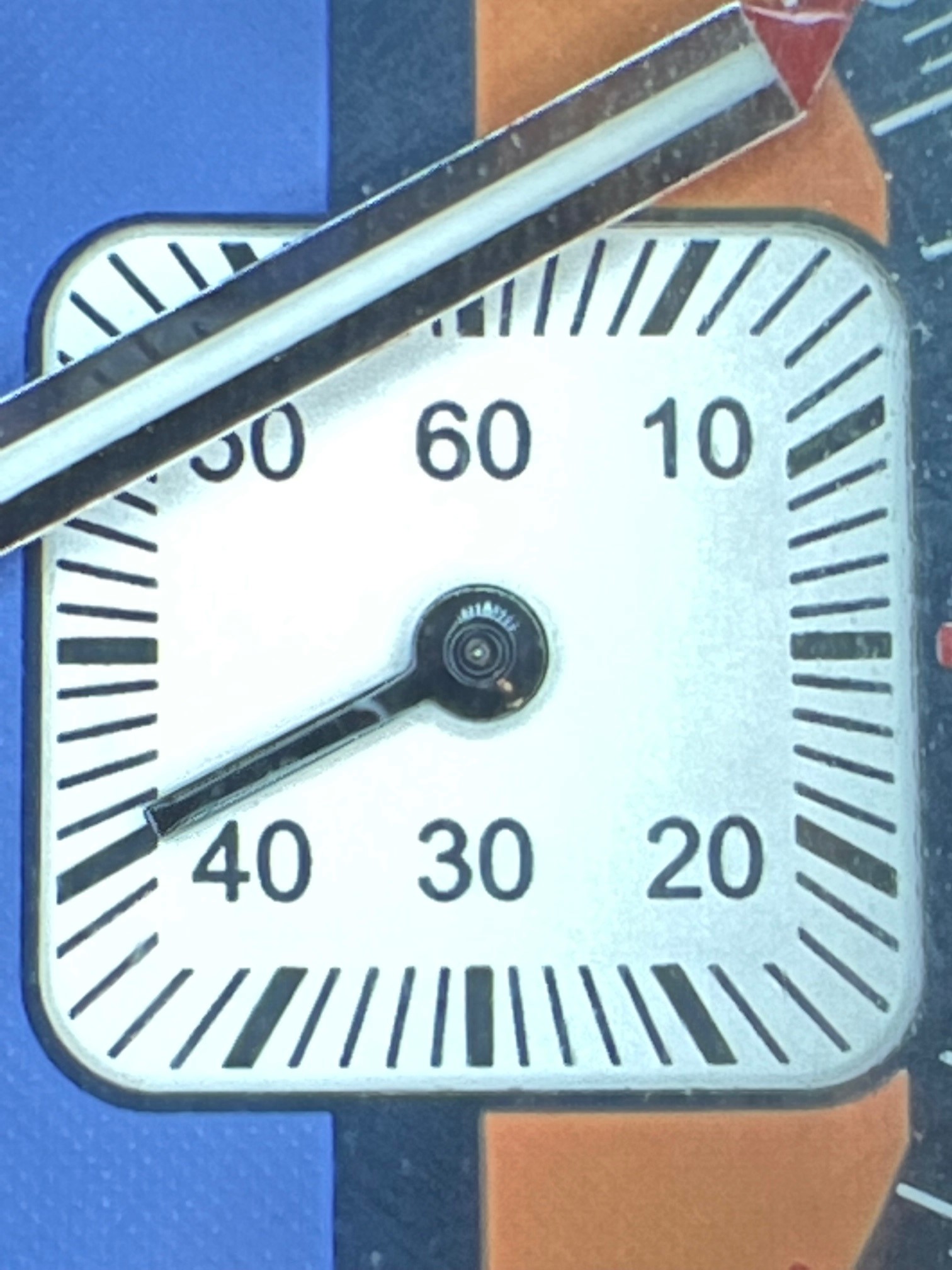

Finally, the running-seconds register. BTW, the movement is called Cal 11 but it's hardly anything like the true Heuer model, being a Sellita Top Grade SW300-1 turned upside down on a bespoke DD chrono module. The original Cal 11 didn't have running seconds and that would have been a deal-breaker for me personally:
Again we see the printed pattern on the light blue band but not on the orange. And the sunburst dial peeks out from beneath the bands. I think the register is nicely executed and the artifact on the hand is the ring-light on the microscope.

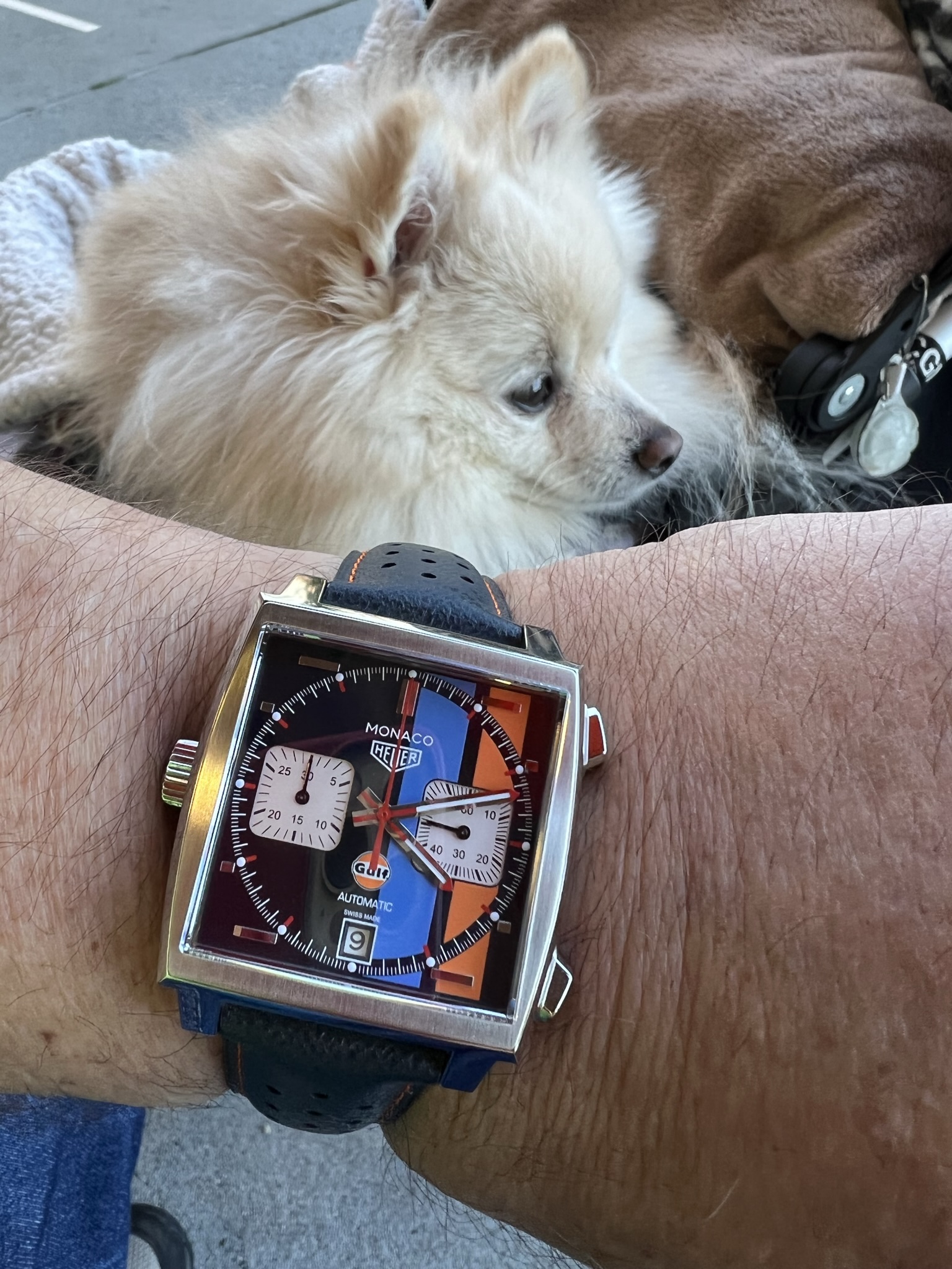

Just to sooth your eyes after all this:

Yuck... entry level Swiss watches should not be put under makro. Lets leave that to the high end stuff where they pay attention to the tiny details. These images will haunt my soul. But thanks for sharing! I guess... 馃榿

The Monaco line is not entry level though given how much TAG are charging for them... I wouldn't put an Aquaracer or Formula 1 under macro but a Monaco shouldn't be that shoddy.

That's true, though I would say as prices rise above $5k most other offerings do rise in quality. Loupe a Speedmaster for instance and while it won't be perfect, it won't be sloppy either. I mean, just look at the difference between the blue stripe with its even pattern (nicely done) and the absolute trash on the Gulf logo.

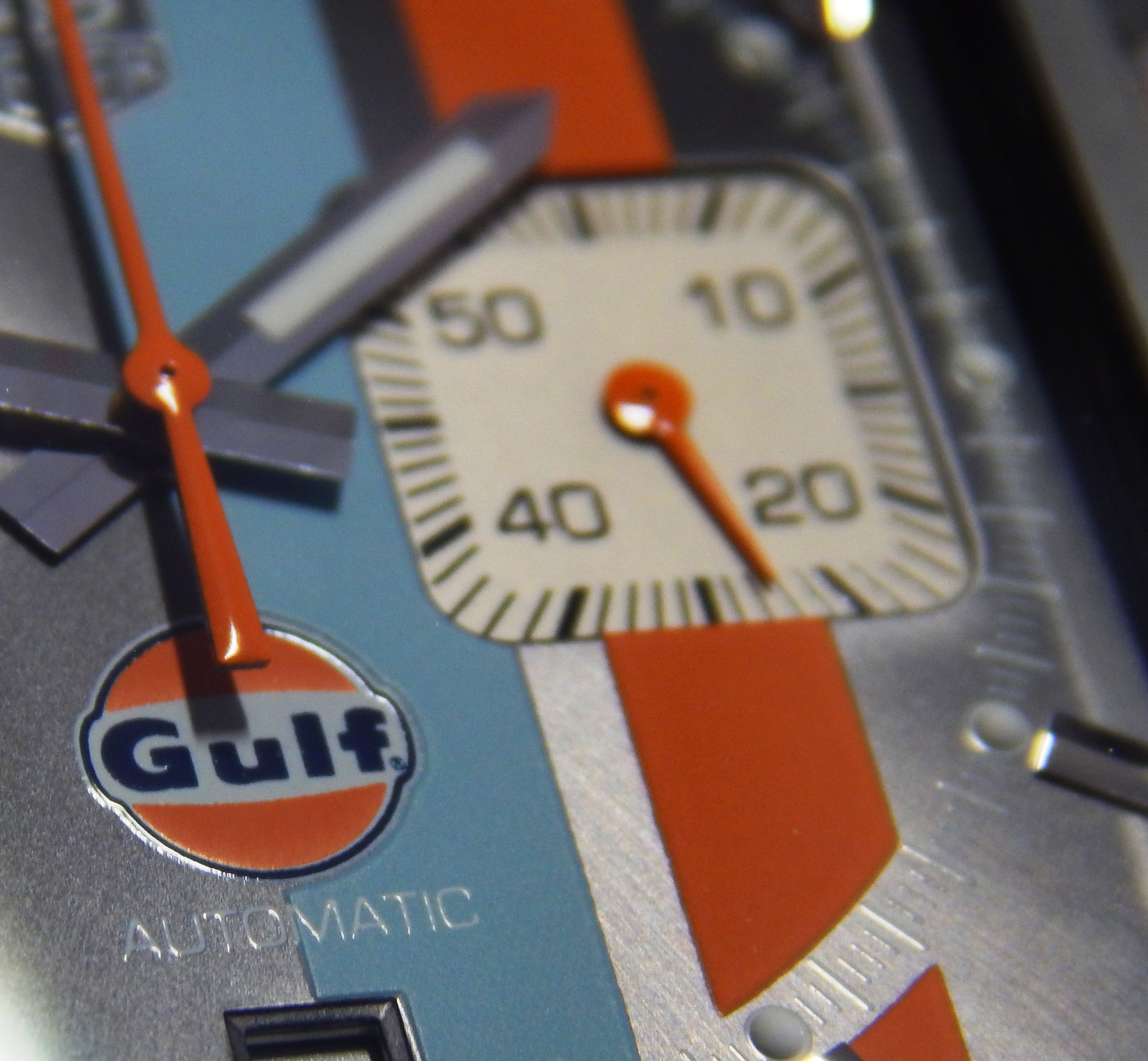

I was surprised to see how bumpy the logo looks super close up. So I took a magnifying loupe to my CAW2113 Calibre12 Monaco Gulf Grey LE (circa 2010) to check the logo. It looked rather smooth under the loupe, I couldn't see bumps like in your macro shot.
The only camera I have capable of a macro shot is a 9 year old Nikon and this is as close as my camera can get, which isn't close enough.
So you'll just have to trust my eyes when I say it's not bumpy like yours under a loupe.
Also, @heuerholic had posted a few macros of his CAW211T Monaco Gulf "First Victory" 1 of 50 LE. His pics don't get as close as yours, but I'm wondering if he were to zoom in closer on the logo what it would look like.
