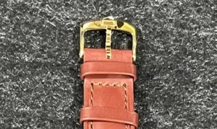

Interesting… A bit of a random observation/question here relating to the strap. After looking at the chrono24 pictures I noticed the underside of the links on this watch appear not to be gold plated. This looks to be consistent with your strap based on the photo you uploaded of your case back . However, the links on my strap are totally gold plated. Any idea if later oem straps were sold with fully gold plated links?

That's another difference of the later BC0459 replacement strap, which included end-links and buckle. The underside of the newer replacement is gold plated. The original S25.706C's end-links were not gold plated on the underside. I believe this was also the case for the S25.706/CG1123 if bought new with the strap rather than a bracelet.
Just the leather portion of the strap is available separately too (FC8017). The seller says it has the original strap, but I suspect it might be a newer replacement strap using original end-links. Because it looks newer and has Genuine Leather rather than Cuir Veritable.

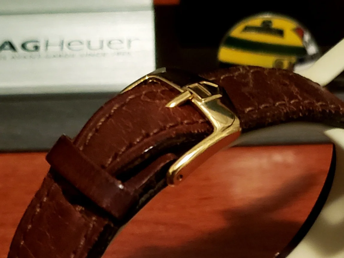

While we're on the topic of the strap, one other change is the newer replacement has a different pin on the buckle.
The newer one has a flat pin.
The original pin, as shown on mine, is cylindrical.

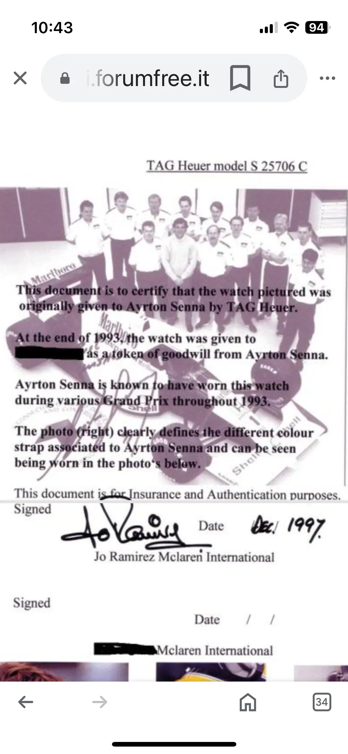

So the Senna watch doesn’t have a serial number? Otherwise Bonhams had it registered? Interesting.

And where is this document at this moment?

I'm not sure about the serial number, perhaps it's one of those without. Which would make sense, because Senna started wearing his in '89.

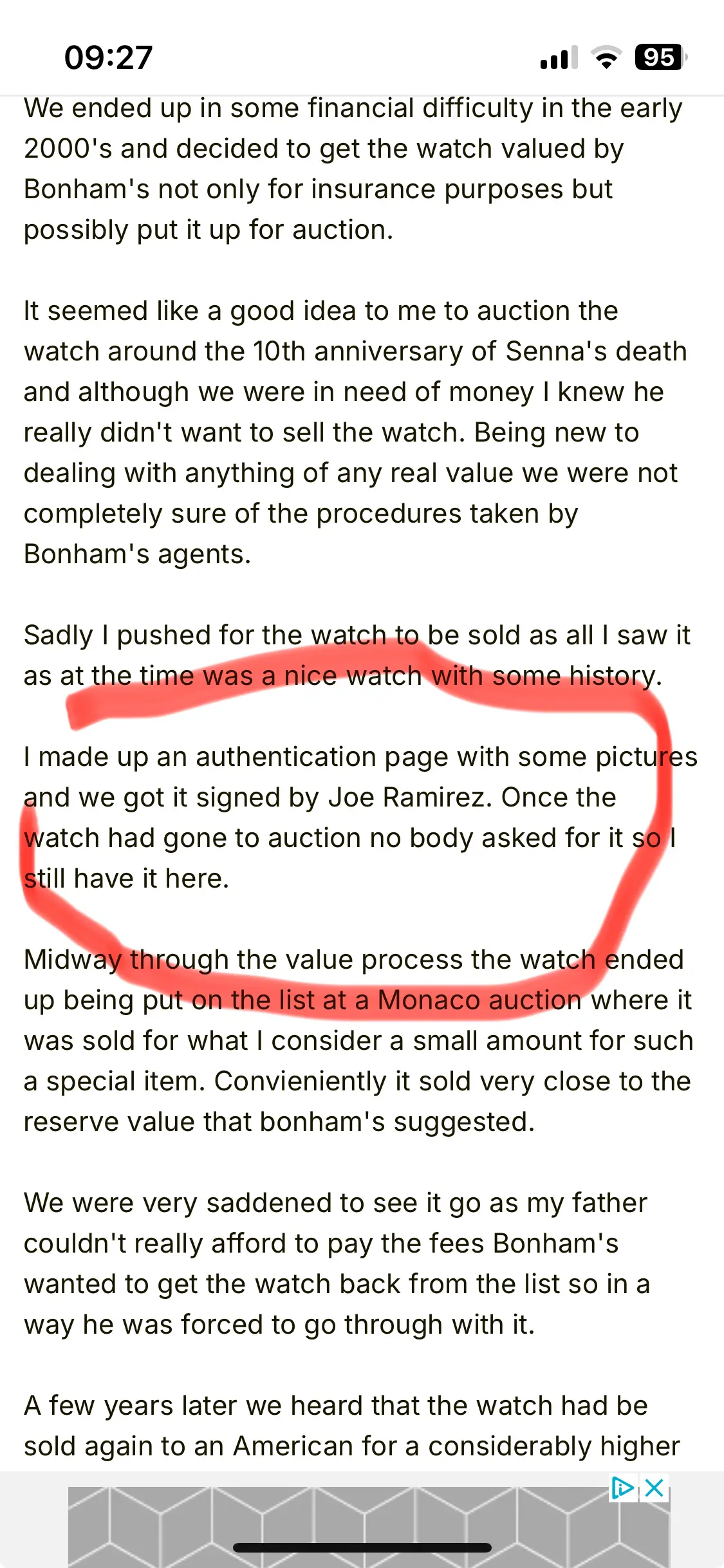

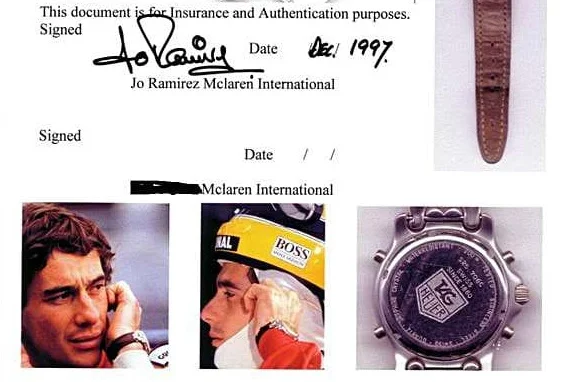

In looking at the case-back in the bottom of the document, I don't see a serial number. But it still has the clear plastic sticker on it, which might be obscuring it. Regarding where this document is now, it seems Ron Pellat's son kept it after the first auction in 2004, he posted a picture of it in is watchuseek post in 2008. Which is how we have it floating around on the internet.
As an aside, I noticed that the backside of the pushers and crown are so worn, that the gold plating seems to have rubbed off. Senna wore the heck out of that watch!
Nicholas mentioned that Senna gifted several watches to various folks at McLaren. In that context, it seemed he wasn't sure which watch I was referring to, so I then explained about the Bonham's auctioned one. That's where our exchanged ended.
But I think there's a difference between gifting TAG Heuer watches (which I'm sure he did a lot) vs. gifting his own personal watch off his wrist (which I suspect wasn't as frequent). In both cases, the origin can be traced to Senna, but the ones he wore are obviously even more special. That's the part that seems to be making Nicholas's job more difficult, knowing which were just new TAGs given as gifts by Senna vs the ones that Senna actually wore.
E.g. Senna gave TAG F1s away as prizes to kids at his Karting events. A very special prize, which in a sense are Senna watches. Although not ones that he actually wore.

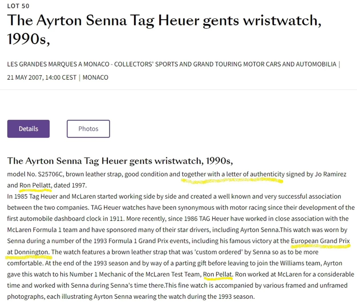

Yes plenty of mystery. I found a few inconsistencies & conflicting info on the description of the Bonhams auction page.
https://cars.bonhams.com/auction/15487/lot/50/the-ayrton-senna-tag-heuer-gents-wristwatch-1990s/
It says it was auctioned with the authentication letter, but according to Ron Pellat's son, he kept it. So did the authentication letter eventually find its way to the next owner or to Bonhams? Or, was there more than one copy made?
It also says Senna wore the watch at the 1993 European GP at Donnington (consistent with Ron Pellat's son's story). Which is one of Senna's most famous wins, for his "Lap of the Gods" opening lap. Yet, in every picture I've seen of Senna at that race, he's wearing his 6000 WH5151, not this S/EL.
I also noticed that the Bonhams page spells Ron's family name two different ways, as Pellatt and Pellat. I'm not sure which is correct. I've even found Motorsport Images of the McLaren Mechanic with his name as Ron Pallatt.
