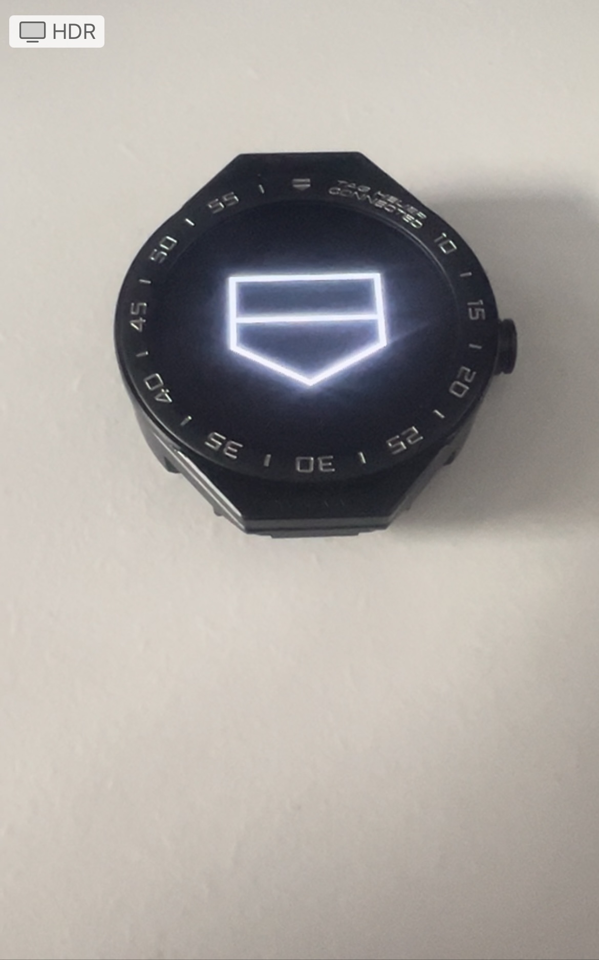

Did anyone have a problem like this yet? I updated my watch today and after the update it got stuck in the boot loop, loading until 1/3 and restarting again. This kept on going on for 2 hours then it just got stuck on the TAG Heuer logo until the battery got discharged. I’ve connected it to the charger and it is stuck on logo the whole time. Any solution maybe?

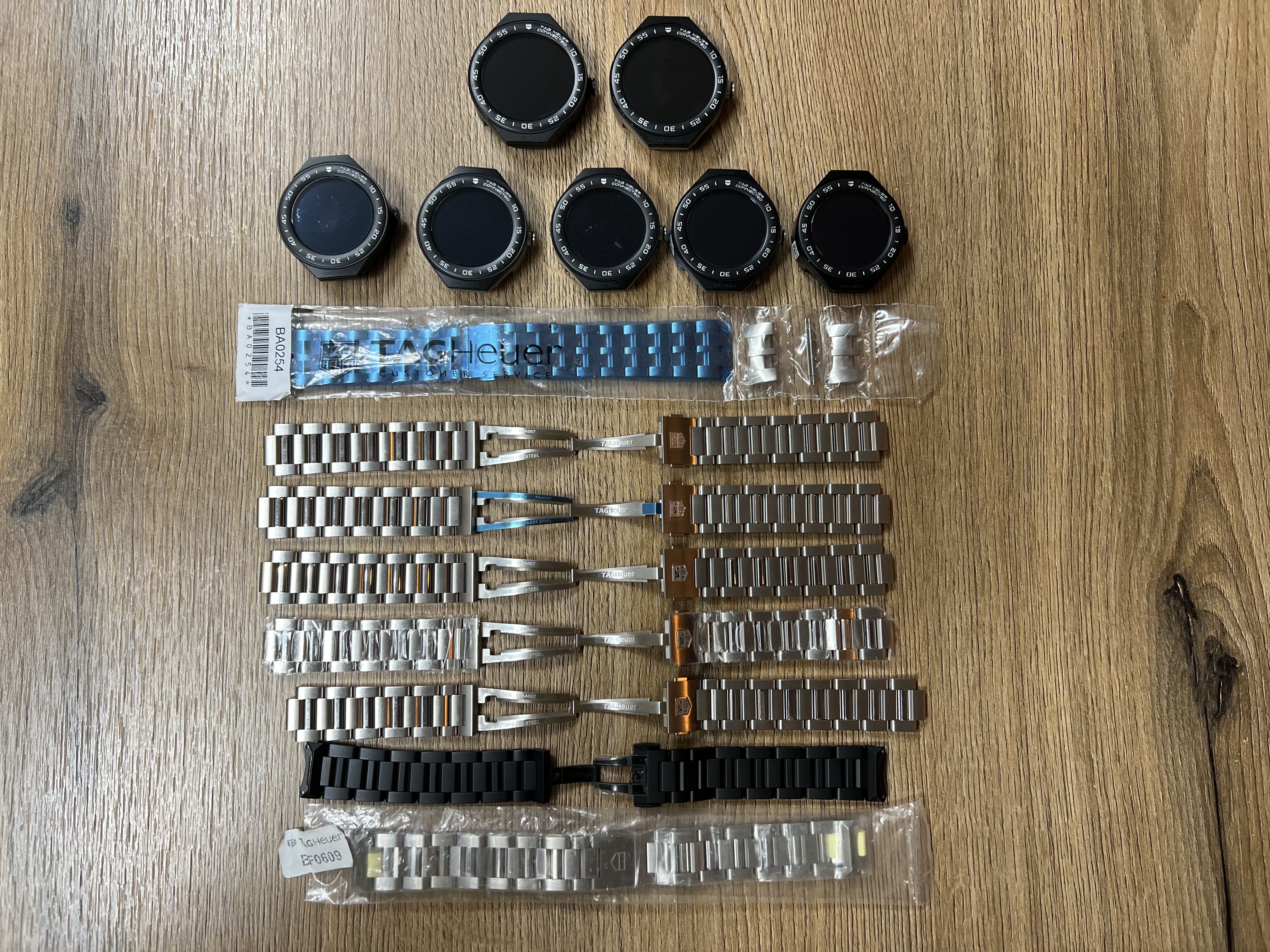

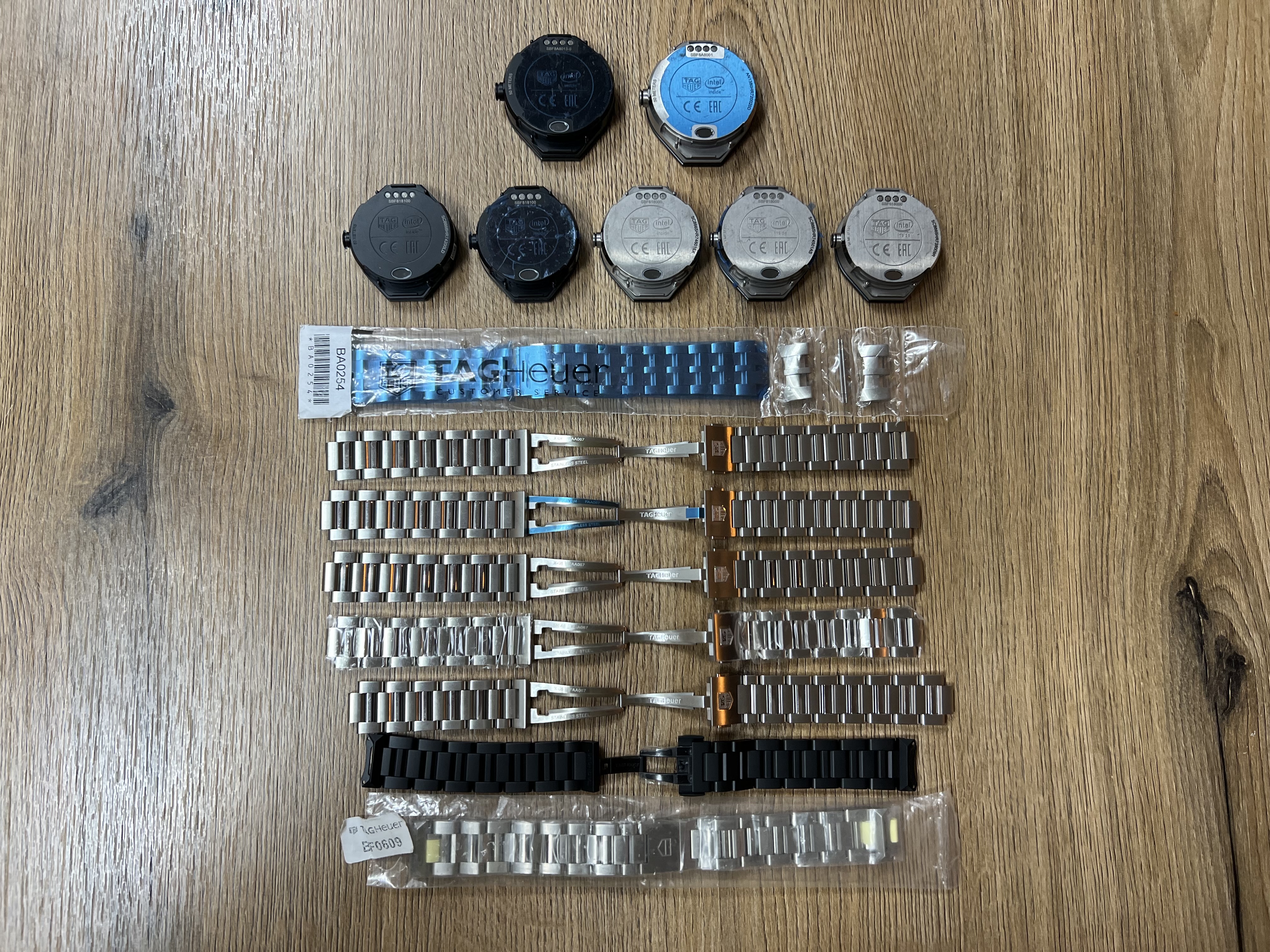

But there are more that 3 heads there, did u already one the others ?

The 45 work fine and hold the charge normally. The 41 are strange, I don’t have the original 41 charger but I tried to charge them up with 45 and 46 charger with a little bit of fiddling arround to set the connectors correctly. I don’t know the specs of those chargers and if there are any amperage and voltage output differences or connector orientation. One 41 shows as being charged to 100%, as soon as I remove it from the charger it shuts off. The other 4 start charging and go through all the logos but as soon as they load up the system and show the dial face they shut down. Battery problems or possible incorrect charger?

2 heads are now spare 45 and the smaller 5 are the 41.
