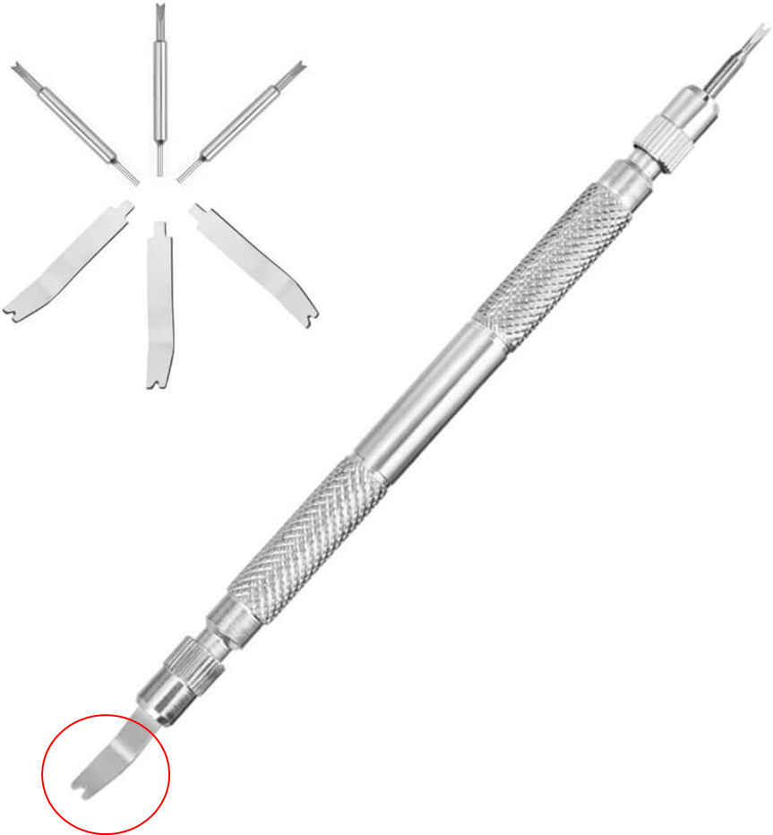

  3. YG_Rulz
    YG_Rulz Nov 8, 2022
    963
    1,660
    I had bought lug pins with which i got a spring bar tool (https://www.amazon.co.uk/dp/B07CYPVGWY/) - works perfectly for me. The main thing to consider is that the spring bar tip on the tool is angled (like in the pic below). That angle applies a little extra leverage making it easier to remove/install the pin. upload_2022-11-8_16-28-17.png

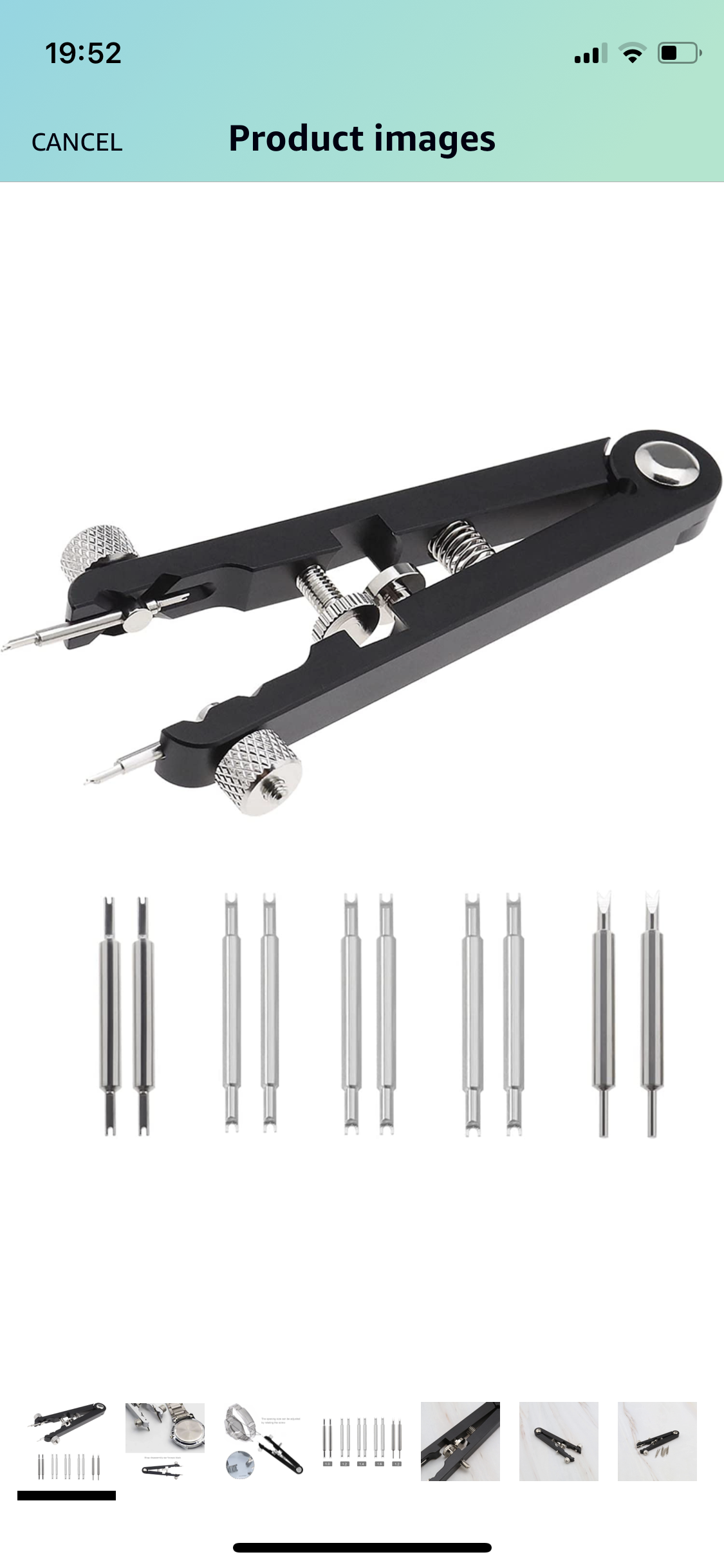

  7. Mspeedster
    Mspeedster Nov 8, 2022
    7,826
    15,956
    I also have the Bergeon 6767-F, which I use for straps. But their tweezer tool seems way too expensive. I use this one on my bracelets, like the BB58s, works just fine.
    https://www.amazon.com/Spring-Durable-Tweezer-Removal-Repair/dp/B08H55MW9T/

  8. Mspeedster
    7,826
    15,956
    I also use the Bergeon 6111, its rounded edge is less likely to harm fine leather straps.

  9. abrod520
    abrod520 Nov 8, 2022
    11,414
    36,166
    Do not buy the Bergeon tweezer tool. It's apparently designed for Rolex springbars specifically, which apparently have much smaller necks than regular ones. The Bergeon tweezer can't quite grip regular springbars unfortunately.
    That was an expensive lesson for me
    Mspeedster likes this.
