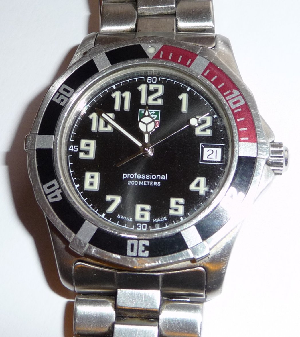

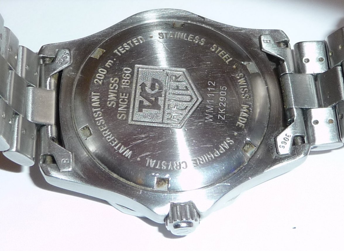

    I'm a new member who's very happy to have found you. I bought a used 2000 Sport 200M WM1112 - black face, colored emblem, numerals at each hour, black/red bezel, date window - back in 2010 on eBay because I fell in love with its looks, and have been very happy with it. Needless to say it didn't come with a box or instruction booklet but I've been able to figure out more or less how to operate it. One thing is a puzzle though - mainly thanks to your site I've heard of a "quickset function" for changing the date in the date window and was wondering if my model has that feature, and if so how do I use it? Any info, either specific instructions or a link to a downloadable instruction booklet, would be greatly appreciated.

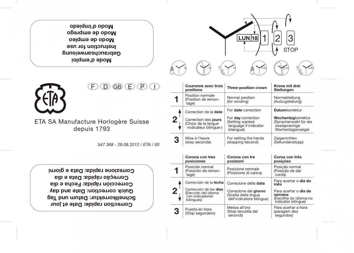

    Hi Ken- and welcome!
    I think that- like most of the 2000 watches from this era- your watch has the ETA 955.112 or 955.114 quartz movement. Check this site where they have a link to more details on the movement- instructions are as below
