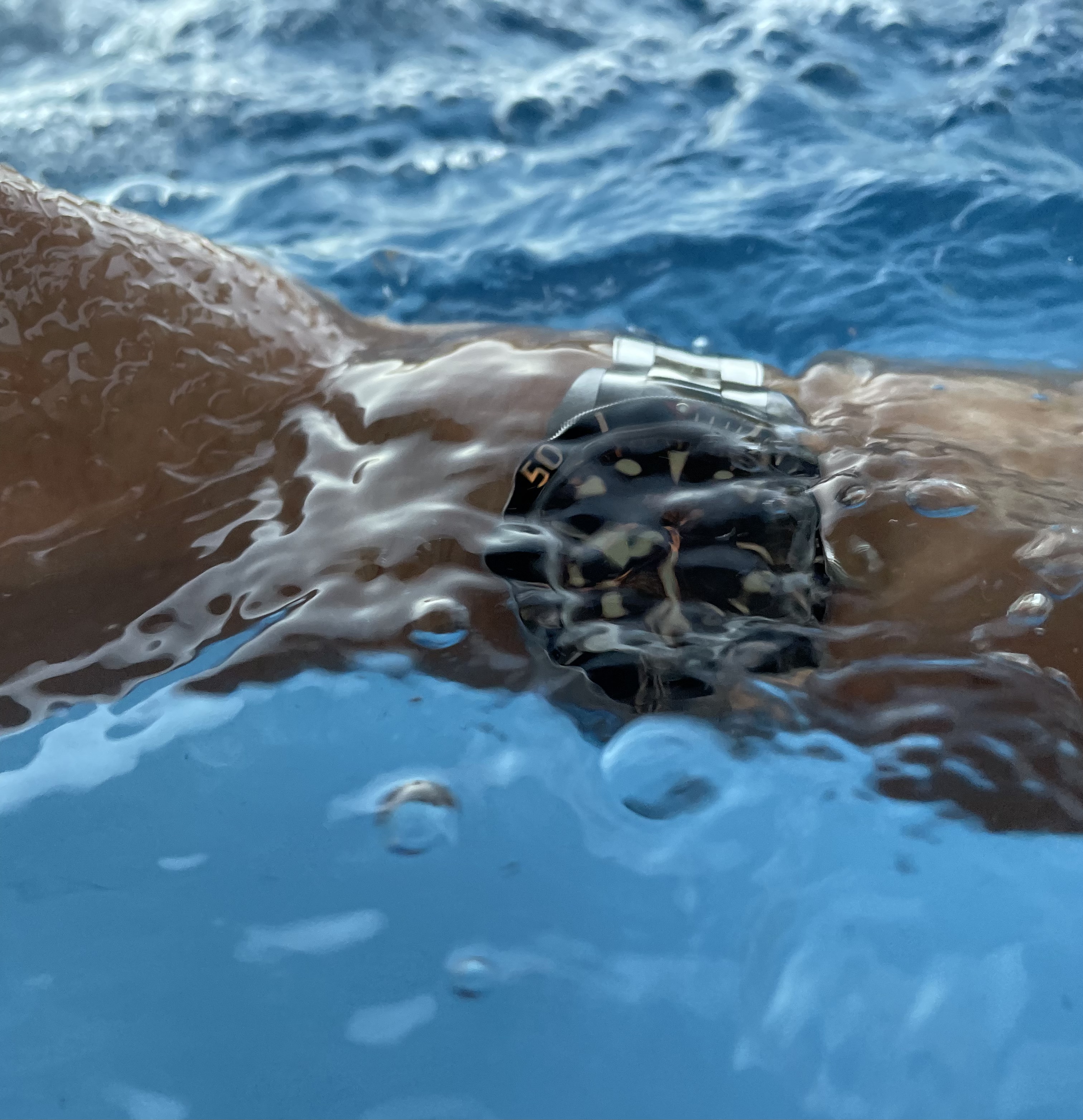

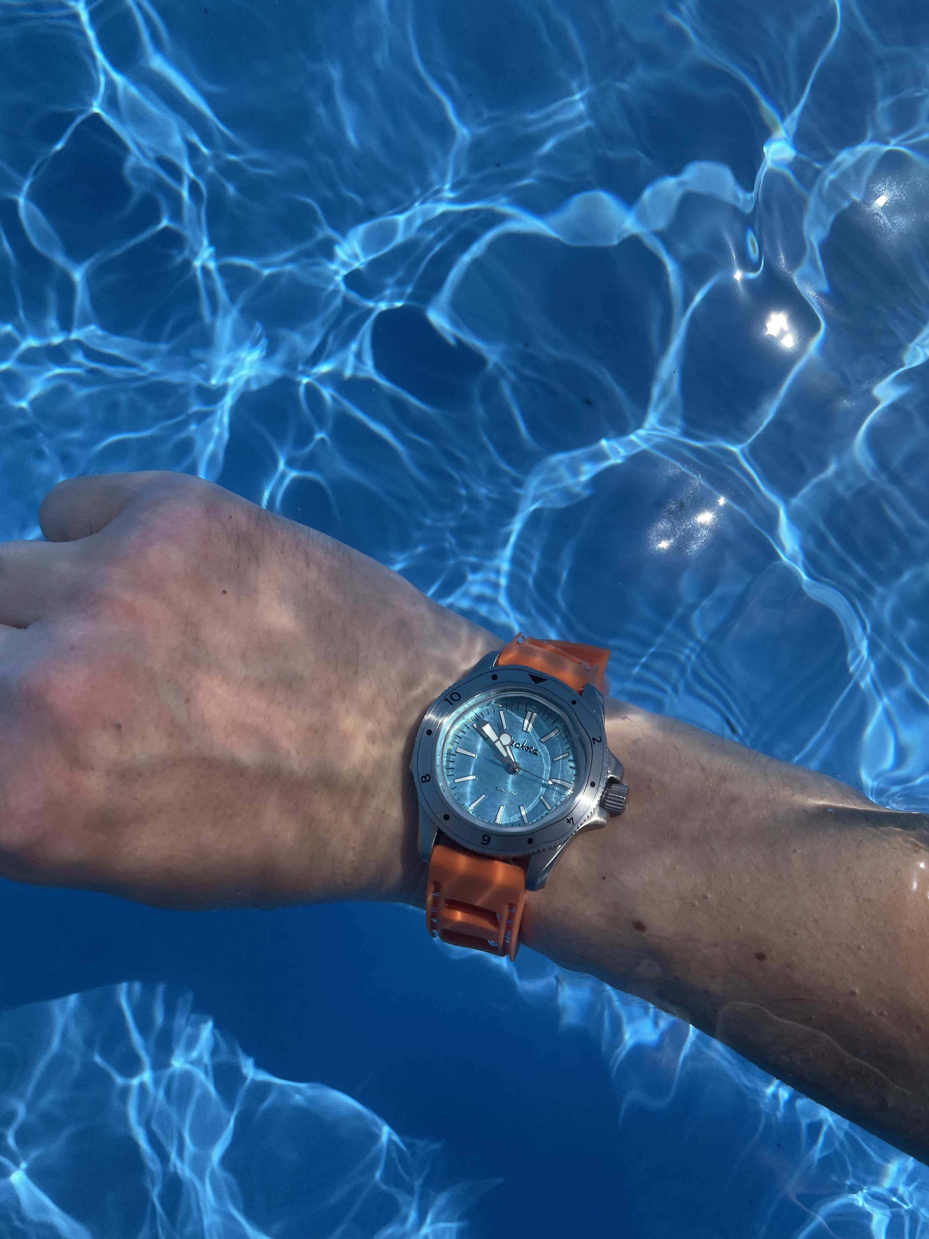

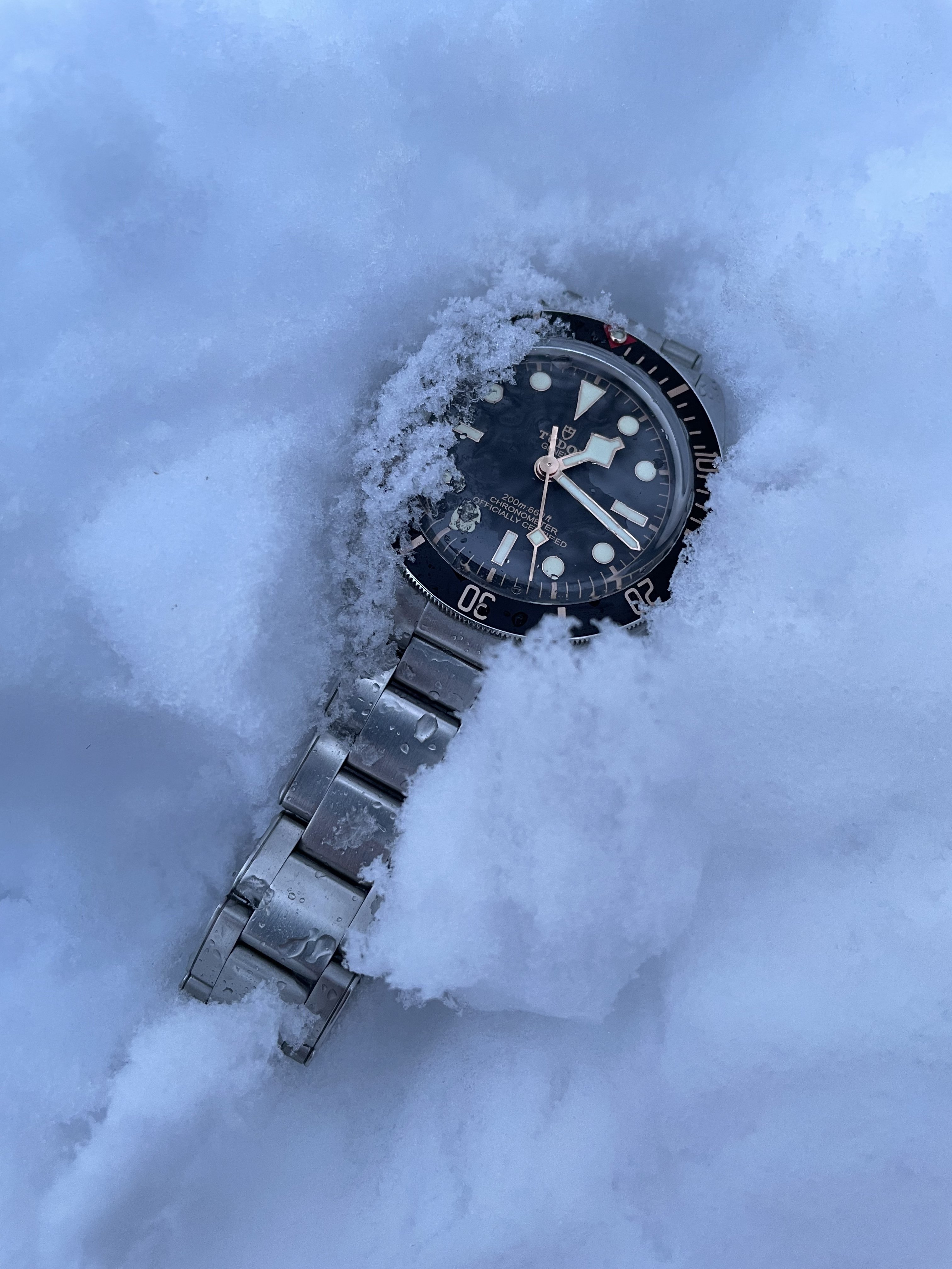

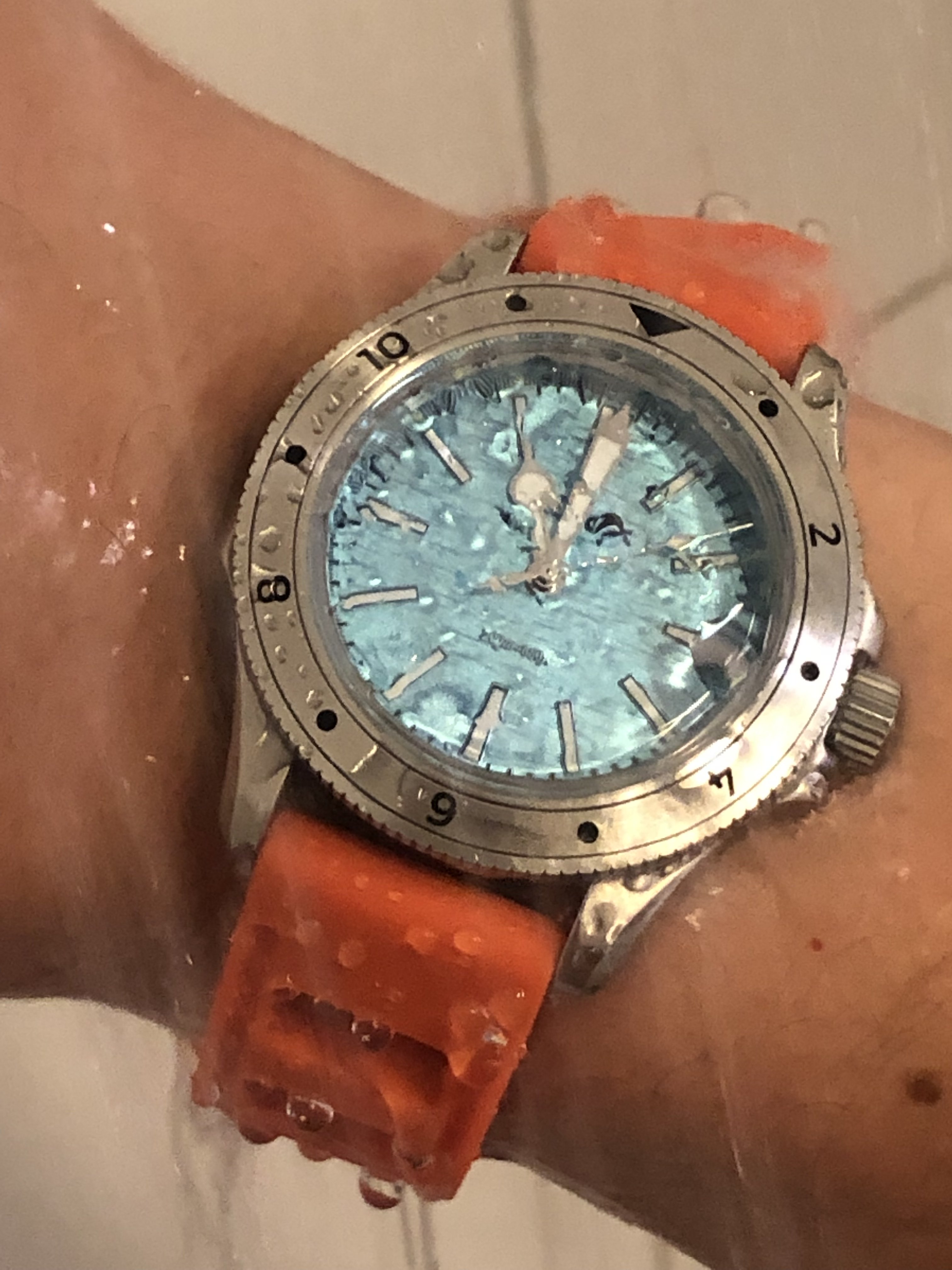

Oh yeah, salt water, soap, pools, hot waterr, snow.. and watches [insert zucchini emoji]
#wetwatches #getwet #ilikeitwetbaby
