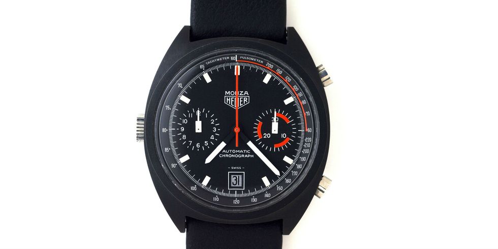

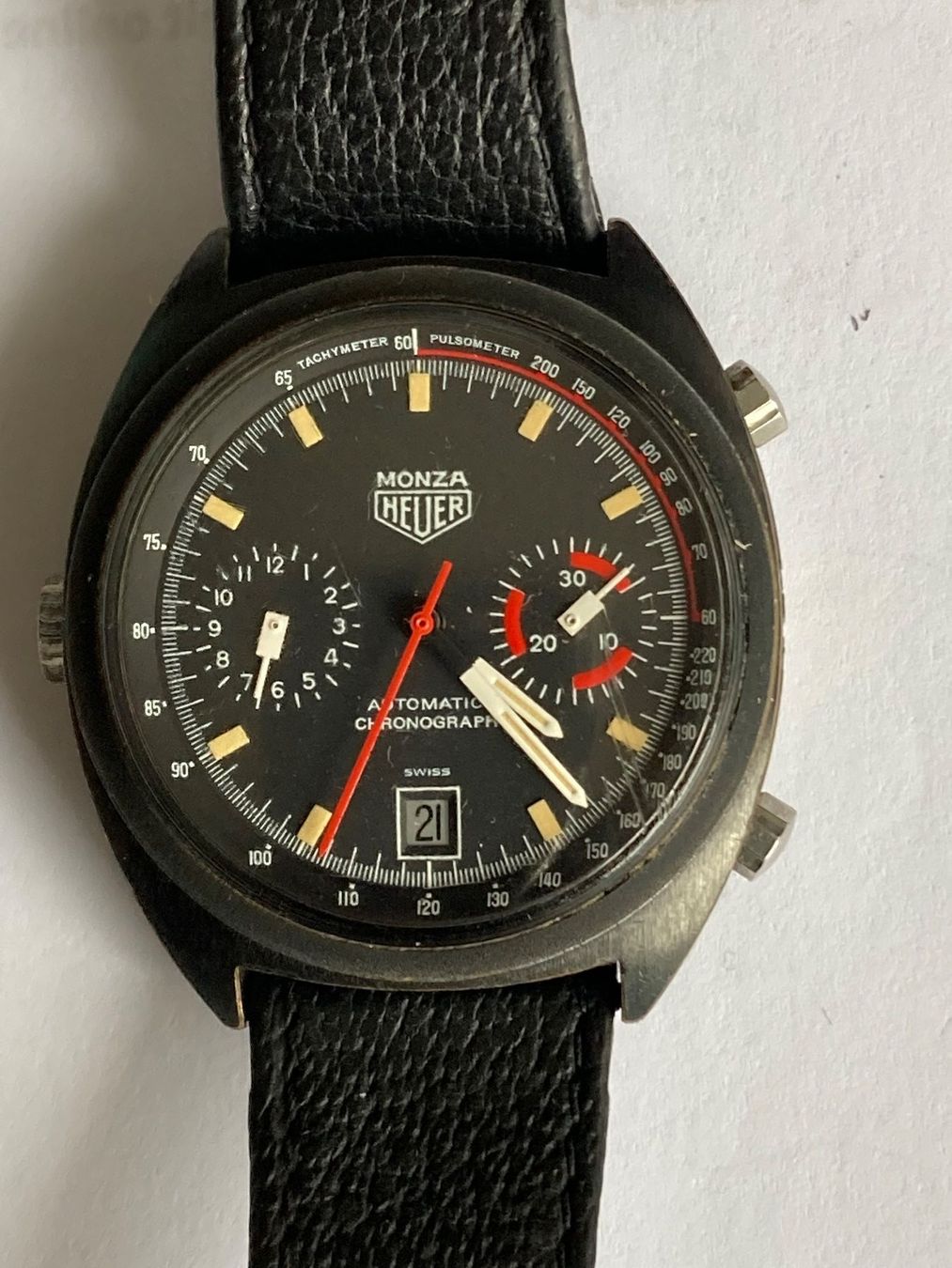

Hello - I have been trying to find this version of the Monza
I have seen it at the following places
https://www.roadandtrack.com/car-cu...ograph-celebrated-ferraris-greatest-comeback/
https://www.lot-art.com/auction-lot...3665-heuer_monza_chronograph-08.5.21-catawiki
And also on George Bamford's wrist in about effing time podcast (4:25)
But cannot find it or it's reference anywhere.
I can find the economy version (without the monza on the dial) 150.501 quite regularly but the one with monza on top of the Heuer logo and the balanced chrono registers seems to not even exist on
http://www.onthedash.com/watches/monza/
Any idea of what this model is? Was it a transitional reference between the economy version and the Niki Lauda version?
Appreciate the help!

The one you have pictured, with the symmetric sub-dials, is ref 110.511, not 150.501.
Ref 150.501 has asymmetric sub-dials. They're not hard to find.

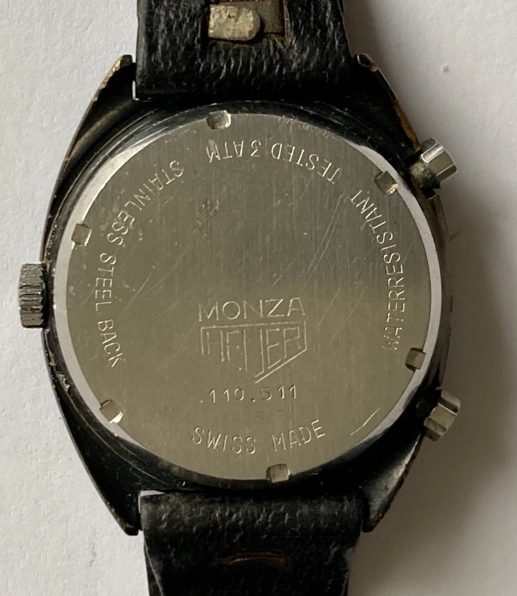

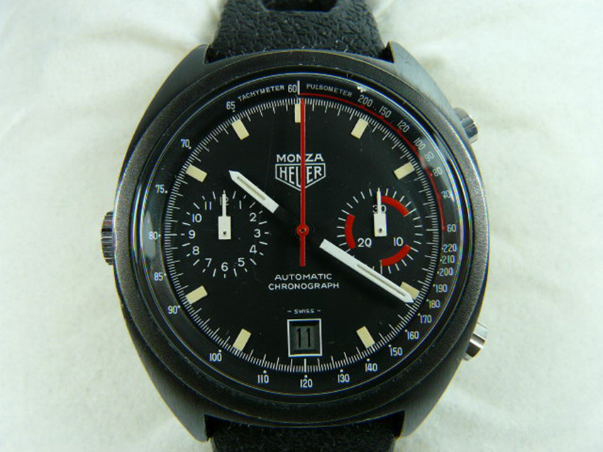

They are out there, but seem pretty rare.
George Bamford obviously has one.
I also found this one by searching on 110.501.
I found this one by searching on 110.511. It was recently for sale and even has 110.511 on the caseback.
https://www.ricardo.ch/de/a/heuer-monza-vintage-uhr-1975-kal12-ref-110511-uhr-laeuft-1220586792/
