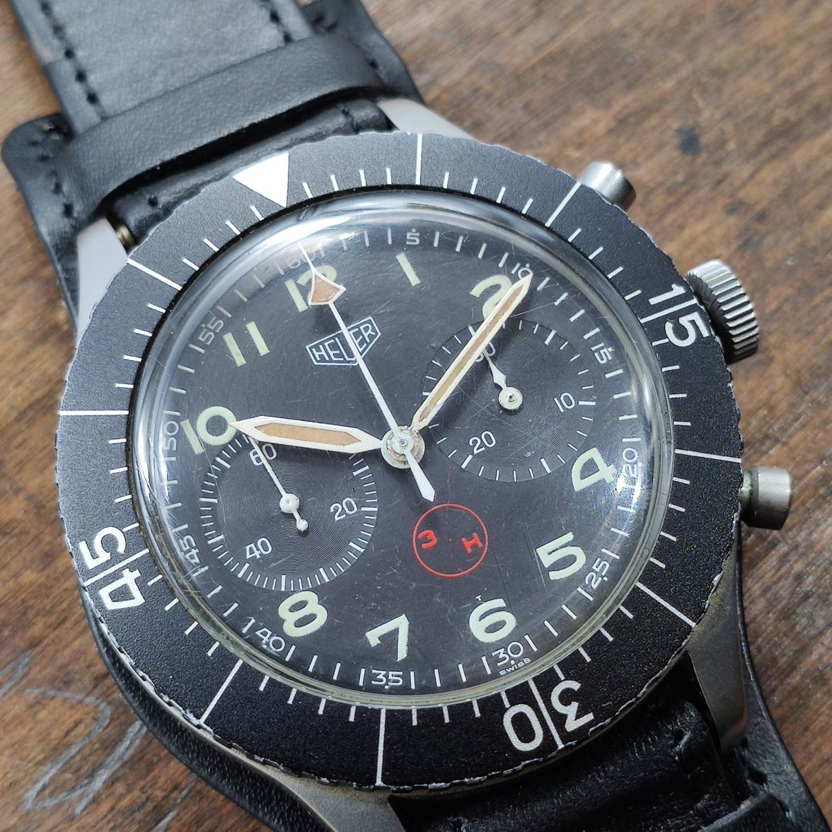

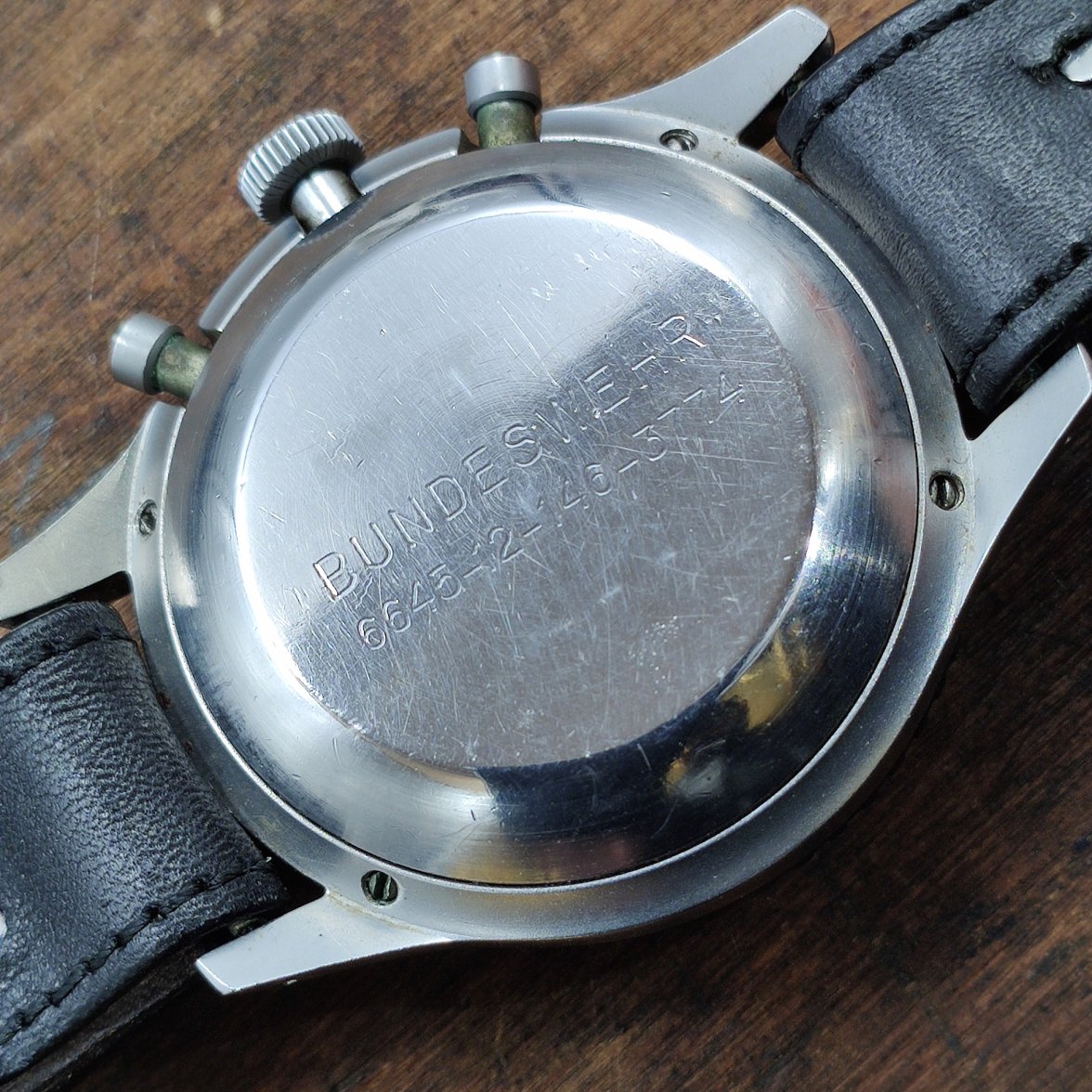

    Hell please can help to me to understand hoe to open the case to check the movement
    Thanks in advance Massimo

    Can’t help you there but I suppose it has to do with the 4 screws. Great piece!
  3. MassimoCoevo
    MassimoCoevo Nov 21, 2019
    19
    7

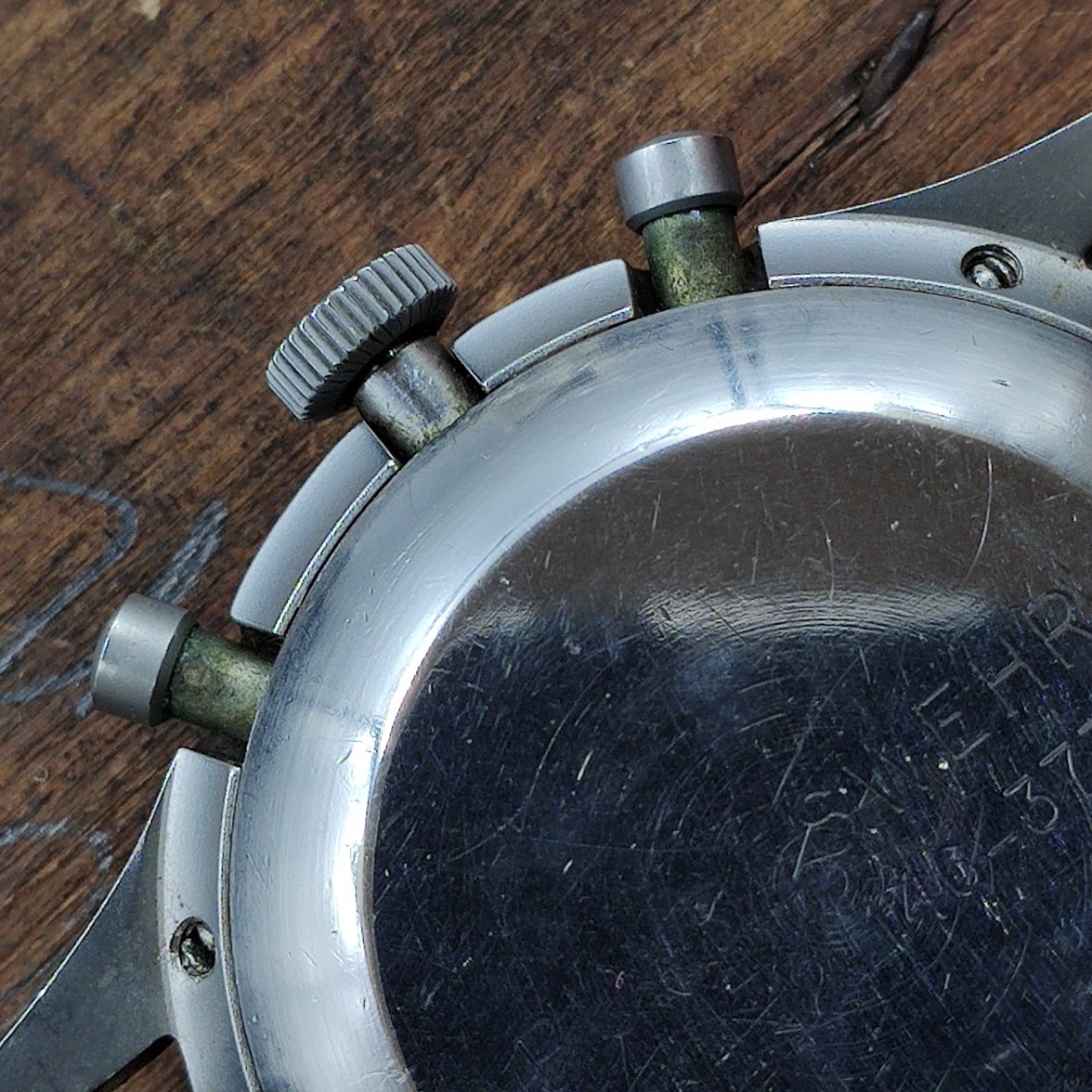

    The problem is after the 4 screws

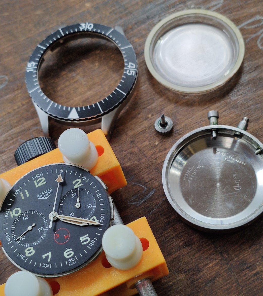

    From what i understand, after you remove the 4 screws, you should be able to remove the whole front-dial, bezel etc (or drop it out by turning it upside down.) No tools needed.....
    Let us know how it goes.....

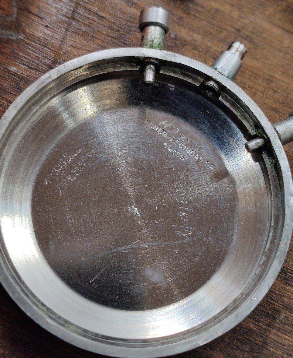

    Mr. Orange No knife someone helped me I was afraid of breaking something you had to remove the screws and push a lot from the glass downwards and the whole block came out then remove the crown then the glass and the dial was not easy to send photos for other friends
  10. MassimoCoevo
    19
    7
    Thanks to all DONE.
