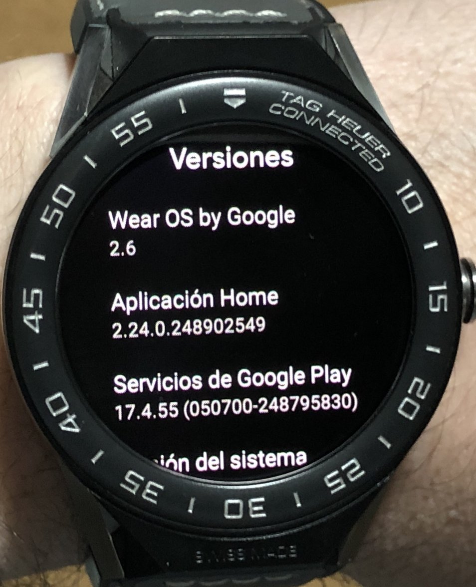

    My experience with the TH Connected Modular 45 is really good, and I’m totally happy with it (specially after last system H update, which improved the watch in many areas) after more than one year wearing it almost every day.
    Is your system updated? These are last versions:
    To avoid being asked for your screen pin, you can modify these settings and switch off the screen lock:
    I don’t have any issues about re-booting in my CM45 either. My other CM45 (Kingsman) also works perfect... so it seems your particular watch has some problem. Just use your 2 years warranty to solve it :thumbsup:
    About battery life, try a battery calibration. It improved a lot the battery life in my watch: just let the watch go to 0% of battery until it switches-off itself, then put it on the charger and don’t remove it until is at 100%, and repeat the same process one more time. Just search in the forum for “battery calibration” if you want more info
