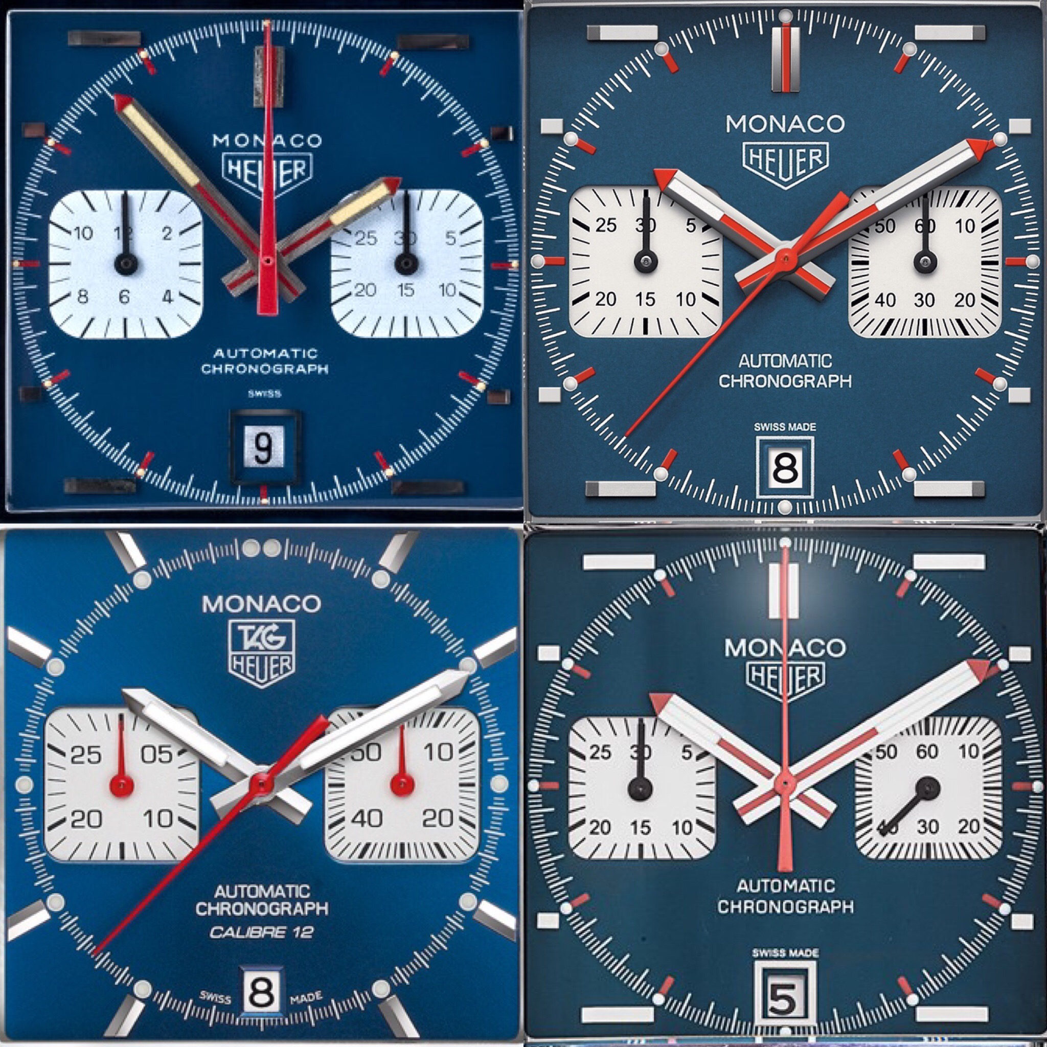

    Four generations of McQueen Monacos:
    - Top left: 1133B 1969/ Calibre 11
    - Top right: CAW211P 2015/ Calibre 11
    - Bottom left: CAW2113 2005/ Calibre 17
    - Bottom right: CAW211A 2009/ Calibre 11
    Photo by @mnejmantowicz #vintage #vintageheuer #heuer #tagheuer #heuermonaco #tagheuermonaco #monaco #stevemcqueen #mcqueen #calibre11

  4. RawArcher
    RawArcher Measures thread drift on the Richter Scale Oct 25, 2015
    758
    1,680
    Does anyone know why they decided to flip (L vs. R) the two sub-dials in all later versions?
  5. Calibre11
    Calibre11 Editor of Calibre11.com Staff Member Oct 25, 2015
    7,121
    15,031
    The layout of the registers is dictated by the base movement being used. Both the old Calibre 11 (1969) and the new Calibre 11 (2003-15) are piggy back movements- that is a chronograph module is mounted on a standard time-only movement.
    Even though they share a name, the Calibre 11s are based on totally different movements (Buren for the original, ETA/ Sellita for the new one- both have chronograph modules by Dubois Depraz, but those too share nothing in common) and those movements have different layouts.
    So it wasn't really a decision- that's just how the movements were originally.
    RawArcher likes this.
  6. RawArcher
    758
    1,680
    Thanks D.C. Great and helpful explanation!
