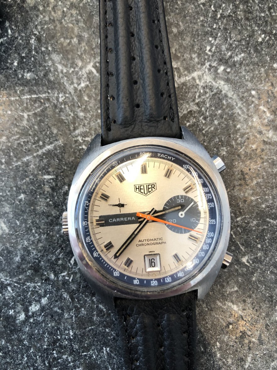

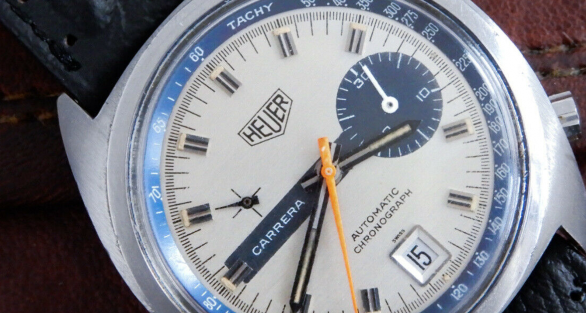

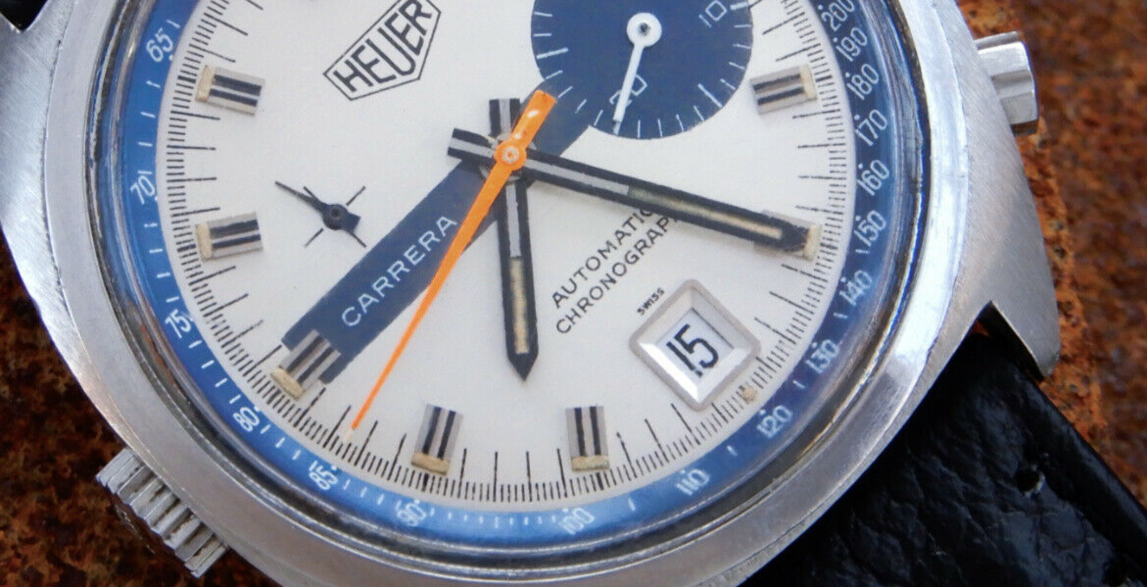

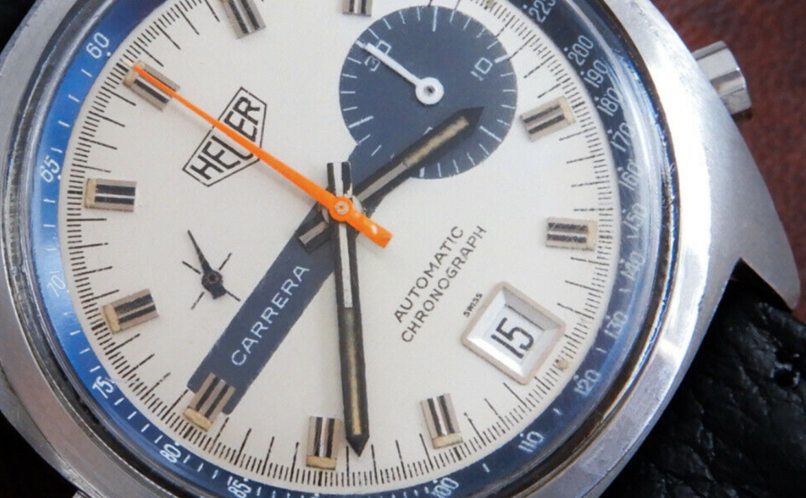

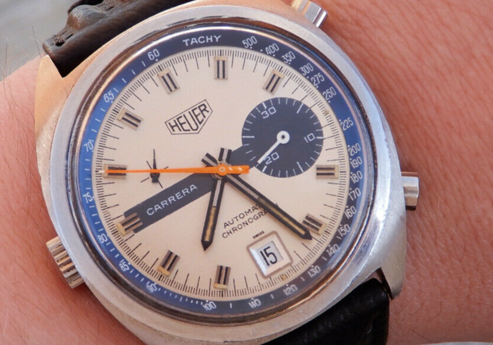

    Although this watch was listed as an N instead of an S, my research seemed to indicate that it was legit and seemed original but I'm no expert. I blew up the pictures the seller used. Wondering if anyone might weigh in.

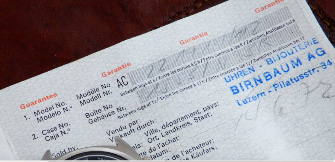

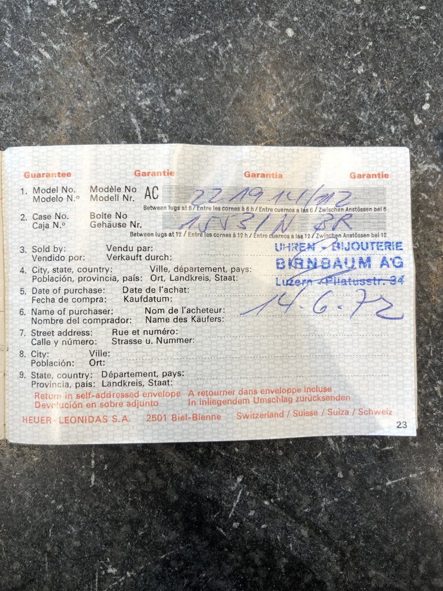

    I can't see a problem with this-the booklet seems to have been written in a rush which isn't uncommon. I'm assuming that is the serial number under 'model number' does it match the watch? It will give a good indication but I personally think it unlikely this has been switched from an N to a S.

    Thank you. I think the N/S issue may just have been a mistake in the listing. I was wondering if the hands, dial, etc looked correct with more experienced eyes. The seller was called out on a few issues with an omega a few years ago it seems so made me nervous.

    No problem. This afternoon (and after my above reply) I found the listing which has now ended, so I understand your concerns too. It does seem a little strange both the listing and booklet show 1153N. All the features seem correct for that dial though-all hands and tachy ring. I would just be asking for the actual serial number if it were me!

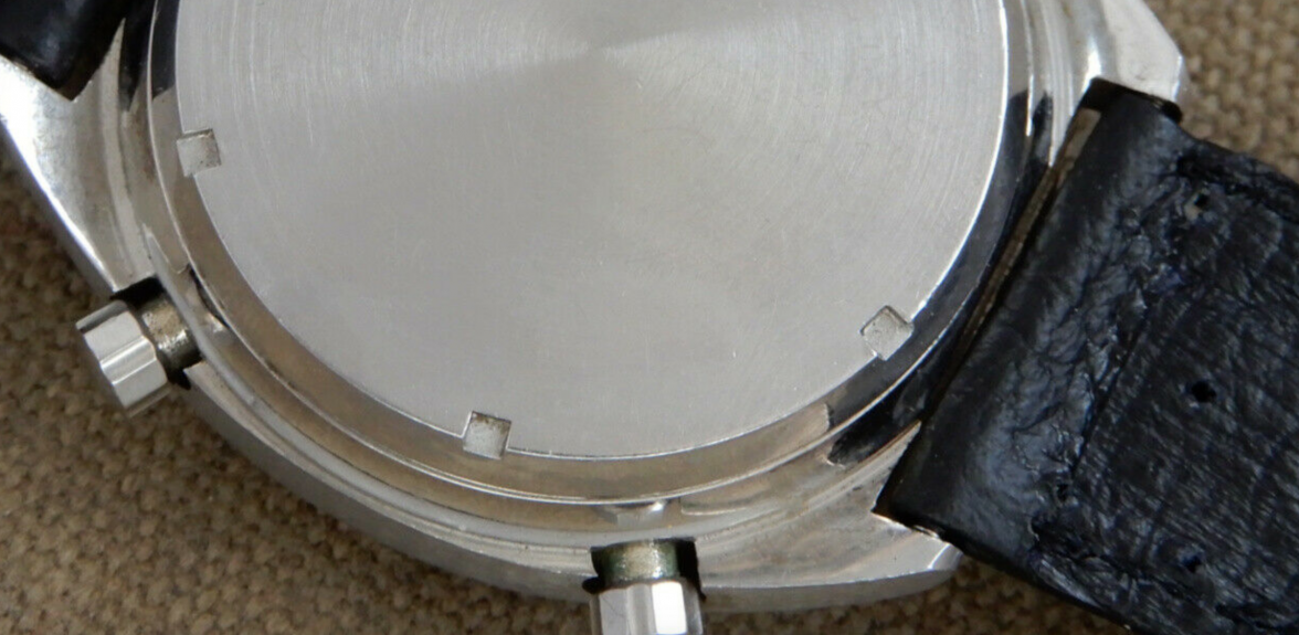

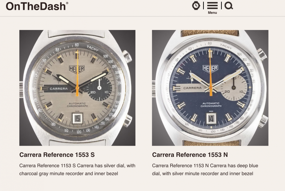

    Thank you. This is what i saw on on the dash. It's tricky depending on the light. I'm completely new to this sphere. (I still wear my grandfather's timex so I have a lot to learn).

    And the 7 hour looks a little misaligned.

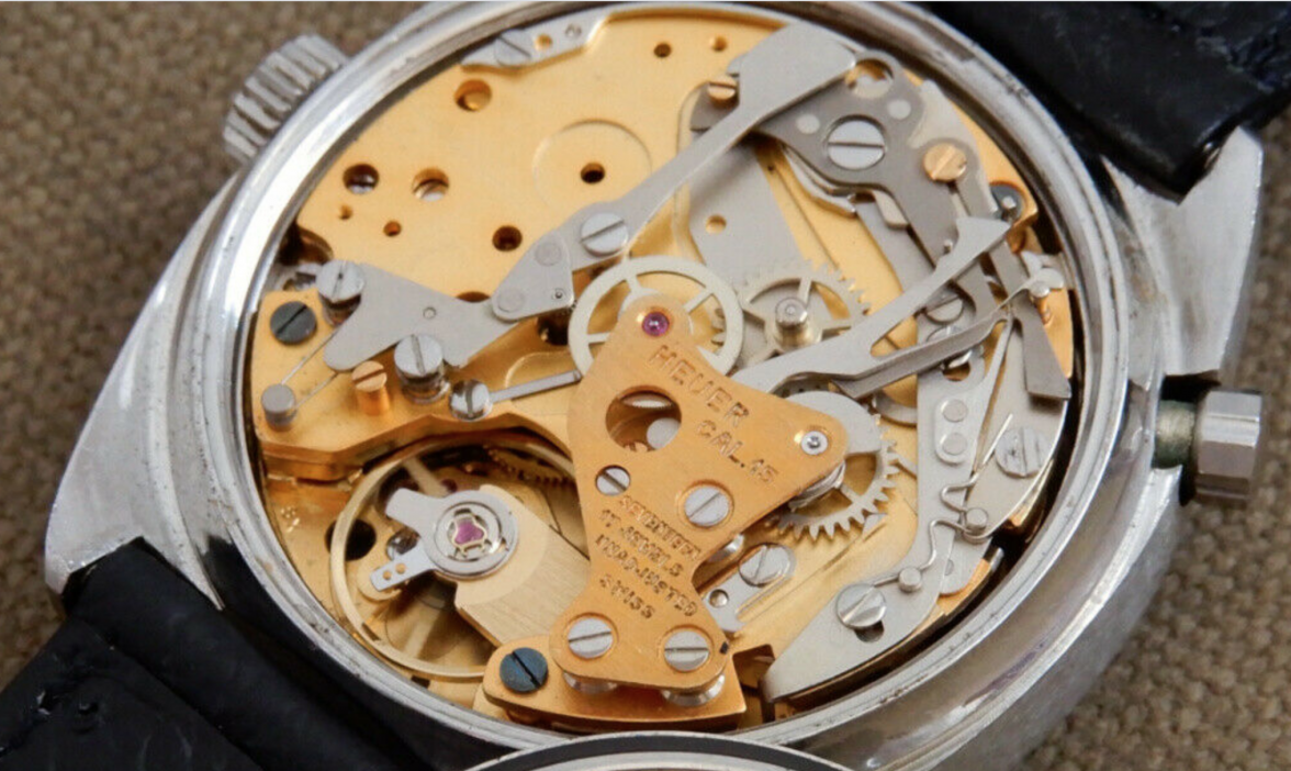

    It looks correct, but I can't read anything in the booklet. And yes, that 7 marker is no good. These are fairly plentiful and aren't terribly expensive in the grand scheme of vintage watches, so I'd set some eBay alerts and keep looking. Chrono24 will have a bunch of these too.

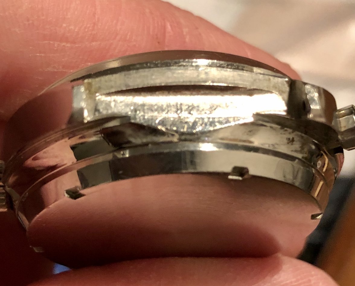

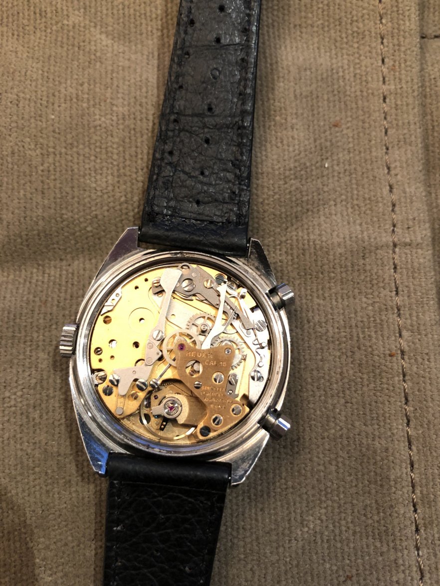

    Hi,
    I’ve got the watch and looking it over. So far, the only issues seem to be the number 7 bar being slightly misaligned and I can’t find a serial number anywhere to check the booklet against. Would the misalignment be a big spend assuming all else is correct? I have a fairly good price on it from what I’ve watched.

    If you haven't already, I'd check the serial number that should be engraved between the lugs to see if it matches the papers.

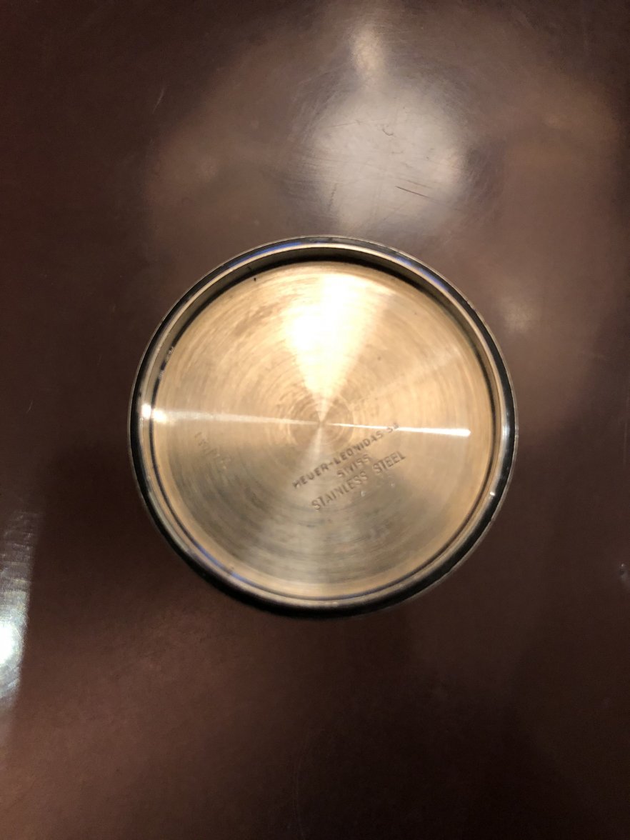

  12. KRR
    KRR Feb 29, 2020
    66
    11

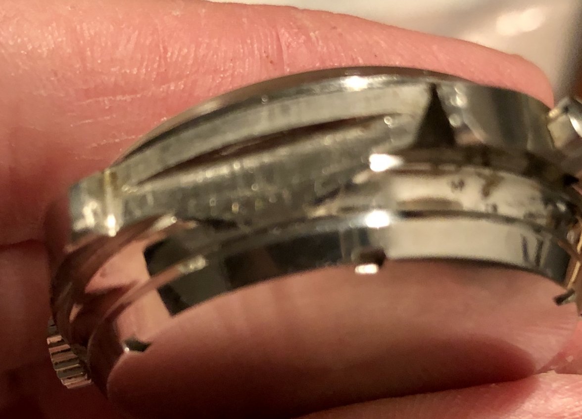

    No number I can see. Maybe it was sanded out?
    It’s odd, as the watch looks good otherwise but the seller maybe really wanted that book to match.

  13. Calibre11
    Calibre11 Editor of Calibre11.com Staff Member Mar 1, 2020
    7,121
    15,031
    Hmm. That is odd. If the numbers had matched, then we could have just assumed that the “N” was a mistake instead of “S”.
    But without that, it’s hard to conclude that the papers are original to the watch.
  14. abrod520
    abrod520 Mar 1, 2020
    11,262
    35,476
    The serial numbers on these Carrera cases are often worn off due to their placement right on the top lip that you see there, so that in and of itself wouldn't be a red flag. However, I wouldn't add any extra value for the booklet if the serial couldn't be matched, especially if there's any doubt about the model.
    I'm also concerned about what other problems could be hiding given that 7 marker. The movement looks OK in photos, but unless this was crazy cheap I'd keep searching.

    Thanks. I noticed those posts after I had pushed the button on the purchase. So far I'm not sure if the issues go beyond him over-hyping and being loose with the whole provenance bit. Someone did clearly do a cleaning at one point and probably nocked that 7 though, then reglued it. Crazy he's got so many stellar reviews if he's loose with the truth on such a regular basis.
