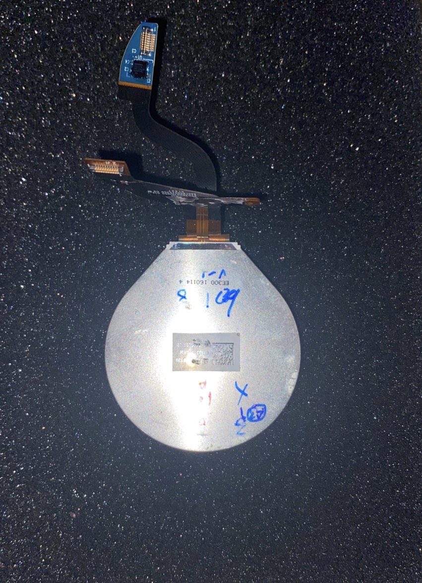

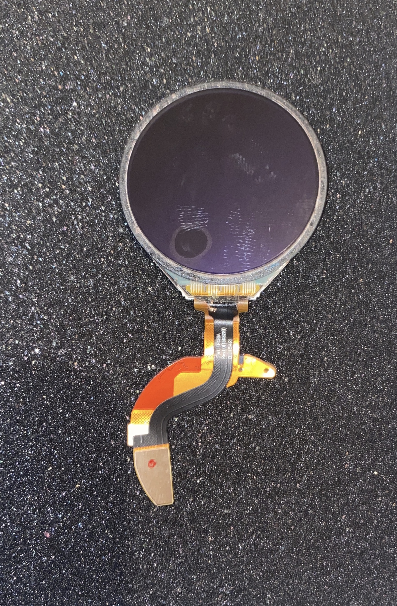

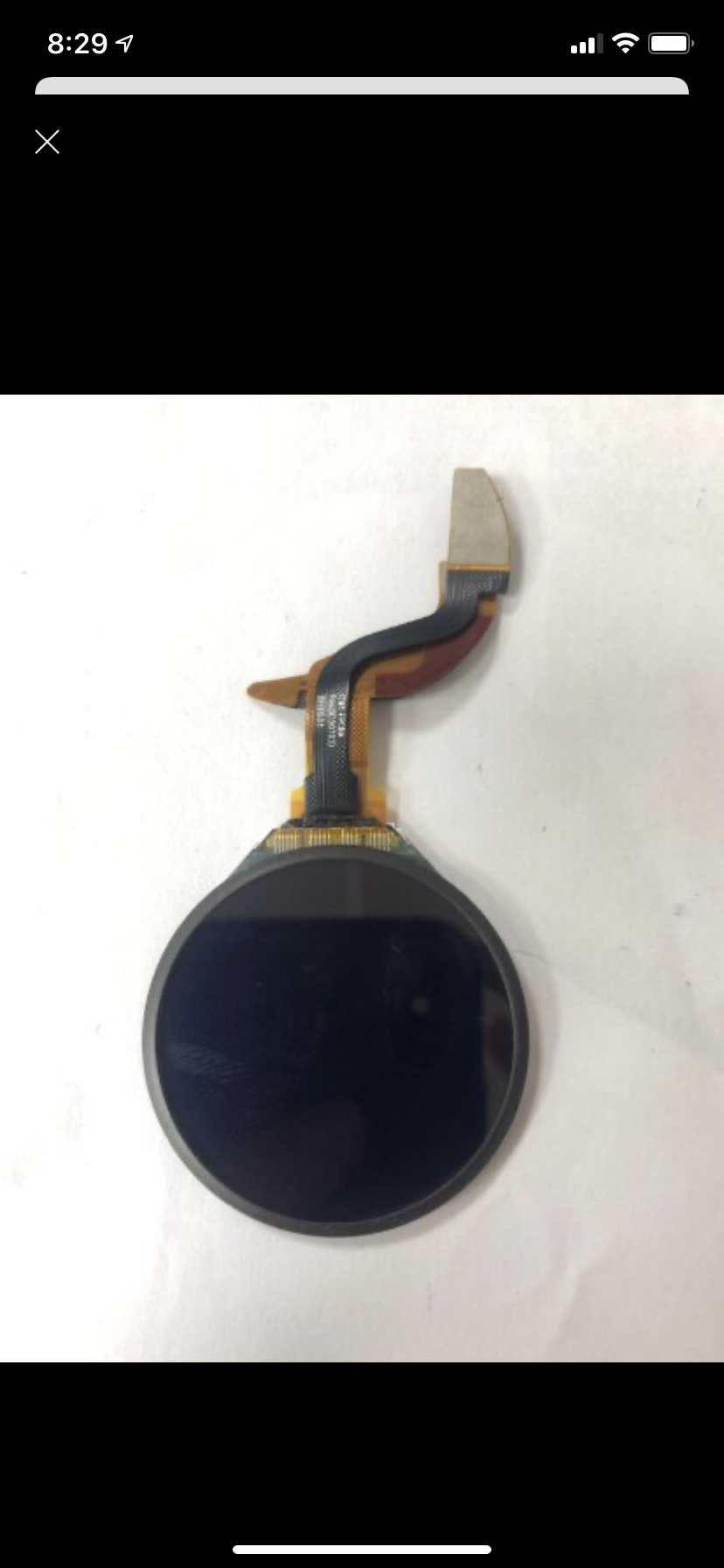

    It did nothing weird, it just turned off, it was not charging the watch I have managed to find my watch screen !! ::psy::

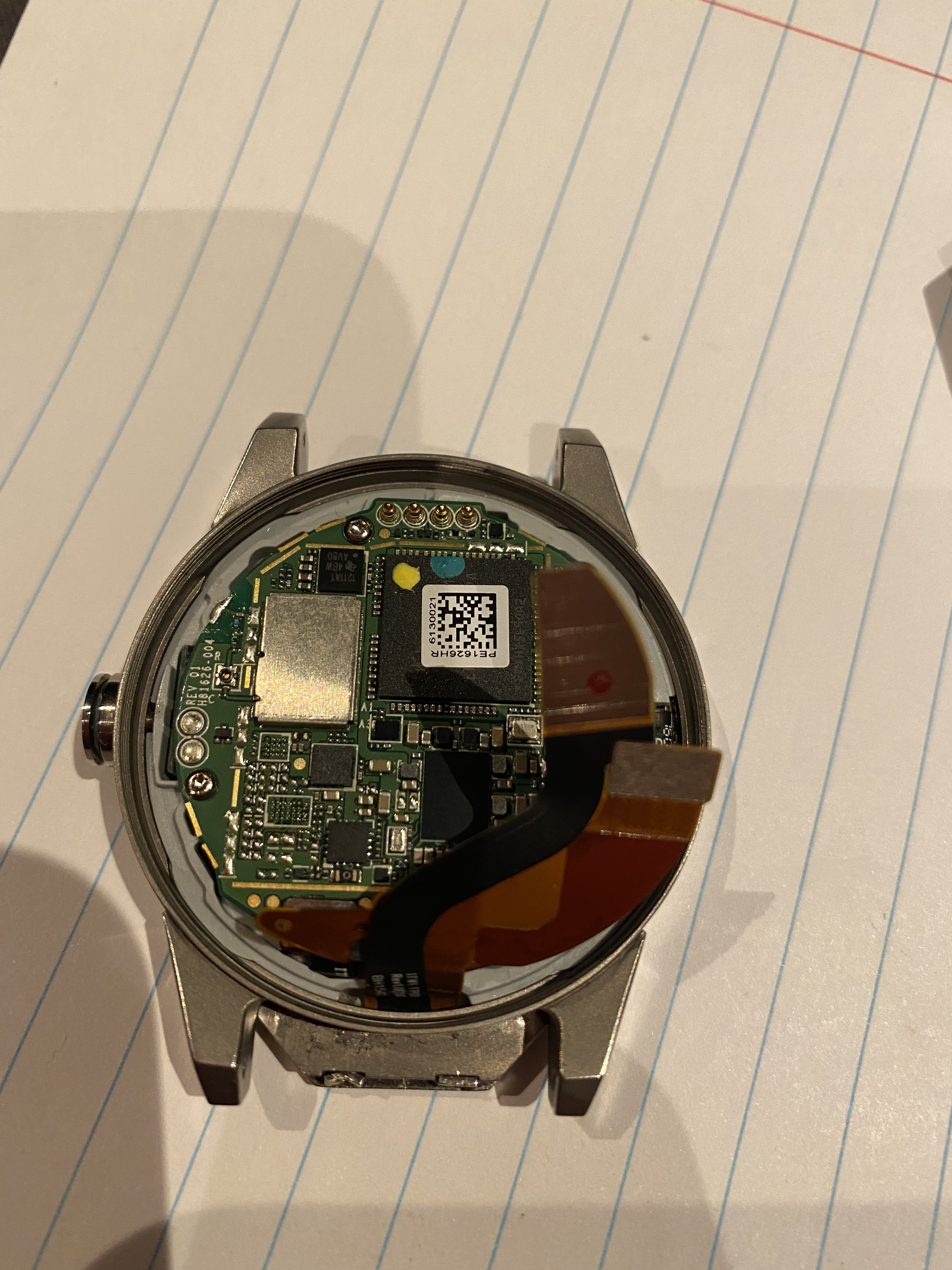

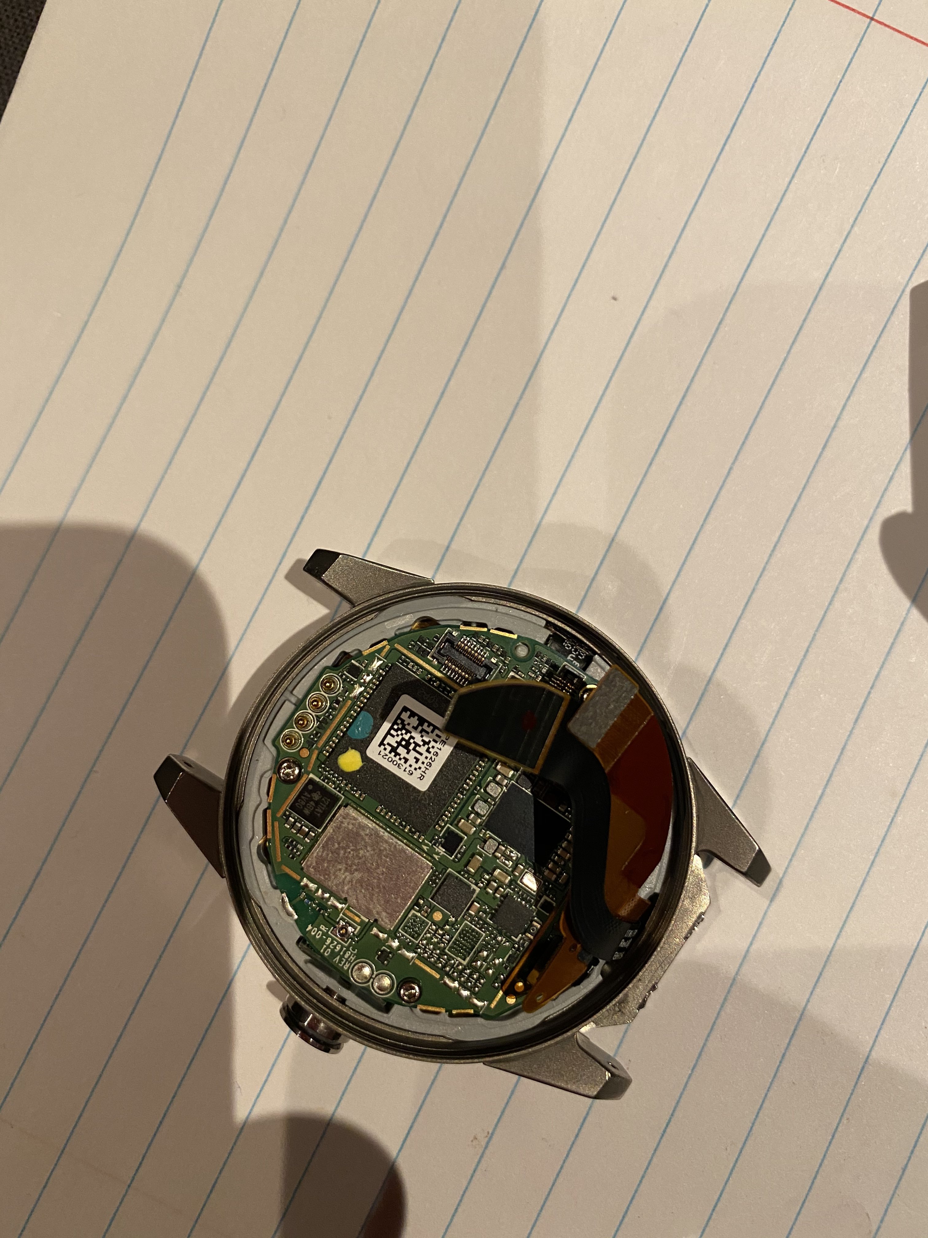

    I found it on aliexpress !! I asked a screen seller, he asked me for reference number and watch model I confirm that he had it and he sent me photos, it is the same as the one on our watch Changing it is extremely easy, I have the clock disassembled, remove the old one with two connectors and place the new one, you have to remove the base plate of the clock to insert the cables, it has 3 screws

    It cost me € 57, I have ginned mine and there is not even to remove the screws, I have pressed a little to be able to make enough space to remove the connections without disassembling anything
