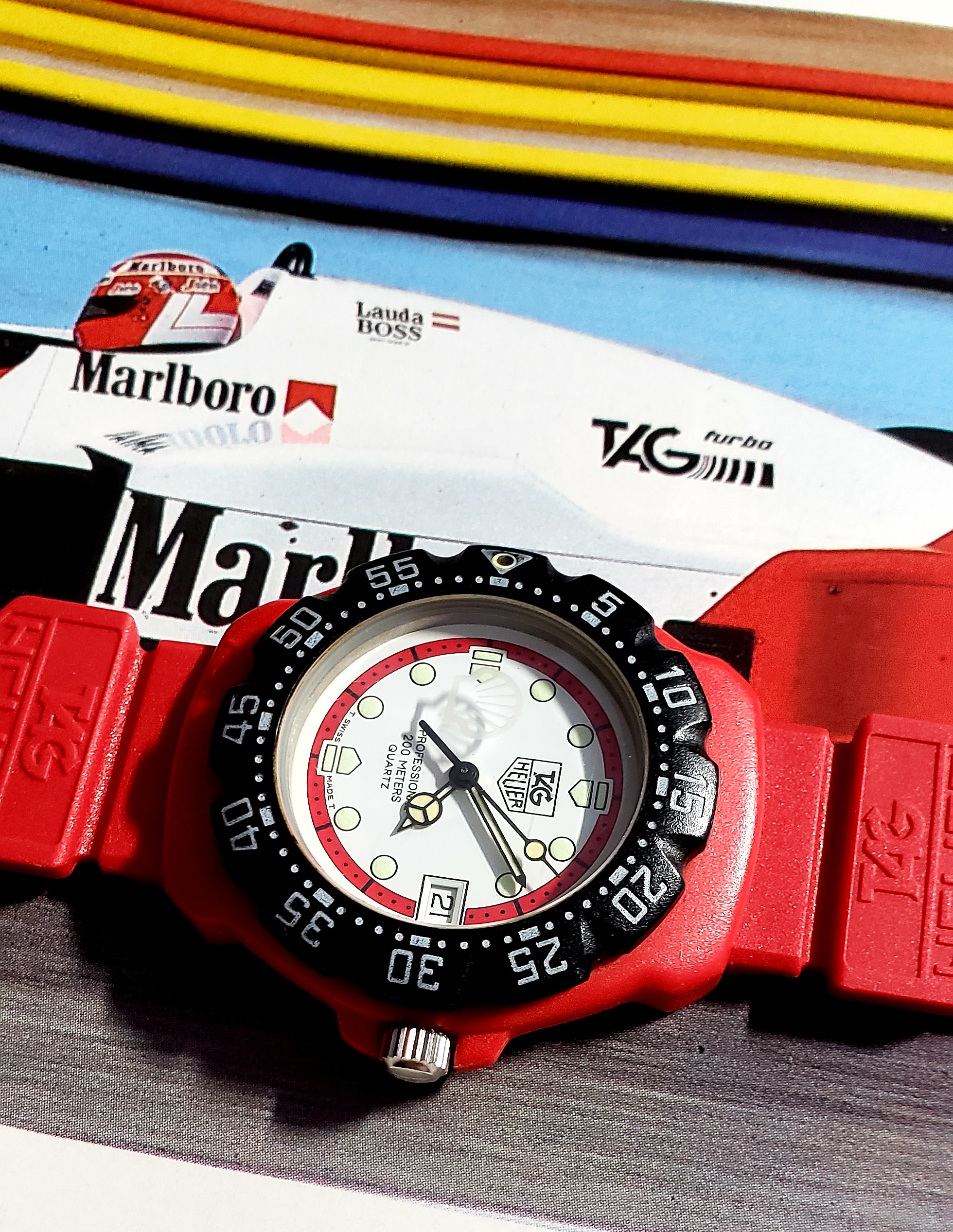

It's cheaper just to swap out the movement rather than an overhaul service. A common problem with these 30+ year old quartz modules is for the coil to go bad, which can be replaced as well.
Here's a pic of my Team McLaren F1.😀
