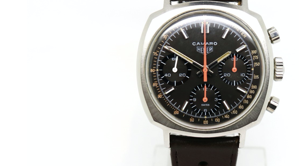

    I'd be grateful for help on whether a 7220 dial is original if it doesn't have the "t" tritium mark on it. All the examples
    I've seen on the camaro websites have the "t" on the Valjoux 72 movements. I did find that later Valjoux movements for example in the Camaro 73643 without the "t" on the dial but not the 7220.

    Hi, there are some dials without the 'T' marking. I'd need to see the dial to say for sure though-are you able to upload a photo?

    Hi Andrew,, I saw your post on CT too.
    I'm aware of this one. I don't see any problems with the lack of 'T'. It is likely within the crossover batch-where there is a mix of 7220s and 73643s (the serial would confirm if you can get it); either way no issue in my mind. :thumbsup:
