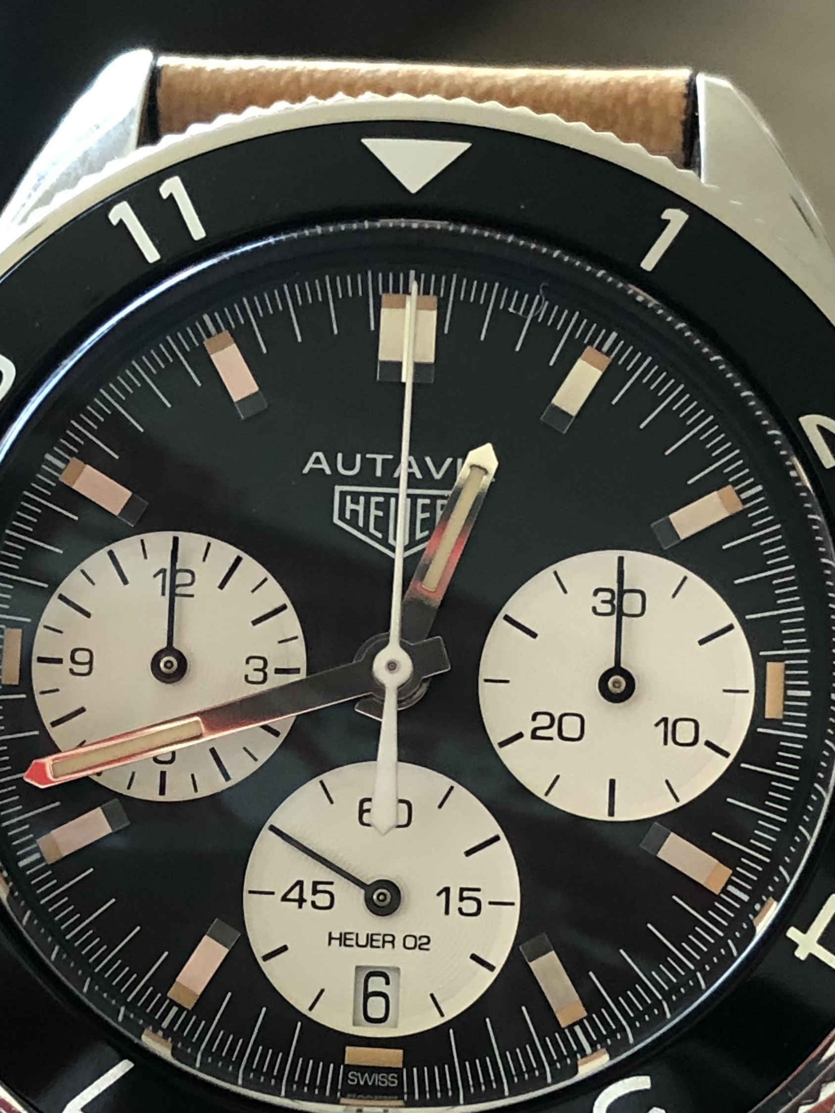

My watch has been repaired by Tag Heuer (I believe in Birmingham) and returned to me as promised after being away for 6 weeks. It was returned in a very nice TAG Heuer branded travel pouch.
All works well, however the chronograph second hand doesn’t quite reset to the 12 position. I’m not happy with this but would appreciate your thoughts. I expected an almost new watch to be returned from a service in ‘perfect’ condition. Expecting too much perhaps?

Indeed, I would send it back to the Customer Service department if it was mine 🙁
6,023
7,258
Send it back. These things happen. They will fix it. I recently had a watch serviced by TAG in the UK and timekeeping was a bit out on it's return. I sent it back in again, they turned it around quickly and now it's perfect. Give their customer services a ring - they are very polite and helpful.
1,413
3,069
Personally, I wouldn’t be bothered by a stop second hand that is off by a 10th of a second (provided the photo was taken from a perfectly vertical position).
That is not acceptable, I would always be looking at the error everytime I looked at the watch. I am suprised it got passed Tag’s quality control checks to be honest.
