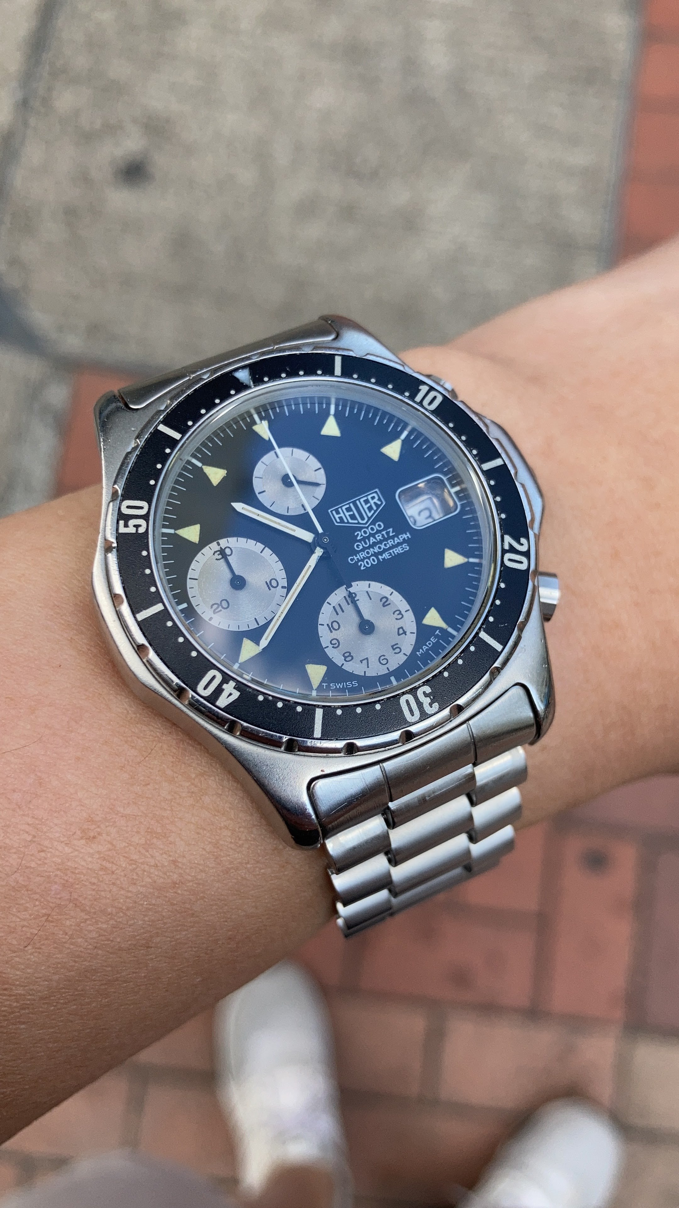

Hello everyone... just joined this forum.
I have a 2000-series quartz chrono. The LWO 185 movement circuit is dead.
Just wondering if it is possible to swap out the quartz module and replace it with an automatic ETA 2892?
Since the Dubois Depraz chrono module is the same for both 185 and 283?

Hi Bobsy. The theory sound right, but not sure if it will work in practice...haven't heard of anyone who has done it successfully, but if you are happy to give it a go, we'd love to see the results!

Recenlty sucess , using an 2892 movement to swap the quartz moement in my 273.006
I have the same watch and the movement is kaput. Did you do the movement change yourself or have a watch shop get it done? I want to save my 2000 Chrono. It's such a classic for me.
Hi Noel. No, it didn't work. I used a 2892 but there are 2 main isssues :
1. The auto movement is thicker than the quartz so the stem does not line up correctly with the crown tube.
2. You need a special sweep seconds pinion with the correct chrono driving wheel attached. These parts are not interchangeable with the quartz version.
I do see the quartz module being sold on ebay occasionally. They are listed as 555.232 or 955.232 and range from $150-200 USD.
