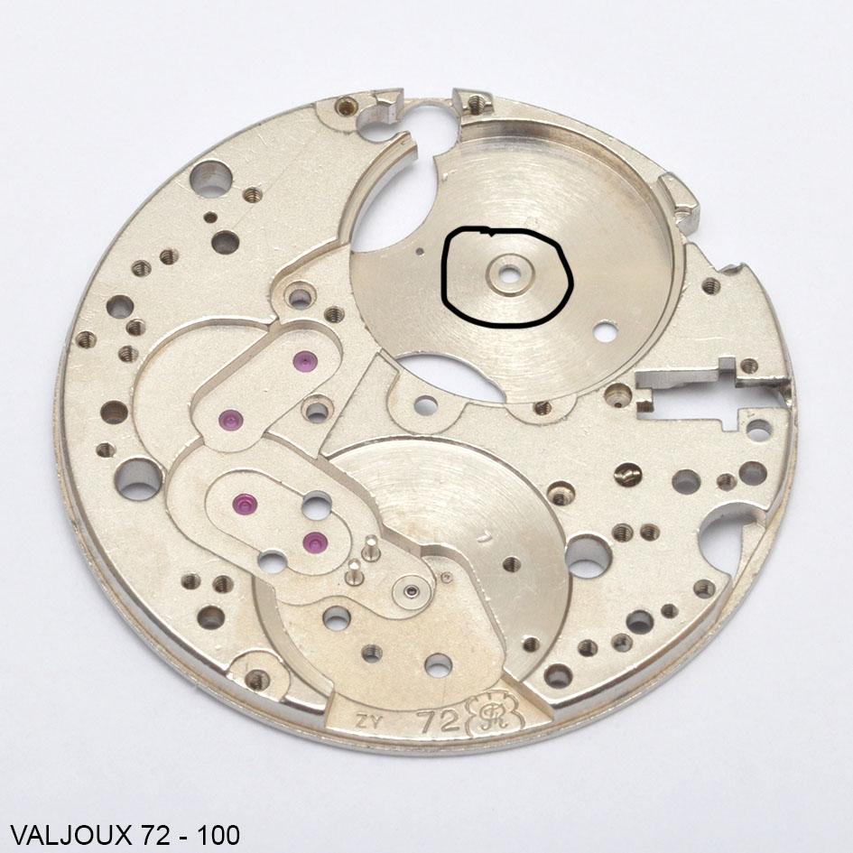

Hey buddy
Sorry for the delay in my response. So I finally found the time to head down to speak to the watch maker in person and it turns out that it is just a one tiny section of the base plate that needs to be reshaped (as circled in the image below). ).
From his professional opinion, he felt that the movement is still in good shape so his advice was not to waste money (as you have pointed out!). The quote of $750 includes a full movement service.
Thank you once again, you have been extremely helpful and I do genuinely appreciate your time. I am now patiently awaiting for him to be done with the repair and service, so that i can be reunited with my watch again.
I hope you (and every other reader on this forum) are having a great week.

Yep, re-shaping one of the pivot holes (can't recall the correct terminology) is a common need for older movements like this, so you should be just fine once he's done 👍
