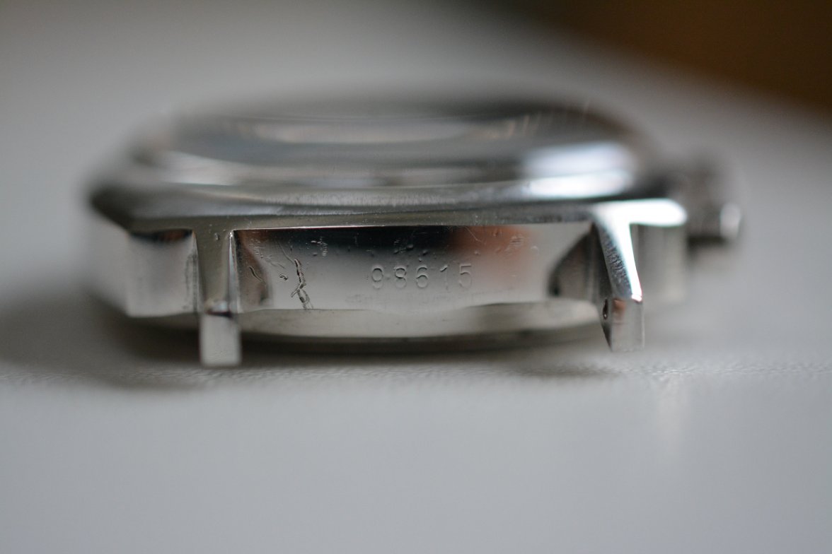

    Couples days ago I buy a vintage Camaro and I noticed that the case has no reference number between the logs. It is normal.???
    Model: Heuer Camaro 45 ref. 9220 NT
    Movement: Valjoux 92
    Kind Regards,
    JB

    No...the reference should be there between the lugs. It may have been polished away...or it could be a replacement case.

    I have a 9220 T with a 5-digit serial number, without the reference between the top lugs... Given the wholly unpolished state of the case in general, I doubt it was polished off. Other early Camaros have been documented without model too, so if the OP's Camaro has a 5-digit serial, it's probably fine

    Where I can find the serial number?

    Between the lugs at 6 o'clock

    I agree that there are few "100%" rules with vintage Heuers...but in the normal course, the Camaro case should have the reference number between one set of lugs and the serial between the other set. There are several reasons why it may not be there:
    - Was polished off/ worn away
    - Replacement case (original damaged and replaced by Heuer)
    - "Parts" watch- remember that Heuer also offered the Camaro case to other brands (although even some Zodiac Camaros I've seen have the Heuer numbers between the lugs)
    Maybe there are some other reasons why it's not there, but in terms of what's "normal", it's definitely normal to have the serial and ref numbers

    I think the model number began appearing sometime around the six-digit serial numbers (well into 1969 or so); most Camaros were made after then and so not only feature 6-digit serial numbers, but the model number between the lugs. This is also seen with later iterations of the first-generation Carrera, which is what leads me to this conclusion.
    The OP has posted that this Camaro features a 5-digit serial, in clearly unpolished condition, so I think it's all right.

    Hi JB-thought I'd help if I can! Thanks also to @abrod520 for his flattering introduction! I agree that it seems to be correct. I have researched a lot of Camaros recently and it does seem that a lot of the early examples (with 5 digit serials) such as yours do NOT have the model number. I'm aware of your particular Camaro and it came from a very reliable and knowledgeable seller :) , described as 'original and untouched' condition, which I believe. Again, this just underlines it as one of the examples with no model number. I would say enjoy it and don't worry too much about the missing model number-you are not alone!
