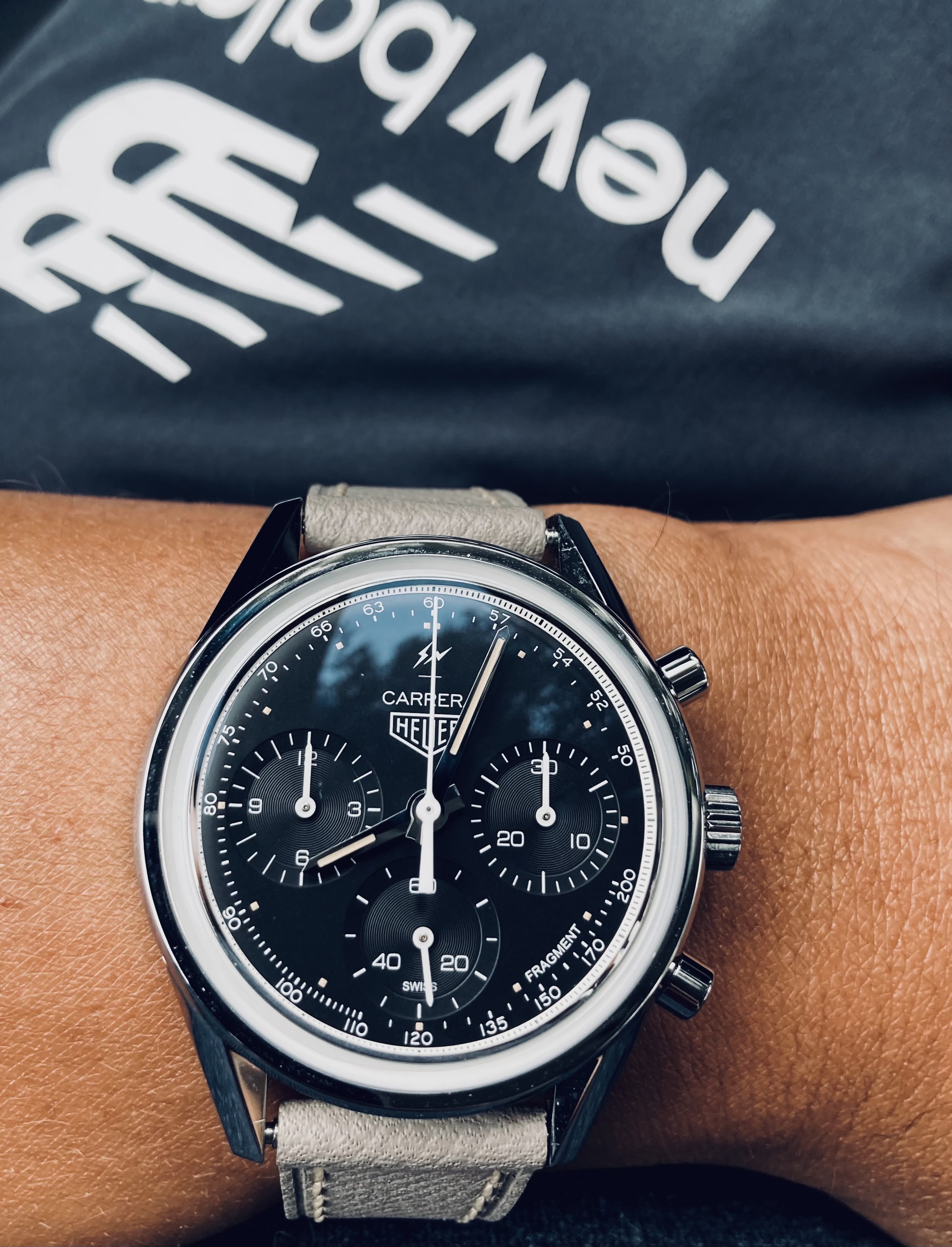

my Carrera Fragment is accurate as ever after service.

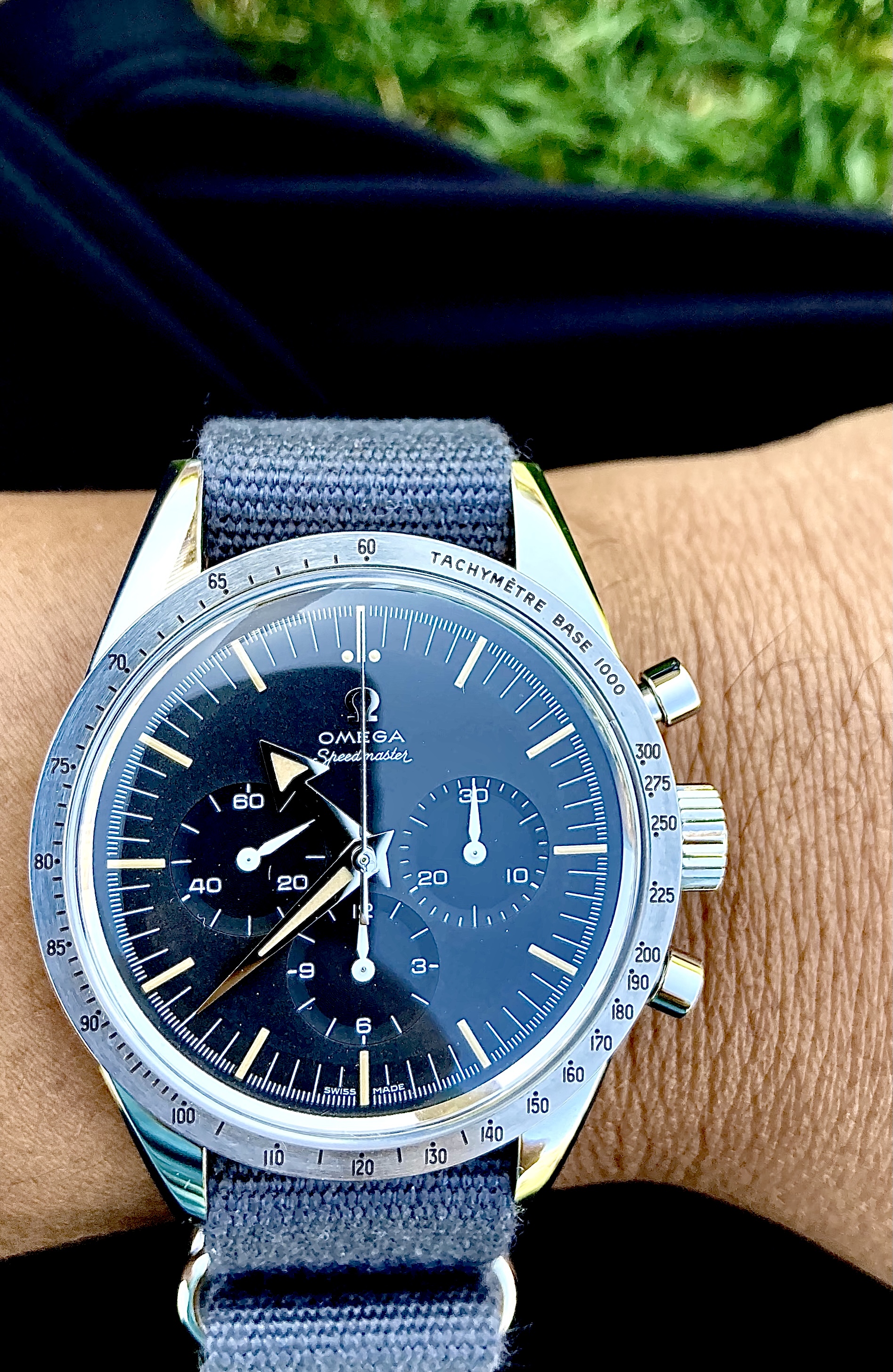

Because it was replaced with an Omega? 😕 Or did you share the wrong pic? 😵‍💫
you noticed that, eh?
There was I looking for some hidden meaning, simply the wrong picture::facepalm1::
And here I thought I missed something "inside knowledge" when I saw your original response. 😀
