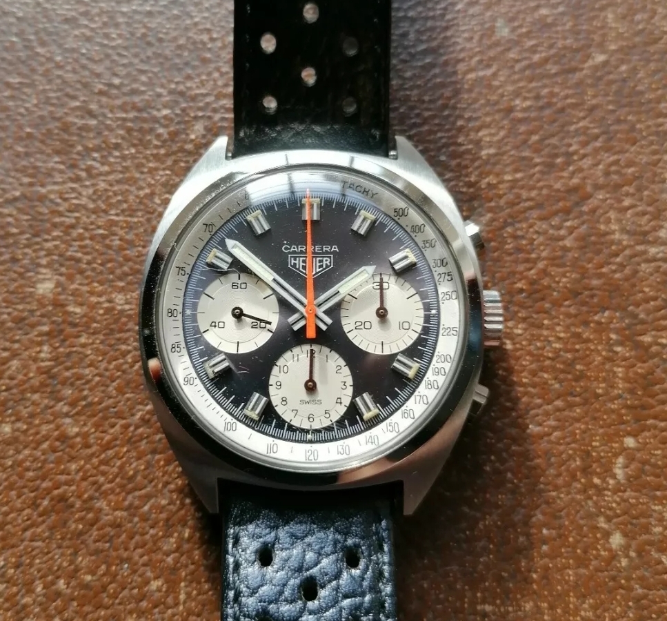

    Evening guys
    Spotted an interesting 1970s Heuer Carrera 73563 N with a second revision dial. I am not sure about the tachymeter ring however. I've heard that a lot of cross reference borrowing was going on back there but this looks more like the ones you would find on the two-sub-dial types like the 1153s.
    Anything to worry about?
  2. abrod520
    abrod520 Apr 26, 2020
    11,218
    35,254
    The tachymeter ring as far as I know is the same part across the automatics / two-registers and the manual wind models. In the case of the second execution, I'd expect to see the tachy-at-1 version like the above more often than the earlier, tachy-at-3 version. Can't guarantee it's absolutely original to the watch, but it would be correct in my opinion
