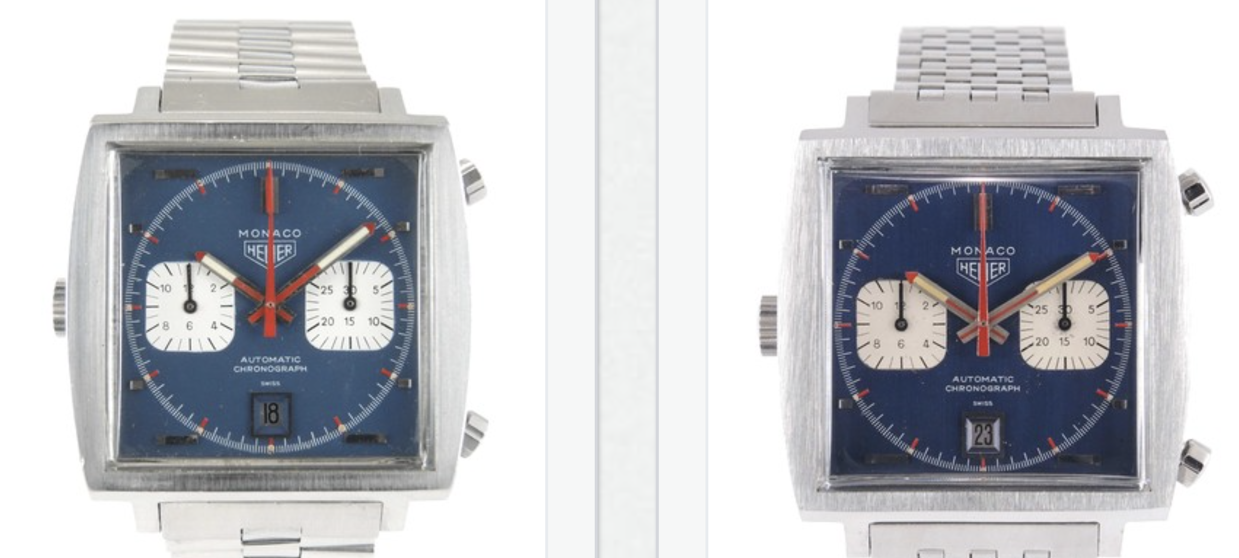

    Hey Cal 11,
    Can 1133B owners comment on this. I need a 1133B in my life.
    Please ignore the case condition. I'm asking which dial, hands and pushers are more original?
    Left or right Monaco?
    Why is there such discrepancy in dial color in same reference?
    Thanks all.

  3. abrod520
    abrod520 Nov 1, 2020
    11,260
    35,471
    Copy/ pasting my response from OF:
    In this case I think the discrepancy is heightened by the different lighting conditions of the two photos. If it's the same seller, ask for side-by-side photos in the same lighting to compare.
    However, the earlier Monacos had a dark blue metallic dial whereas the later production runs had a flat blue dial - it's possible that the example on the right above is what's known as a "Transitional" dial (from the very first batches, to the standard production later on), while the left is a "standard" production model.
    Hands are murkier, but they appear correct for both models - we see the thinner lume style on earlier models, and the wider ones on later models. The wider hands could also be service parts, but this is unclear.
    Crown and pushers are too hard to tell in these photos, you'll need shots of each side of the case to compare. but, all Monacos had fluted pushers and both of these do, so no immediate red flags.
    NGO1 likes this.
  4. Calibre11
    Calibre11 Editor of Calibre11.com Staff Member Nov 8, 2020
    7,121
    15,030
    There are two distinct dials- the first ones are a deep metallic blue and the second series (the better known) is a flat lighter blue. Both are correct.
    The case on the left has definitely been polished (over polished) and I would say the same for the case on the right (OK, I know you said to ignore this)
    Basically, I agree with @abrod520 ;)
    NGO1 likes this.

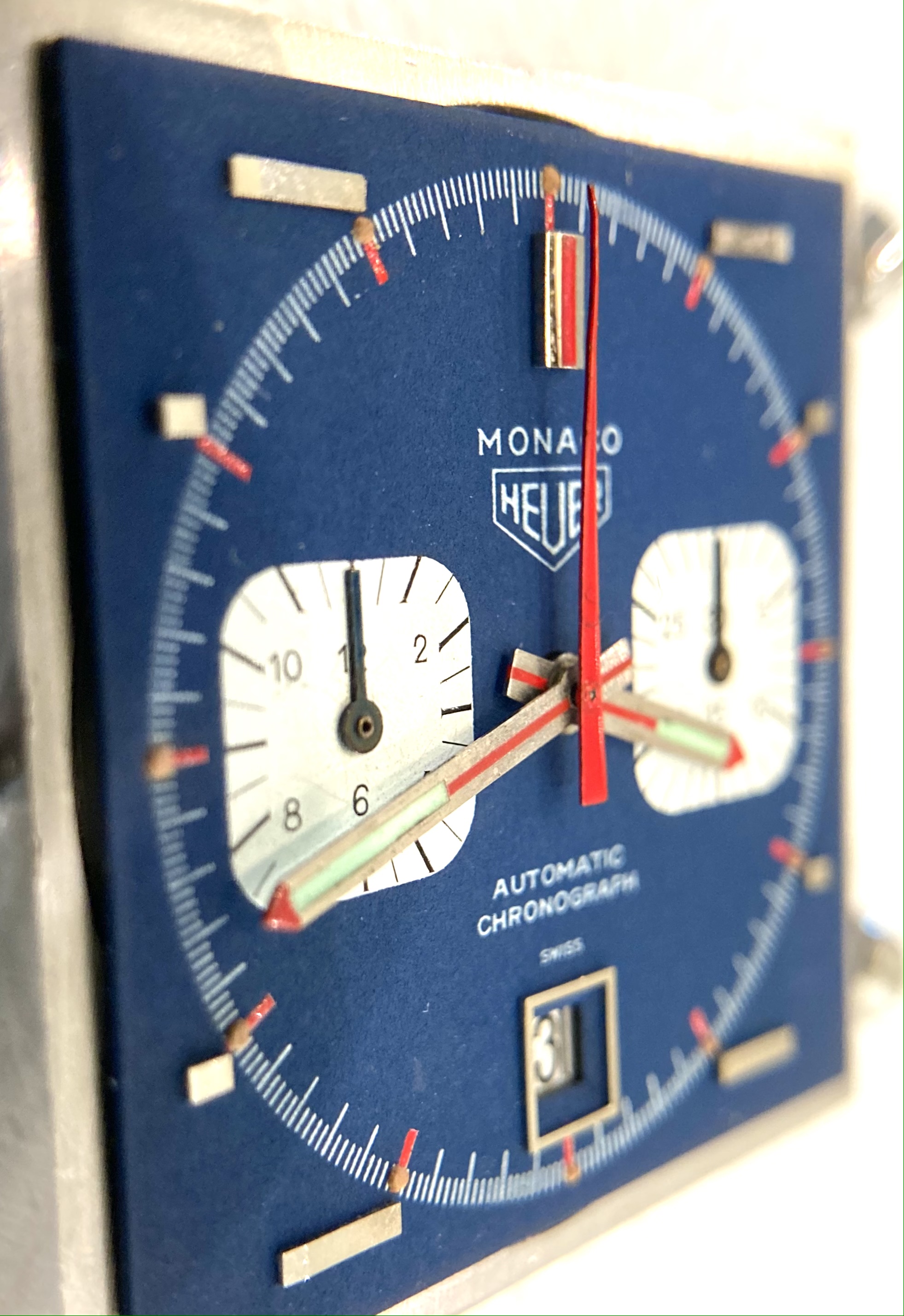

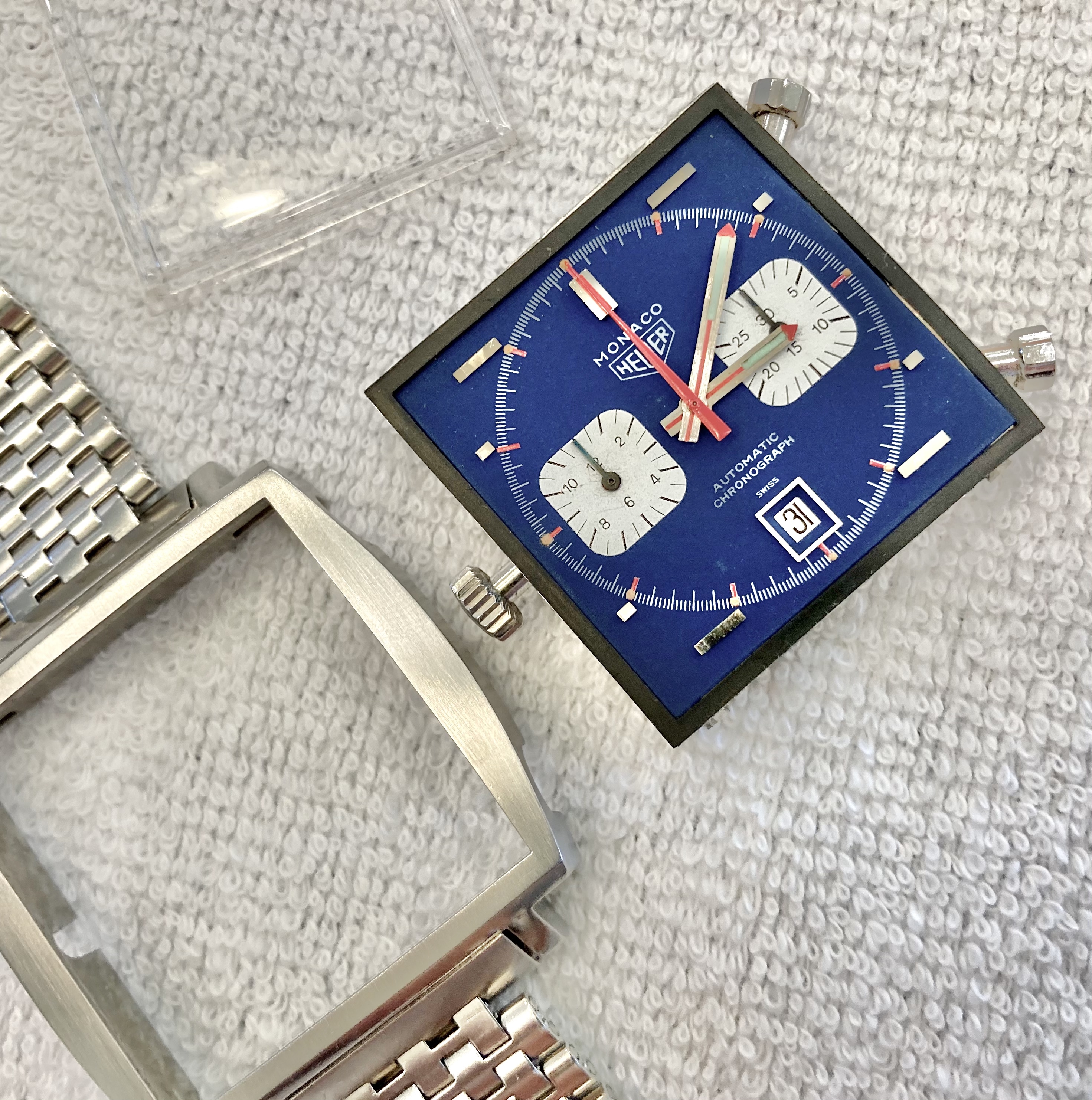

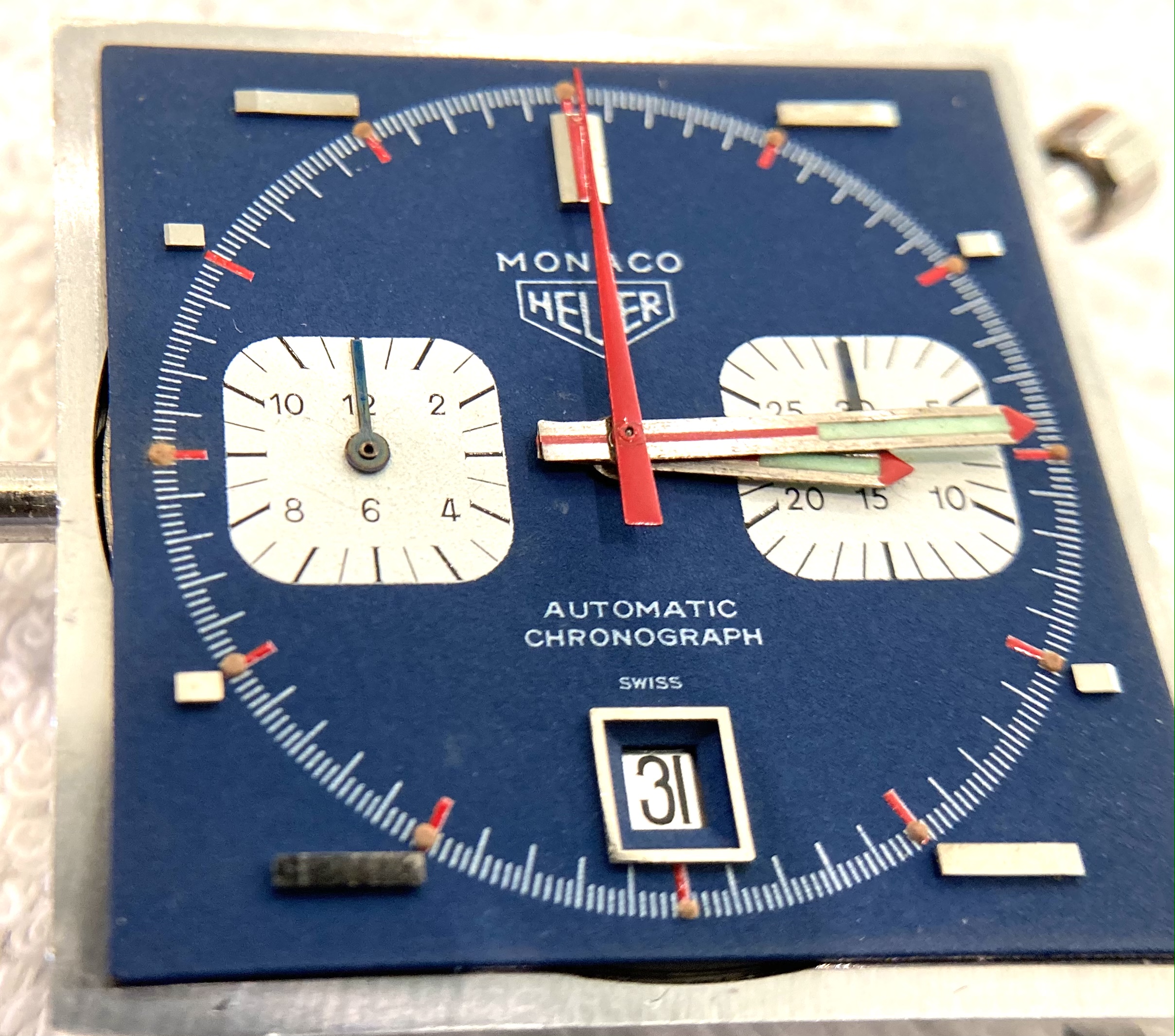

  5. NGO1
    NGO1 Nov 19, 2020
    1,308
    6,019

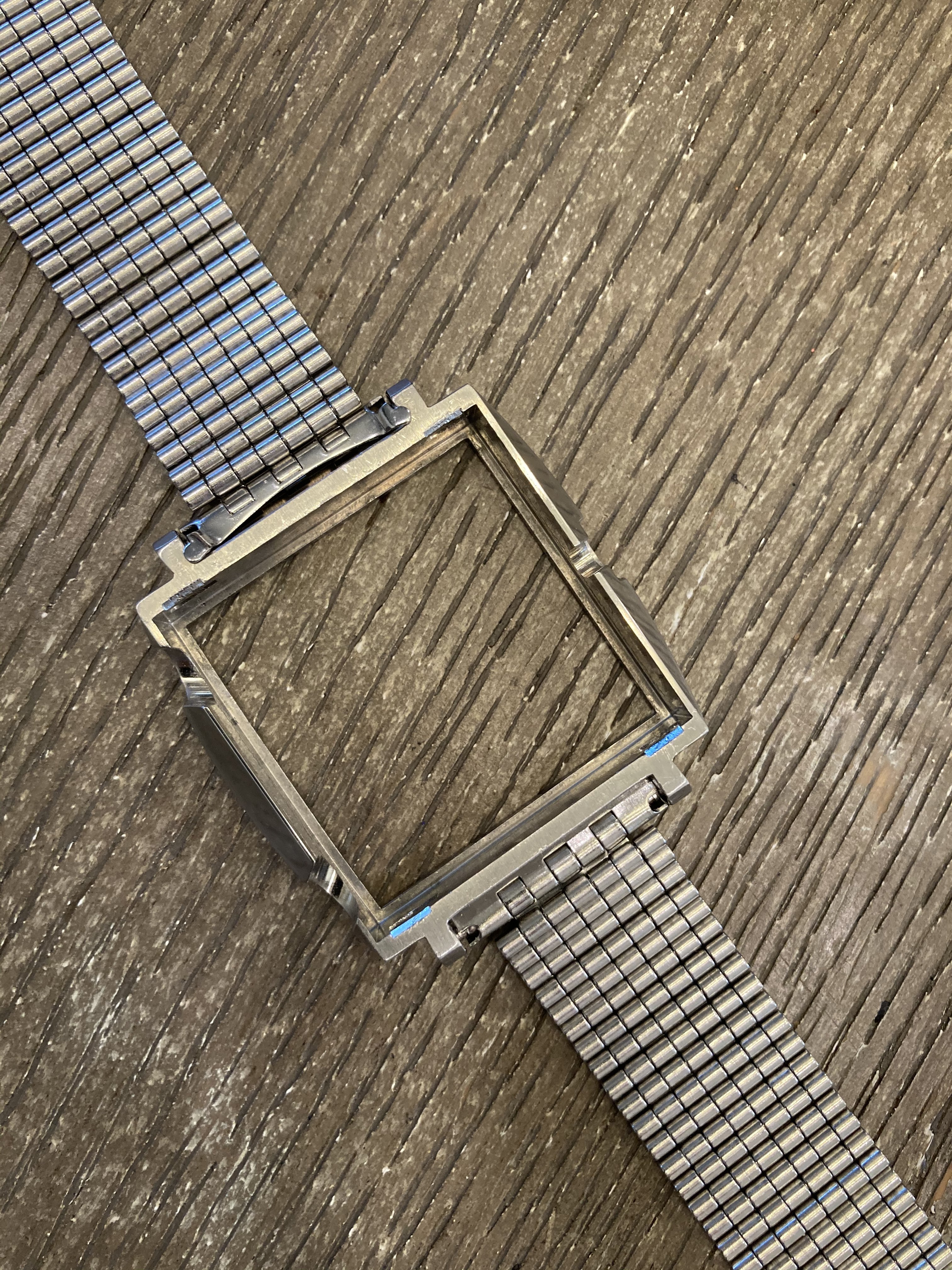

    She arrived today.
    Looks better than expected.
    Can someone advise me how to release the crown to free the movement from the case?
    411B47E2-BC54-44AC-8828-143FFEFCA068.jpeg 67E7A098-D659-4E0C-8BC4-5C0DD31A50C2.jpeg 9B654761-812F-4A5C-ADDE-9E3AB7DE2E50.jpeg

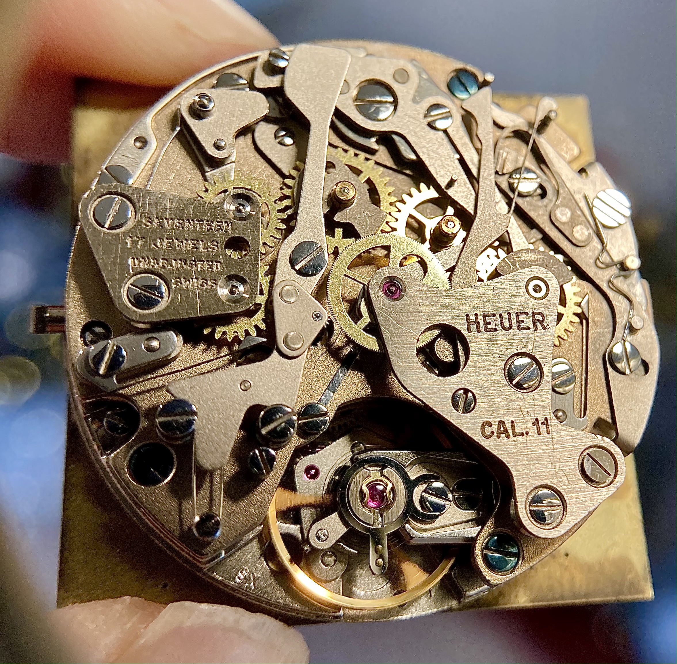

  6. NGO1
    NGO1 Nov 19, 2020
    1,308
    6,019
    This is the video I found showing movement freeing from case. The guy simply pulled off the crown.
    I can’t easily do that with mine. Is there a step before that I missed?
  7. El Matarife
    El Matarife Nov 20, 2020
    584
    458
    I love how the case of the original Monaco is assembled, and how the movement sits within a milled circular recess. The way the crown came off in that video it's almost as if there was no stem installed? I know nothing about old Monaco's though, they are a beautiful mystery. I wonder if TAG would ever make a new Monaco that is put together that same way?
  8. abrod520
    abrod520 Nov 20, 2020
    11,260
    35,471
    Probably not - the reason for the Monaco's strange construction was because they wanted to ensure it was water-resistant which was very difficult to do with square cases at the time. You can see the lengths they went to, which was ultimately not very successful at that! There's also a very common gasket melt issue around the dial that is fortunately not present in this example

  10. NGO1
    NGO1 Nov 20, 2020
    1,308
    6,019
    Took a tremendous amount of force to pull off crown to free the movement from case. Here is the movement shot.
    3A0360CF-03B4-4ED9-9820-28FCDD3977CF.jpeg 14E0E0FD-323C-4BBF-9EA7-EFF43FF3EE1D.jpeg

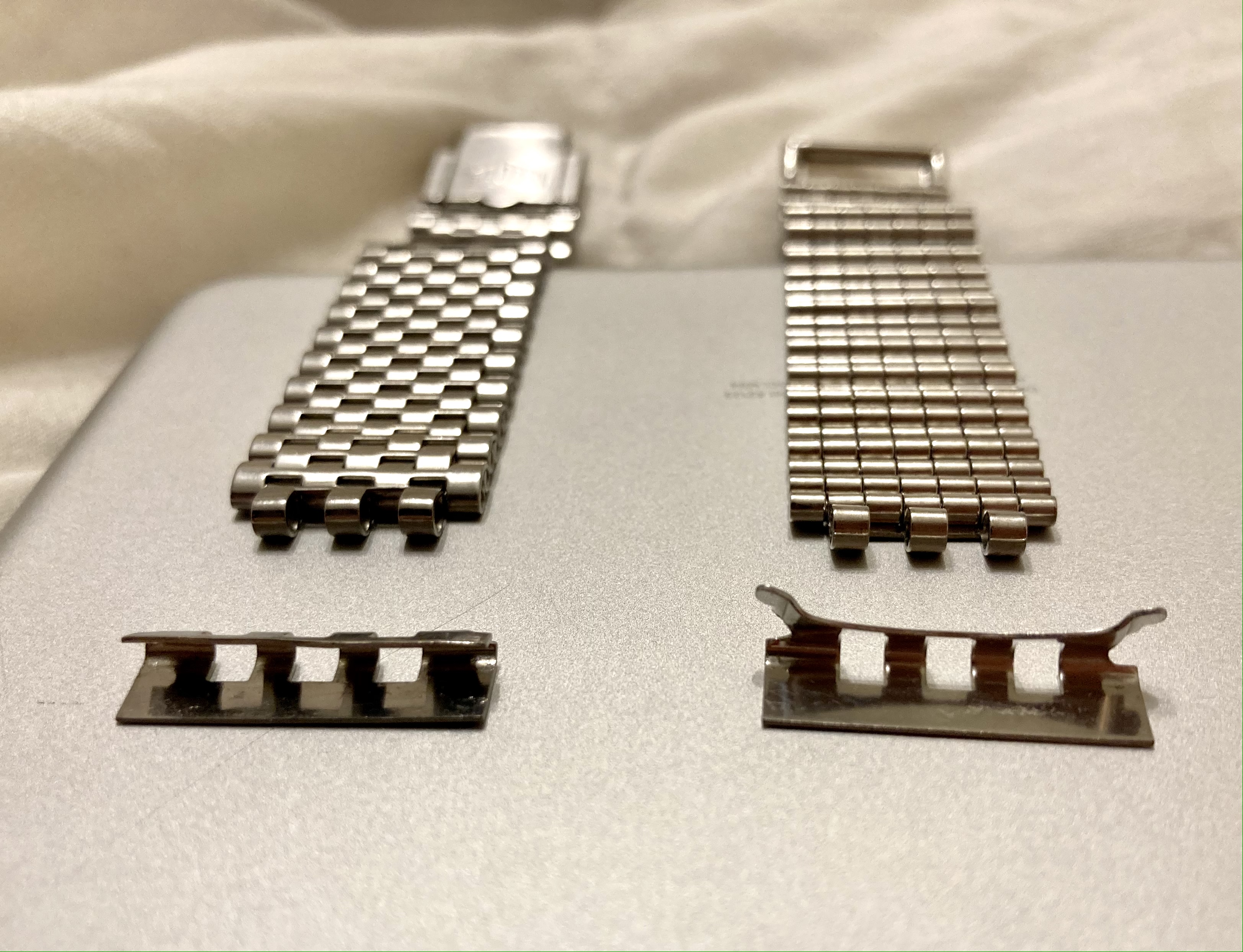

  11. NGO1
    NGO1 Nov 20, 2020
    1,308
    6,019
    My bracelet end pieces are different. Anyone with an NSA bracelet can comment?
    DF3AE7F0-80EE-4D25-934D-9CCD60FA3DD3.jpeg 844DF56E-DBCD-4910-8189-9E335EF1A169.jpeg
