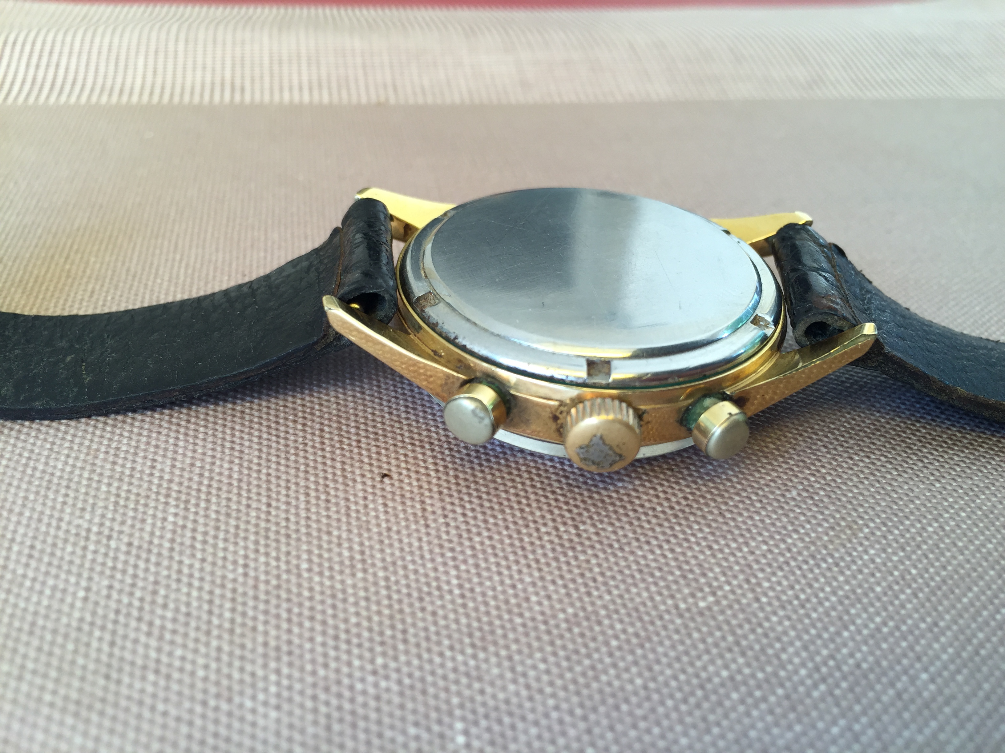

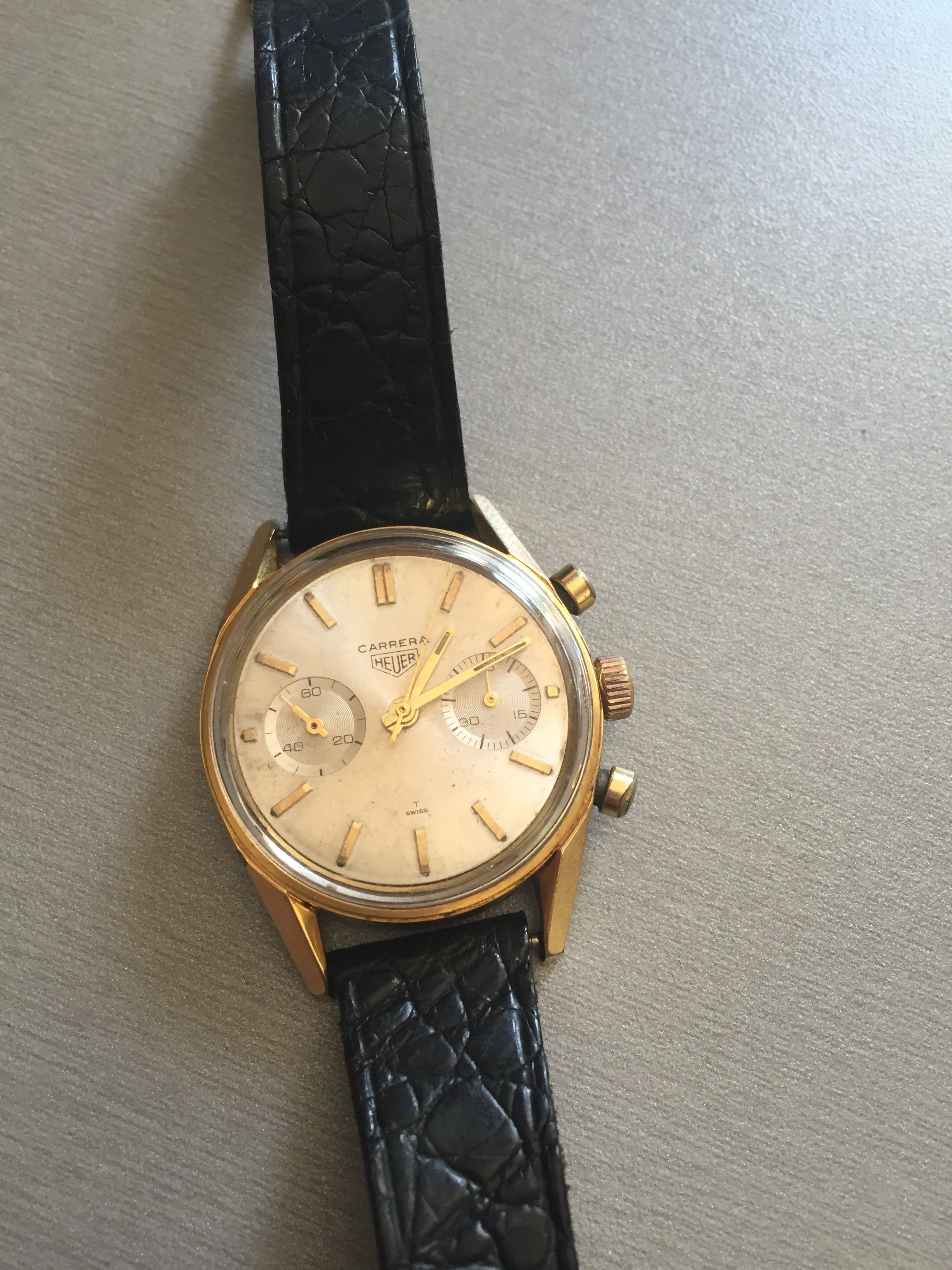

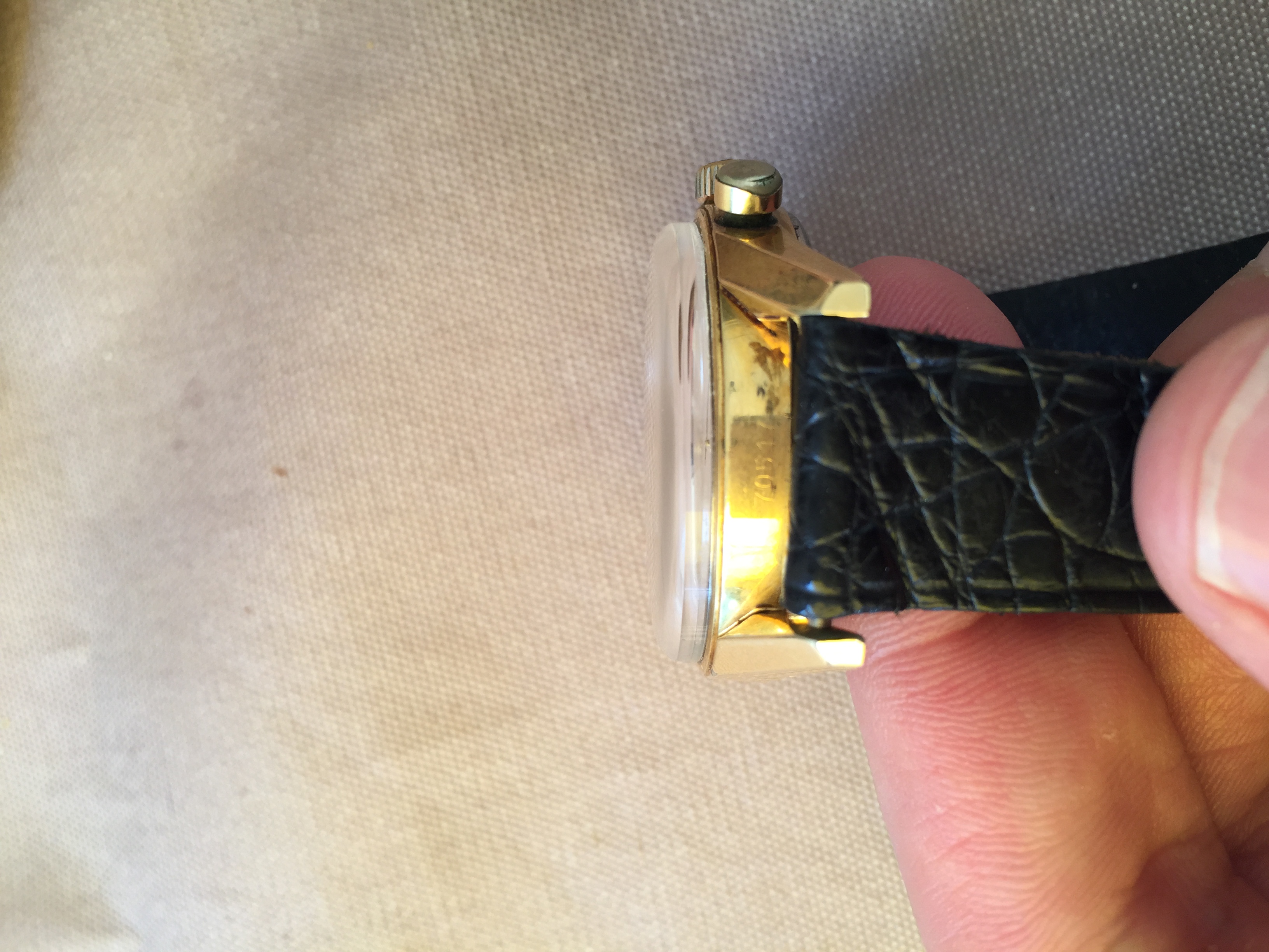

    Hi Guys,
    I just found a watch that my Grand Father had in his collection (among other nice vintage Omega's / Rolex).
    I tried to find it on many forums but I can't get the exact same reference
    The case display ref 70517, and on the other side 'GoldPlated20k' (I'm not sure about the letter K)
    Does someone ever heard of this watch / series?
    Thanks for your help
    Charles
  2. Calibre11
    Calibre11 Editor of Calibre11.com Staff Member Jul 12, 2015
    7,121
    15,031
    Hi,
    You have a Carrera Reference 3648S. This is a Carrera 45 minute chronograph powered by the Valjoux 92.
    The 20 refers to the amount of Gold plating- 20 microns.
    The number you have given is the watch's serial number rather than the model reference number.
    Your grandfather had great taste!

    Very nice piece, is it missing the outer bezel ring around the dial?
  4. Calibre11
    Calibre11 Editor of Calibre11.com Staff Member Jul 13, 2015
    7,121
    15,031
    Good spot- yes it is. Photo from Heuerville

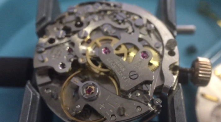

    for your information, the movement is a Landeron 189
  7. Calibre11
    Calibre11 Editor of Calibre11.com Staff Member Jul 25, 2015
    7,121
    15,031
    Are you sure? Landeron 189 has a date wheel and is used in this Carrera

    The specialist told me is it a longeron, think he is wrong ?
  10. gophishin
    gophishin Jul 27, 2015
    492
    1,060
    It's a valjoux 92. The chapter ring shouldn't be too difficult to find, but a correct, gold, running seconds hand for the 9 o'clock register....

    i strongly think that it's a Valjoux 92 in this watch. Not a Longeron. if its not been changed during the years?
    the original movement should be a Valjoux 92.

    Any pictures of the movement.? (i wouldnt recommend open it yourself if you not know what you are doing)
  14. cbworks
    cbworks Nov 10, 2015
    5
    They just sent me a quick footage of the movement, so here is a screenshot.
    It looks great.
    I am now looking at spare parts (like the main crown)
