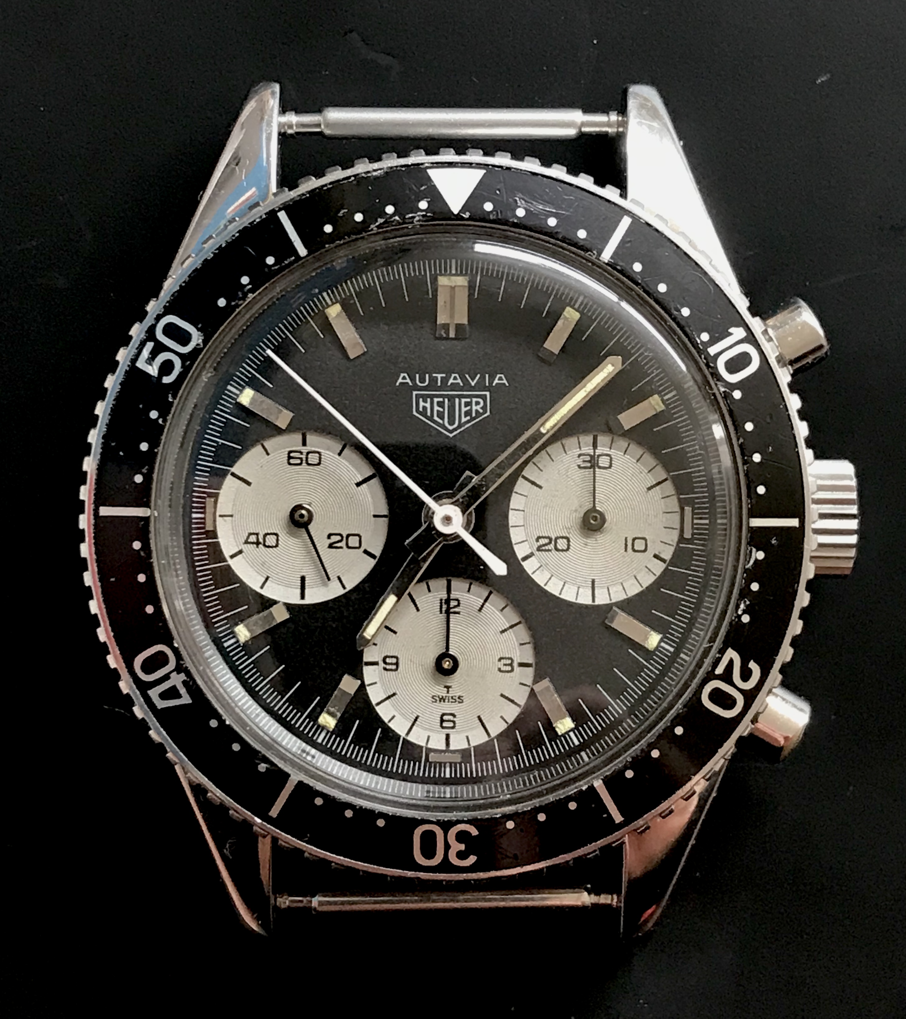

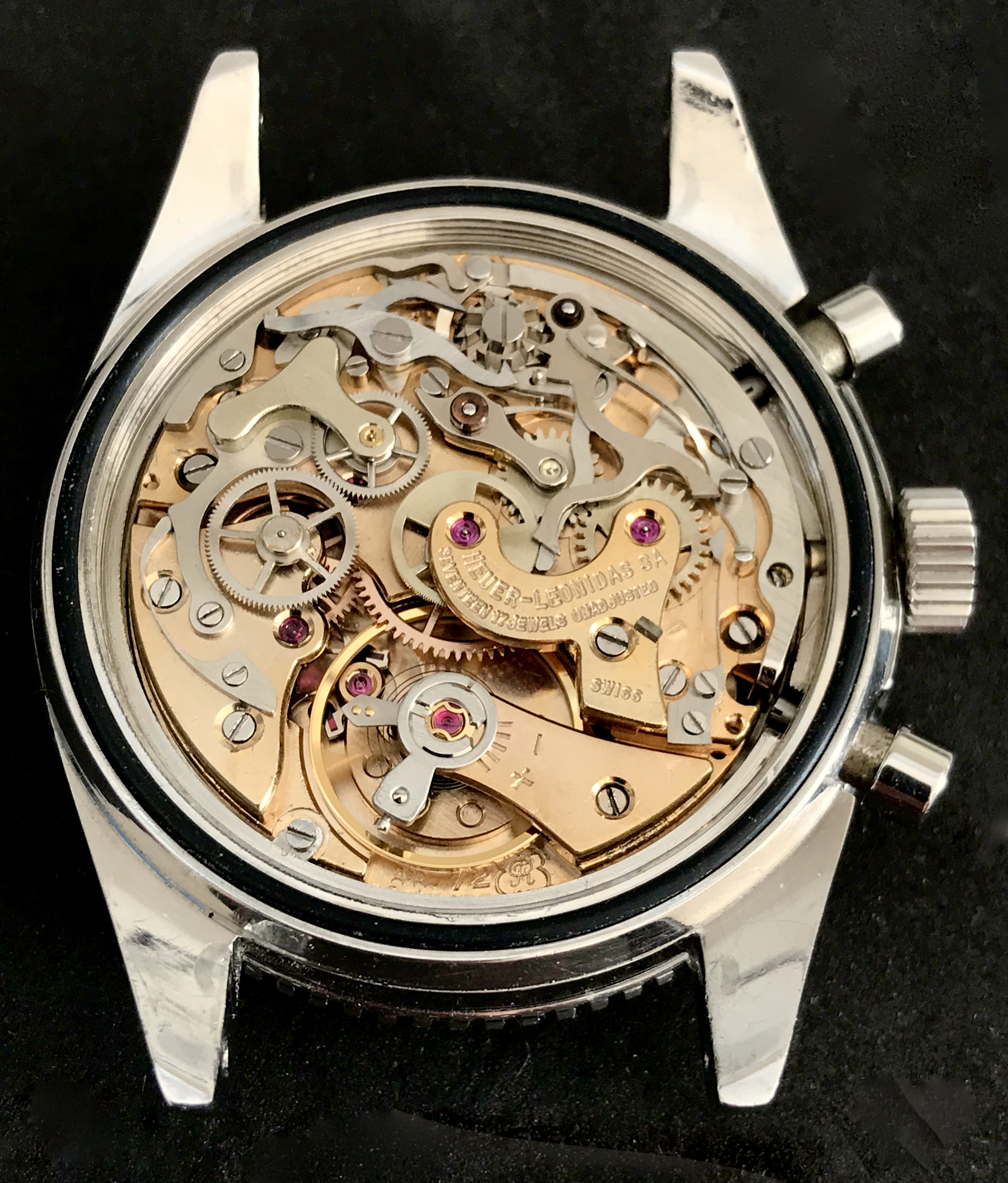

    Hi, I've been directed here from the Omega Forums page with a question regarding the movement in my Autavia 2446M. Basically, is it accurate to describe it as a Jochen Rindt model when it has the movement shown (as opposed to the predominantly silver one)? Is it even the correct movement for a 2446M? fullsizeoutput_15a6.jpeg fullsizeoutput_15de.jpeg

    Enicar movement,you can spot the letters A-R under the balance wheel..AR=Aristo Racine ENICAR.

    And inscriptions on central bridge fakes.

    I have never seen a Heuer movement like that I'm afraid. The bridge looks reprinted and the part colours are incorrect for a Heuer V72, so I suspect this was from another brand and a 'new' bridge made for it.
    I think I'm right in saying the sweep hand isn't correct for this model either, it should have a thinner tail.
    Sorry. I could be wrong of course so happy for others to chime in.......
    Steve

    ps I realise I didn't actually answer your initial question! As far as I know, the consensus is that the 'Rindt' 2446 did have the minutes bezel such as yours, hence 2446M should be correct. Either way, the points above still apply though. Thanks, Steve
