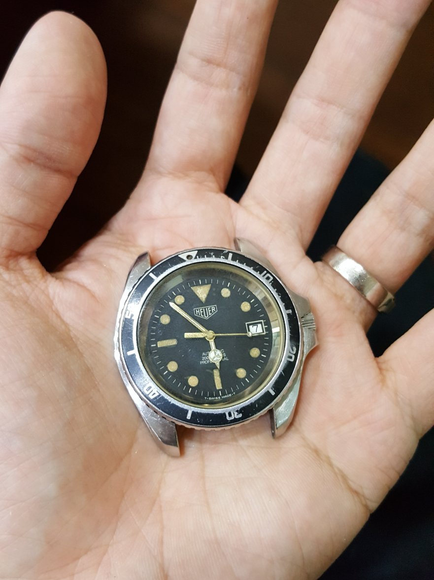

    Hi guys, i am in the process of negotiating what could be said as my grail watch.
    I am in need of this forum expert regarding Heuer 844-2.
    Now, according to the seller, it's all parts original including the bracelet except of the end links. A little disappointing. But i am mainly only concern for the dial.
    Is this 844-2 looks alright ?

    Hi Otto-the 844-2 is a rare beast indeed! It looks good from what I can see. Really need to check the caseback and movement though too.
    There is one on Ebay currently which is comparable.

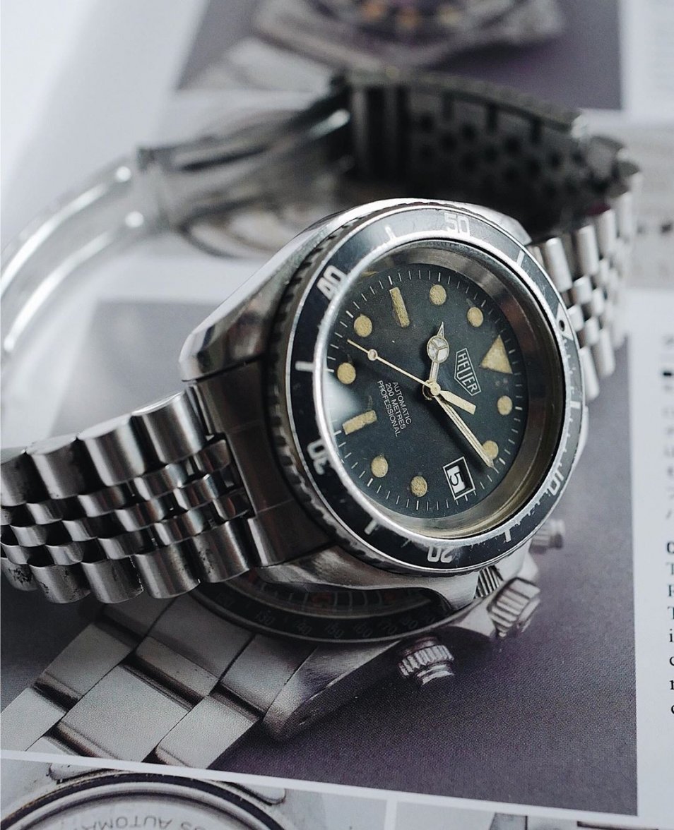

    Should be ETA 2872. Glad it's made it into good hands. (As illustrated in the photo. :rolleyes:)
    Steve

    Yes it is ETA 2872 ! Automatic with quick set date and yes it is non hacking.
    Thanks for the kind words. Really appreciate it. :thumbsup:
    It came with original bracelet but not end link sadly. I feel it a bit wobbly so i opted to use the seller own made brand new leather strap (which he gave for free).
    Hope you like the picture :cool::thumbsup:
