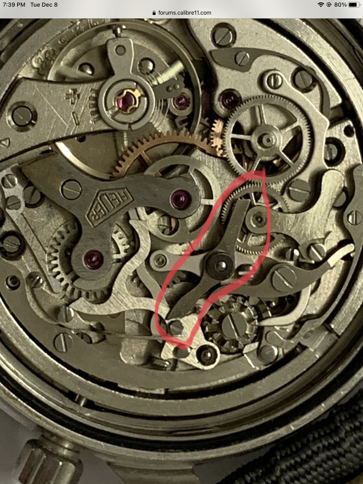

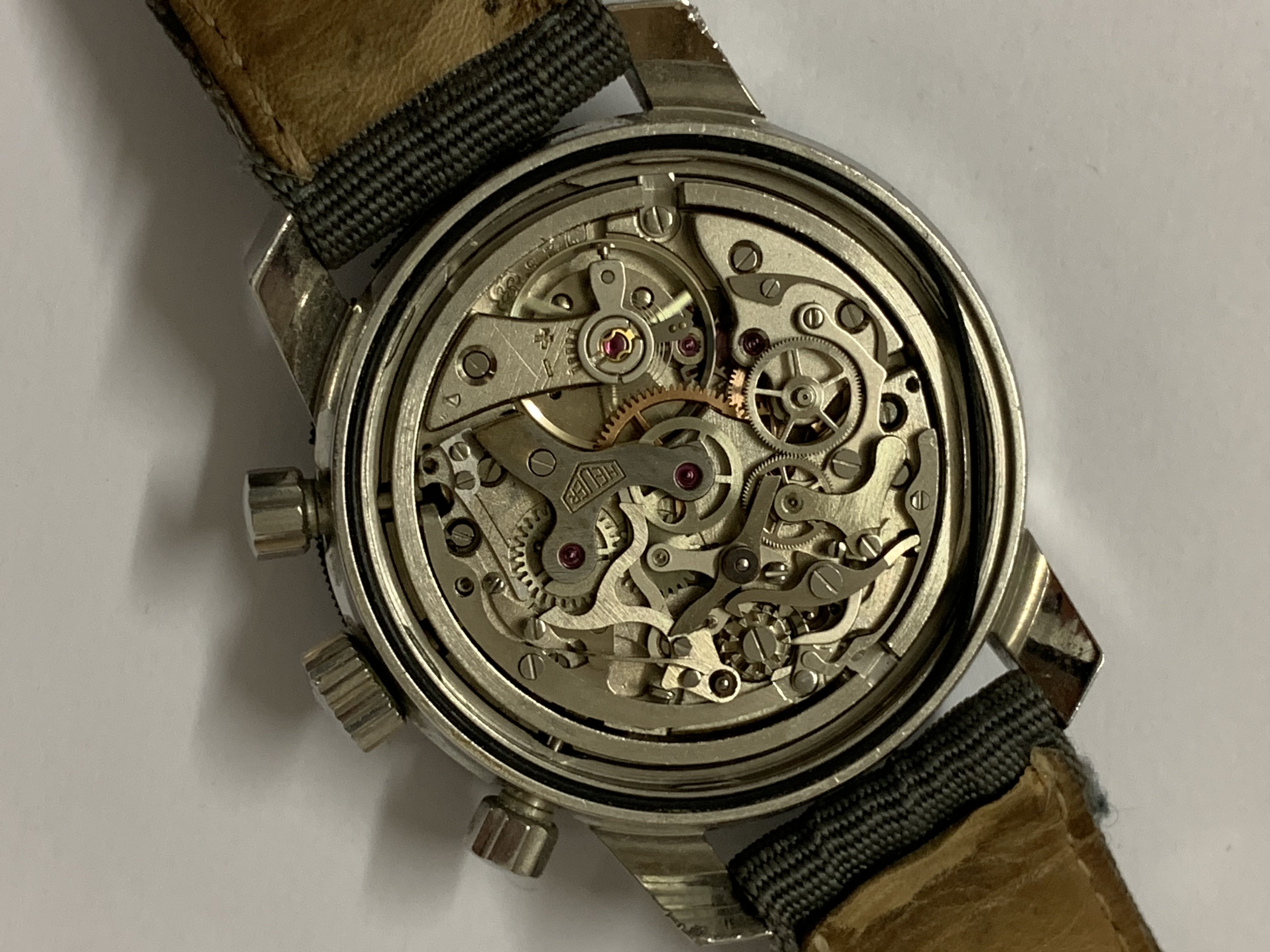

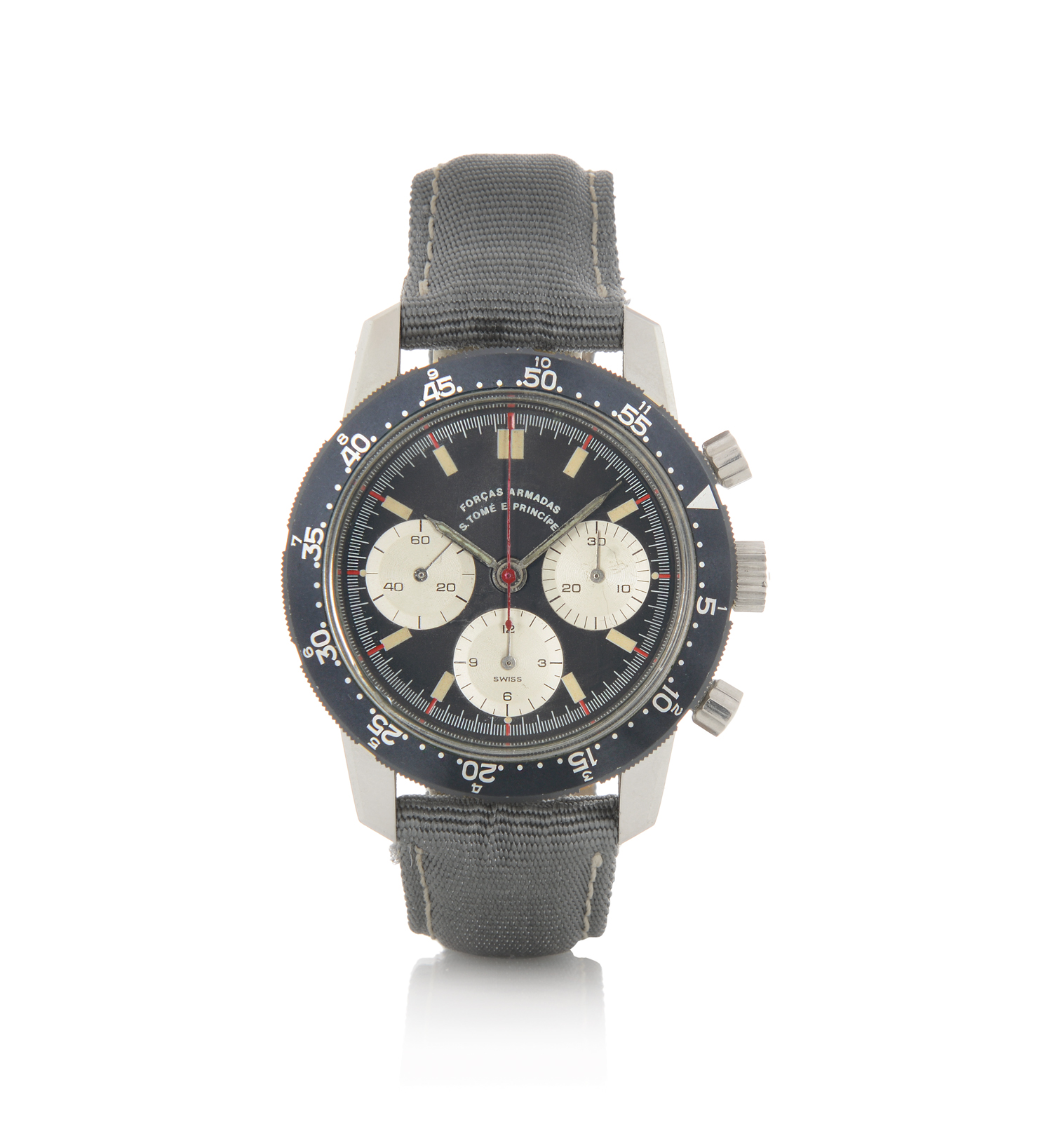

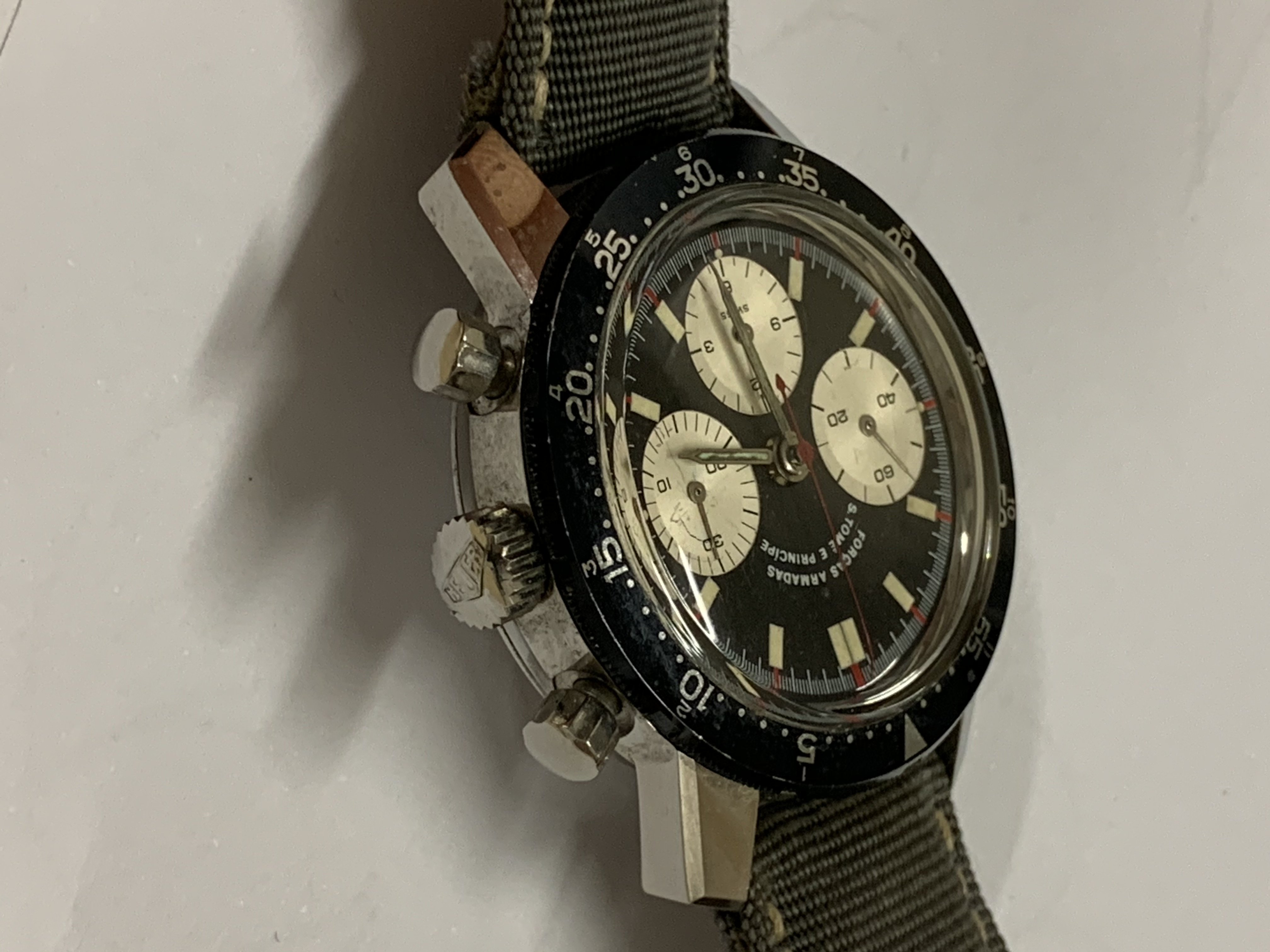

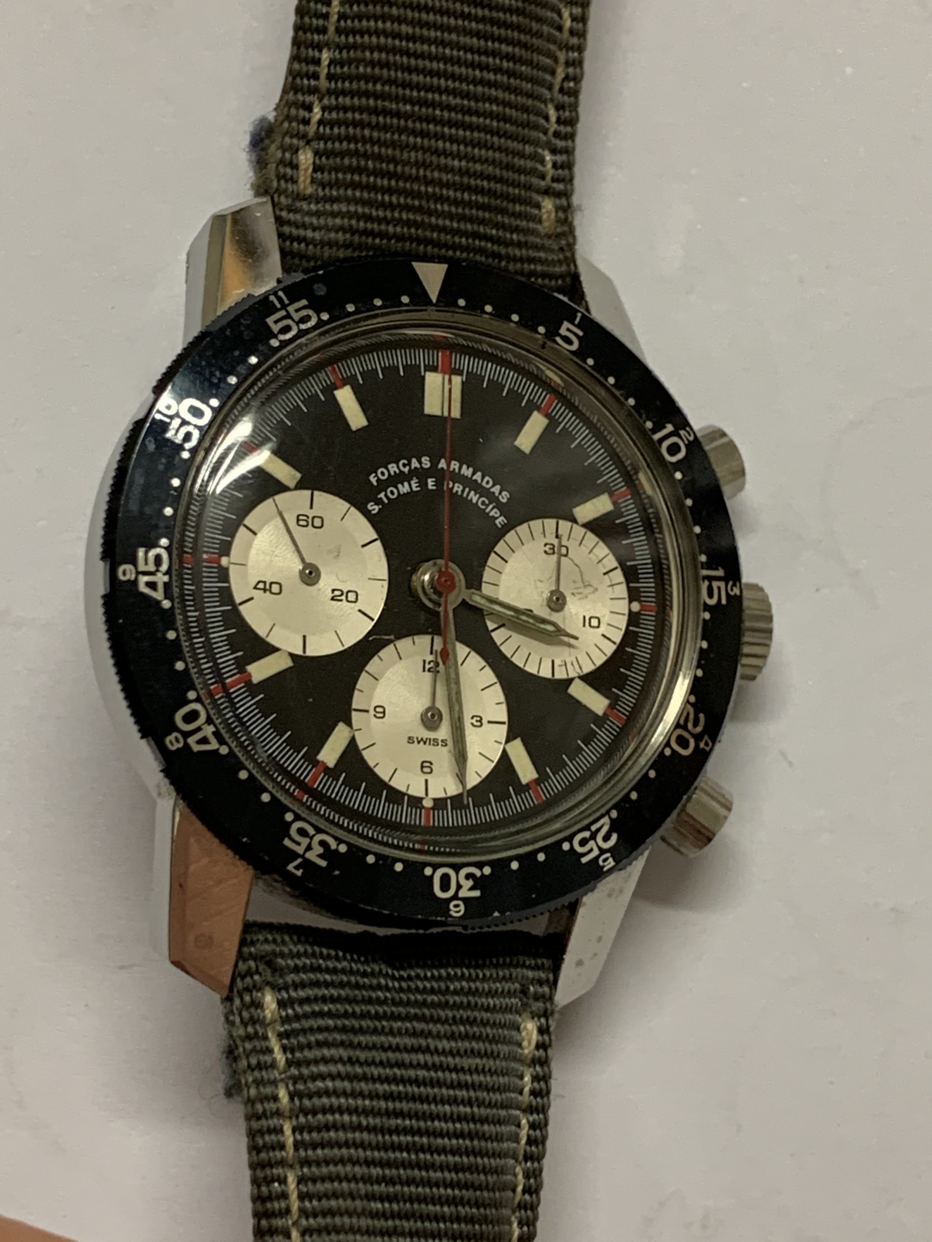

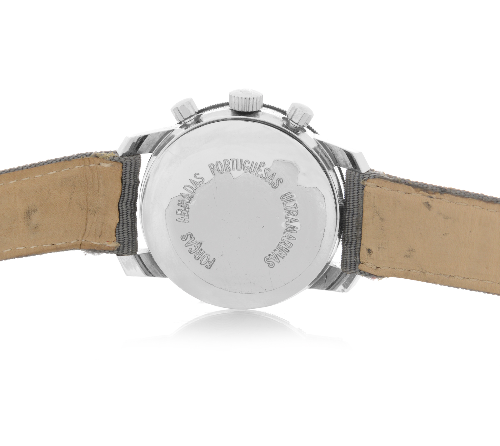

I confess I broke “the law” with this one. I bought it before asking but I wanted to know what you think anyhow.
There’s not too much information (at least that I could find) but I know this one was already discussed as it was a known model. Some relume maybe but it is a military watch that I’ve been hunting for years and to be honest it doesn’t bother me a bit. Is everything else correct?
By the way, being Portuguese this one speaks to me more than other military watches and I paid 11.250 all fees included
Thank you in advance for your help
277
353

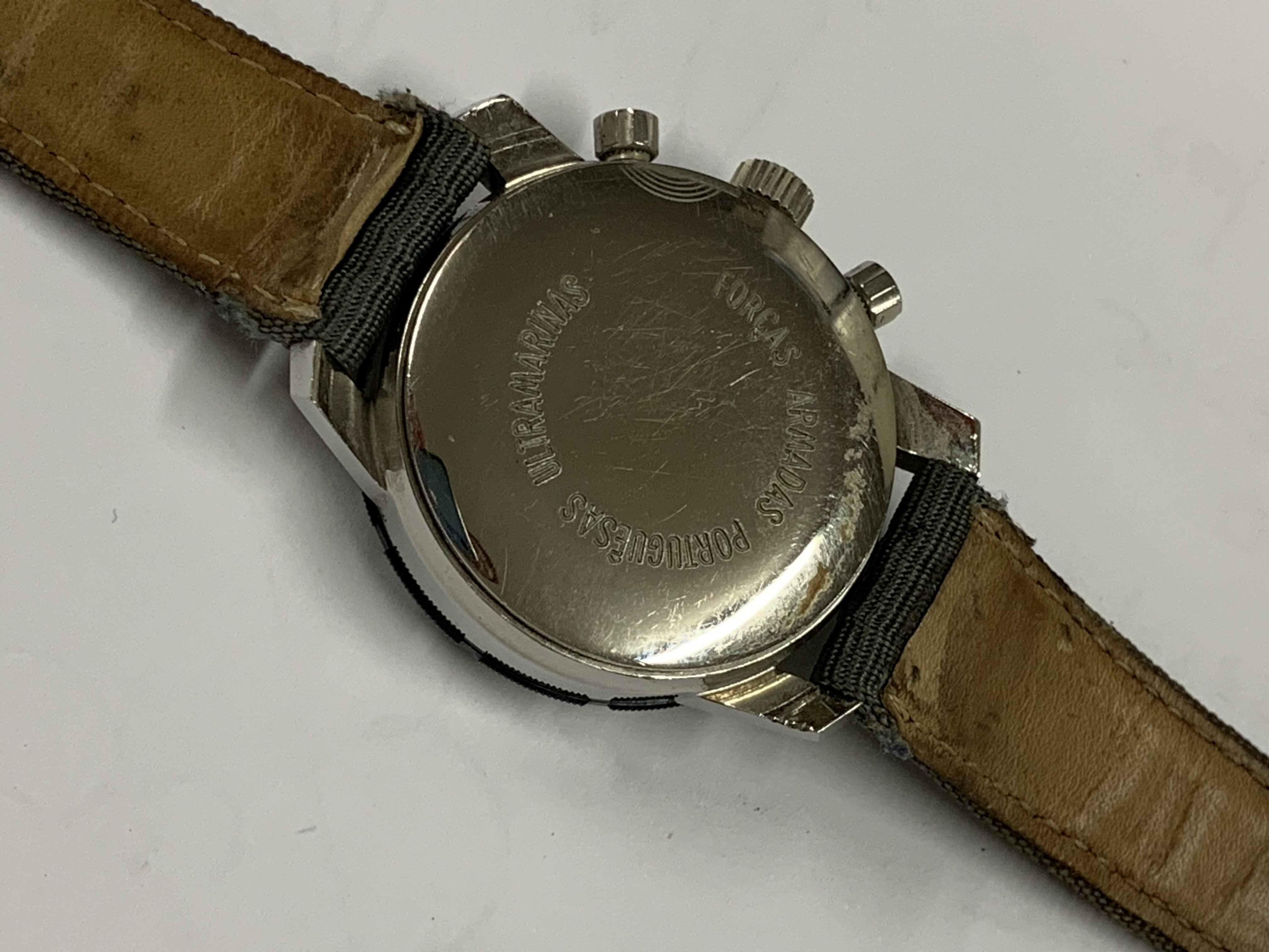

I thought that would be the hammer for the flyback... is it possible? I compared the movements online and it seemed correct but I’m far from being a watchmaker 👎

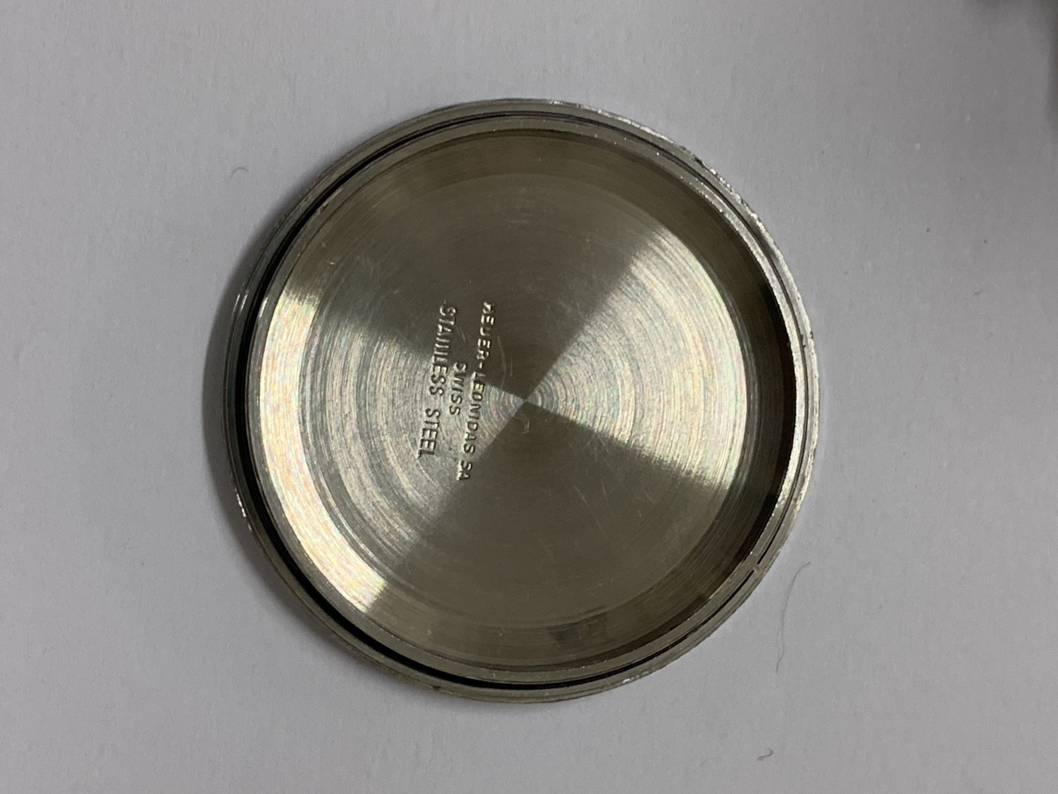

This type crop up on the rare occasion but I don't believe it has been 'agreed' if they are legitimate of not. I think the consensus is they are not (guilty until proven innocent, in this case!) which is my feeling too. Is there a serial/model number on the top and bottom ends of the case?

Will check for that serial once I’ve got it in my hands. I am aware of the discussion on this ones. The only one I could see was the one on the link above. I’m no heuer expert but even knowing the lack of consensus I’ve been chasing for one of these for more than 2 years now. Call me crazy... but aren’t we all? 😁
