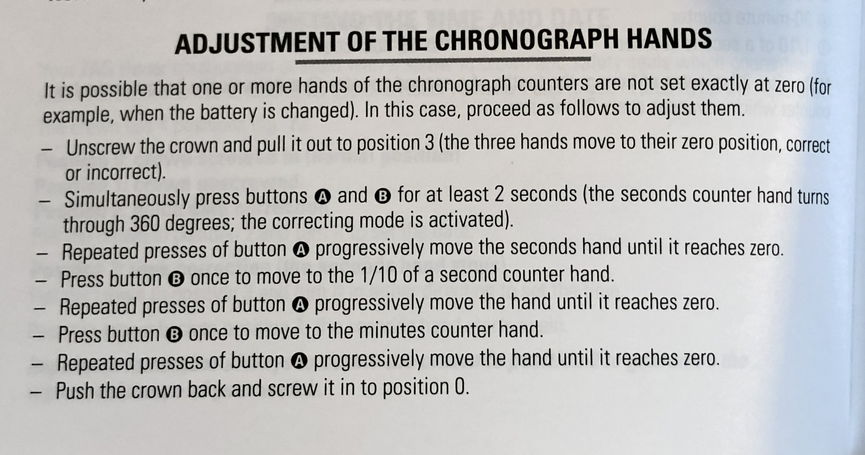

P Posts 3 Likes 1 Paddyl180 ·Jun 16, 2023 I have an issue with the watch that the stopwatch will not zero. The second hand stops on 54 seconds. Can someone please advise the issue. Thanks
Posts 10,062 Likes 12,880 Jim Dollares ·Jun 16, 2023 I believe this will help you https://www.watchuseek.com/threads/tag-formula-1-chronograph-reset.836079/
Posts 5,699 Likes 15,044 Albert-AMG ·Jun 17, 2023 P Paddyl180 I have an issue with the watch that the stopwatch will not zero. The second hand stops on 54 seconds. Can someone please advise the issue. Thanks Hi! Do you have the owner’s manual of your watch?
Posts 5,699 Likes 15,044 Albert-AMG ·Jun 17, 2023 P Paddyl180 Not sure. Will have to search for it Because in the owner’s manual you can find how to fix that:
P Posts 3 Likes 1 Paddyl180 ·Jun 17, 2023 I found the manual. However it didn’t have the information that you have provided. Thank you very much problem resolved.
