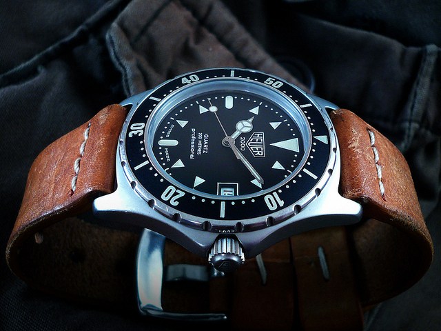

    Hello, Bought my Heuer 2000 (973.006) in Sydney in 1985, and it’s been the most brilliant watch.
    Around 15 years ago, during service, the crown was replaced with a TAG Heuer version.
    Didn’t think too much about it at the time, but is annoying me now.
    Have spotted NOS Heuer crowns on eBay, but want make sure I buy the right type (Tag Heuer can’t supply one).
    Can anyone help on the spec, diameter, push-in (or not), etc. As well as the best place to buy.
    Many thanks.

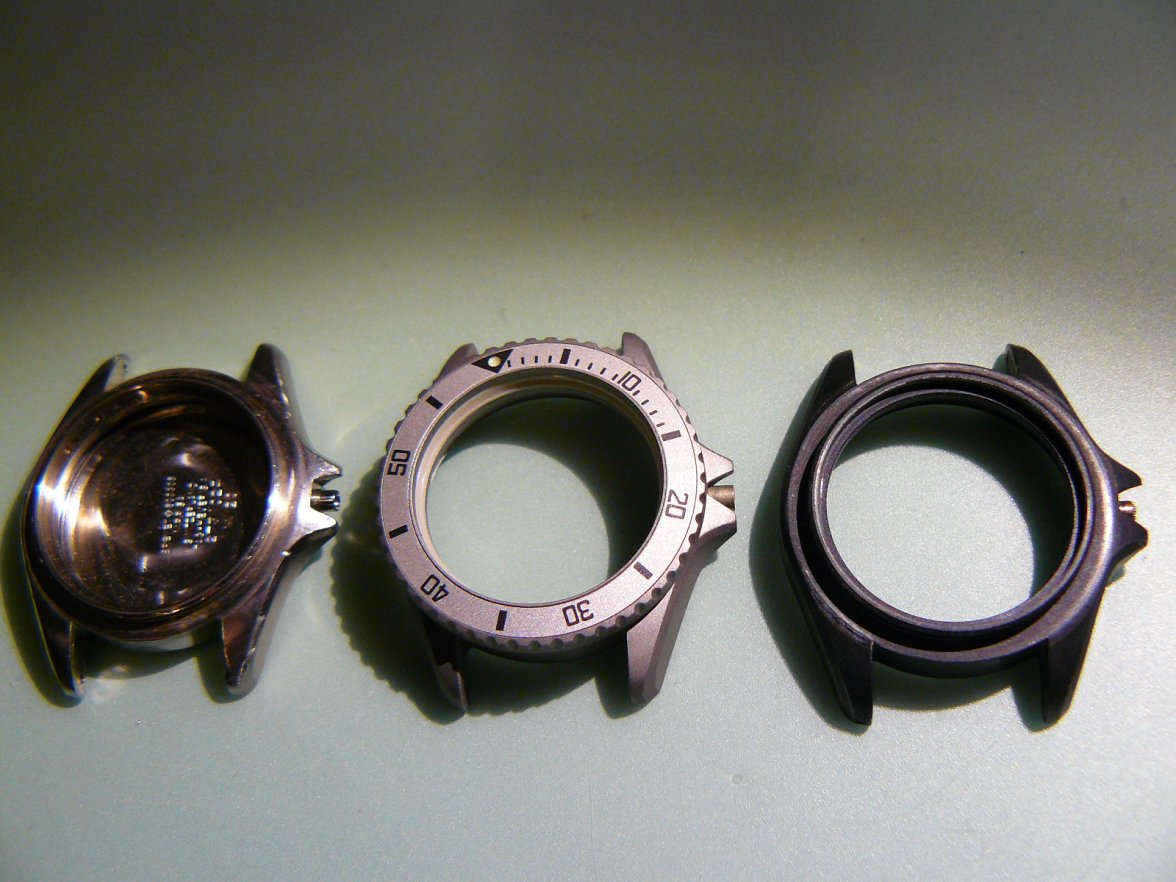

  7. automobilia42
    automobilia42 May 10, 2016
    375
    220
    Here is a picture I just made of the 3 different sorts of crown tubes, on the left, the TAG Heuer screw-in crown-tube, in the middle the Heuer screw-in crown tube with the wide diametre (has the crown with no logo on it), and on the right side the Heuer Banjo crown tube, with the teeth on the end.
    Jsprs likes this.
