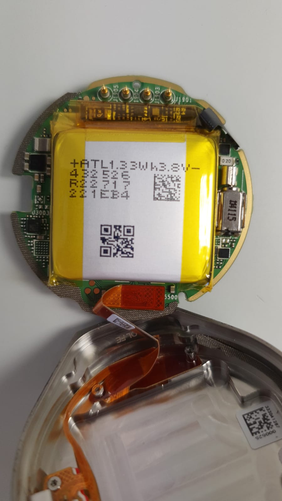

  7. Kevin Byrne
    Kevin Byrne Oct 9, 2021
    6
    Hi, I'm new to the forum. I have a 2018 connected modular 41. Battery is completely shot. I got fobbed off by Tag Heuer service in the matter.
    I have it now with an approved watchmaker who is an approved repairer and service agent for all high end watches -
    Problem is Battery seems impossible to get.
    This could be why Tag dismissed the issue.
    Would anyone know the source of the Battery in the 41 or if a compatible battery is available from another smartwatch manufacturer?

  9. neowatch
    neowatch Oct 9, 2021
    205
    204
    Wow I’ve been asking the same questions. The connected gen 1 battery is also impossible to find. However the gen 2 battery is relatively easy to find at least for the moment.

  11. Kevin Byrne
    6
    Thanks for the replies, I would like also to know how difficult swapping leads is?

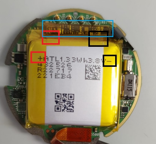

  12. Kevin Byrne
    6
  13. Kevin Byrne
    6
    Thank you very much. How difficult or easy is it to swap leads over?
  14. VRman
    VRman Oct 10, 2021
    80
    136
    If you can solder this should be straight forward if not have someone do it for you.
    The battery has 2 tabs and are +/- marked that are soldered to the PCM(Power Control Module) Blue box above.
    This PCM has replace the PCM on the new battery so you have the right main board connector and any logic TH added to this PCM will be maintained.
    qbquixote, Albert-AMG and neowatch like this.
  15. Kevin Byrne
    Kevin Byrne Oct 10, 2021
    6
    VRman, thank you very much. This is greatly appreciated.
