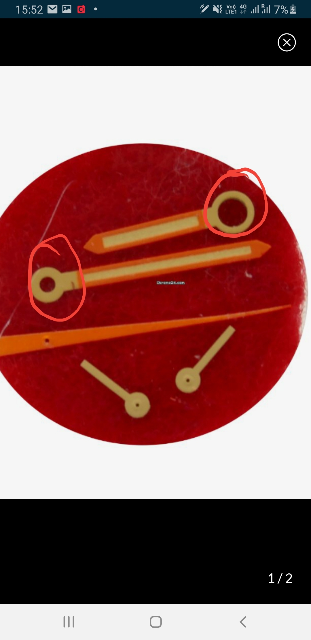

  3. Sam881
    Sam881 Nov 14, 2020
    18
    Thanks Steve! I am based in Singapore but the Heuer Skipper I am getting is coming from Germany.
    Prefer not to repaint the current hands so that if I ever decide to sell or pass on the watch in future, the new owner will still have the flexibility of putting back the original hands if he/she wishes.
    Incidentally, I may have found a pair of new hands. But the areas around the hole have not been painted. Not sure if there is anyone good enough to do this right in Singapore though.

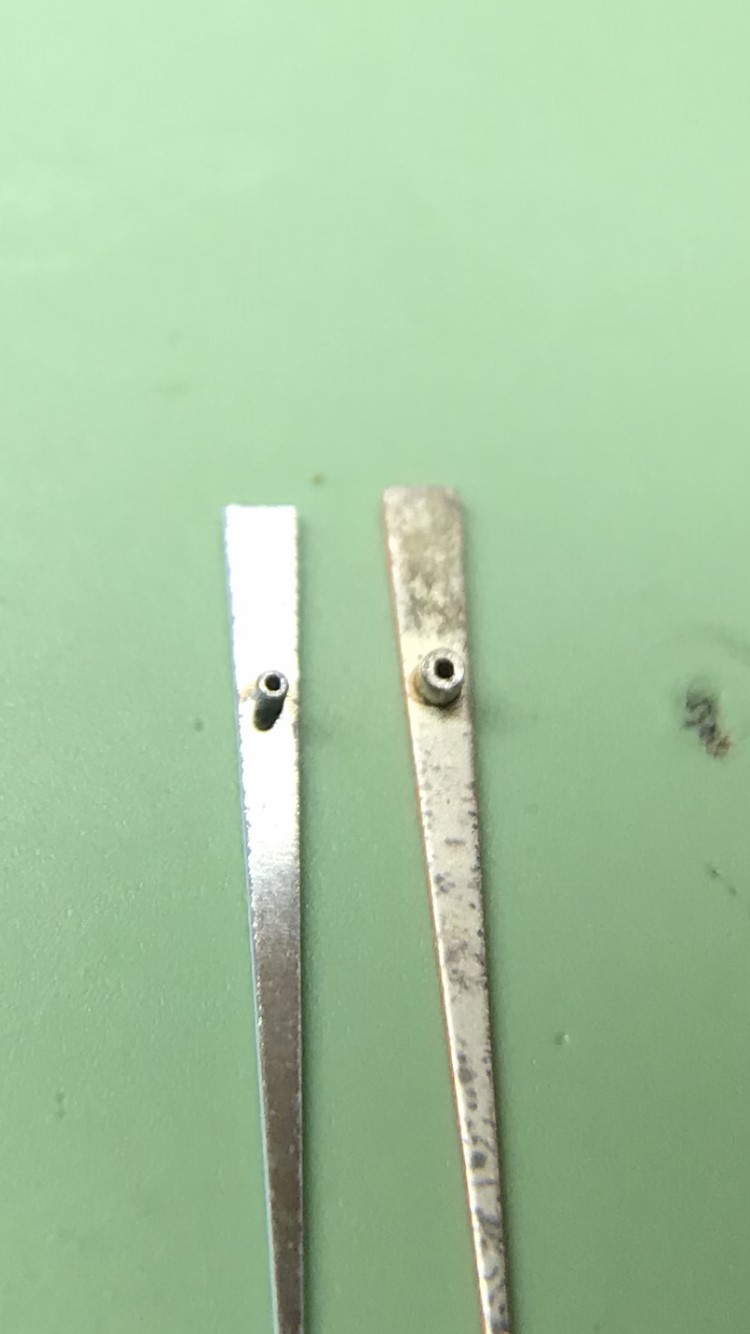

  4. SteveP
    SteveP Nov 16, 2020
    826
    1,540
    Hi Sam, be careful with these. I'm guessing they're from swiss watches and more-while they are described as NOS Heuer hands, sometimes they don't actually fit!
    Best, Steve

  7. SteveP
    SteveP Nov 16, 2020
    826
    1,540
    Below is a comparison of a sweep hand (that fits) and one from swiiss watches (which doesn't).
    That said, I have bought other things from him over time that were fine and as advertised.
