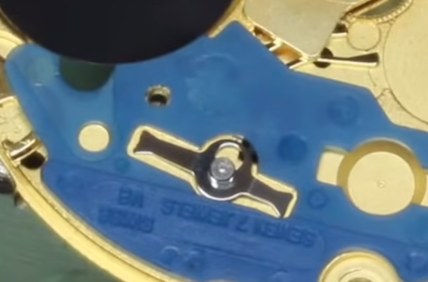

Removing the hands & dial may not be necessary (providing you have a movement holder or a way to prevent damage to them).
You should only need to remove the coil frame & primary circuit board. The retention spring & pushpin sits in the middle of the blue plastic bracket, and it may only be stuck under the edge of the circuit board or the spring may have slipped.
This quick disassembly will, at least, let you get a better a look at the issue.

Thanks for the info but I won't be doing that. Dropping it off tomorrow with someone who knows what they are doing.
